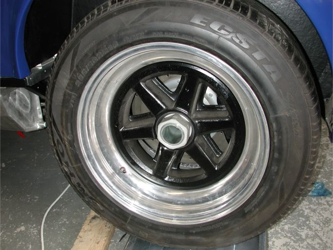

Weight saving features might be the 16" magnesium wheels and using the Renault box (with Quaife internals) instead of a heavier ZF or G50.

... wheels? You mean these things? I wondered what they were!!
