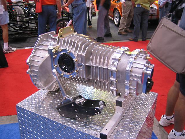

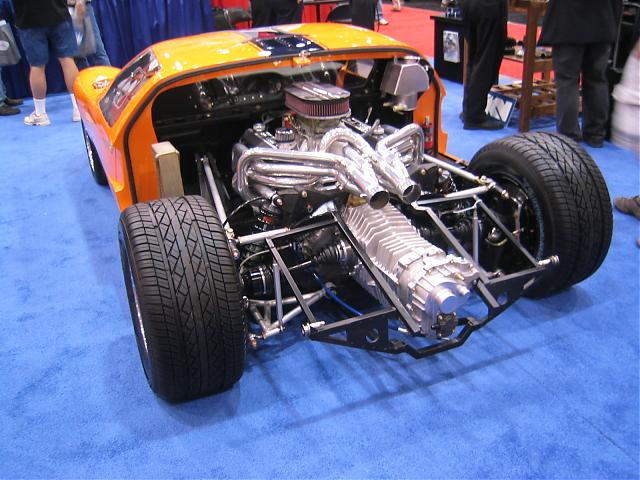

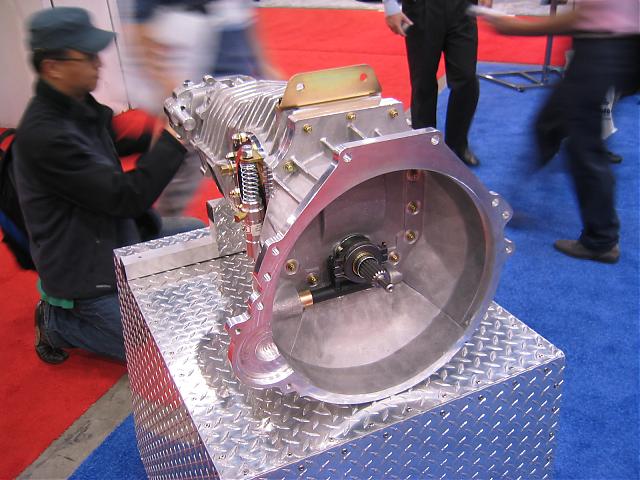

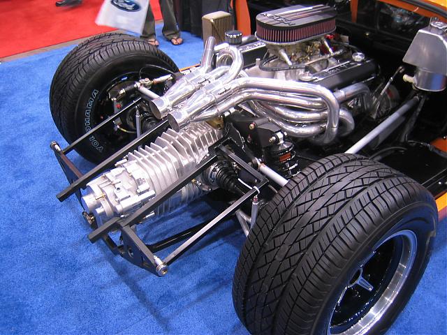

Here's a few pics from SEMA....

They've been working on that box for a long time.
they couldn't tell anything on prices yet, did that change after Sema?
grtz Thomas
I was told they will have two versions available. The cheaper would be roughly $11K. The other would be around $13K and with the extra cost you get better synchro's, a slightly different ring/pinion, and better gear set. Both final drives would be 4.11 At least that's what the salesman told me. I hope I got that right.
