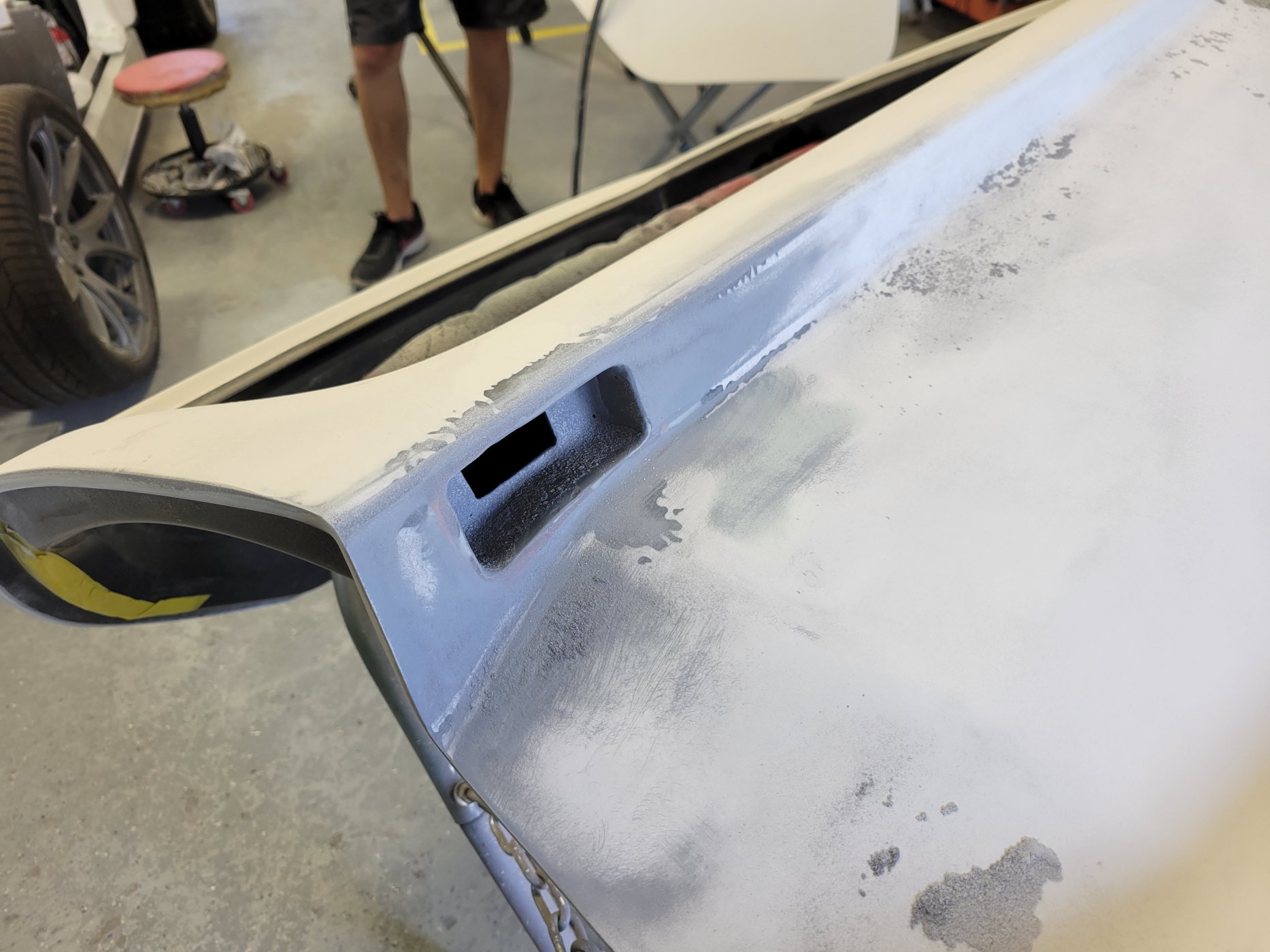

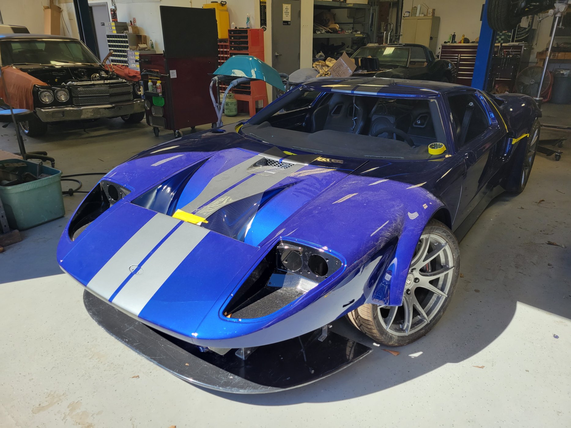

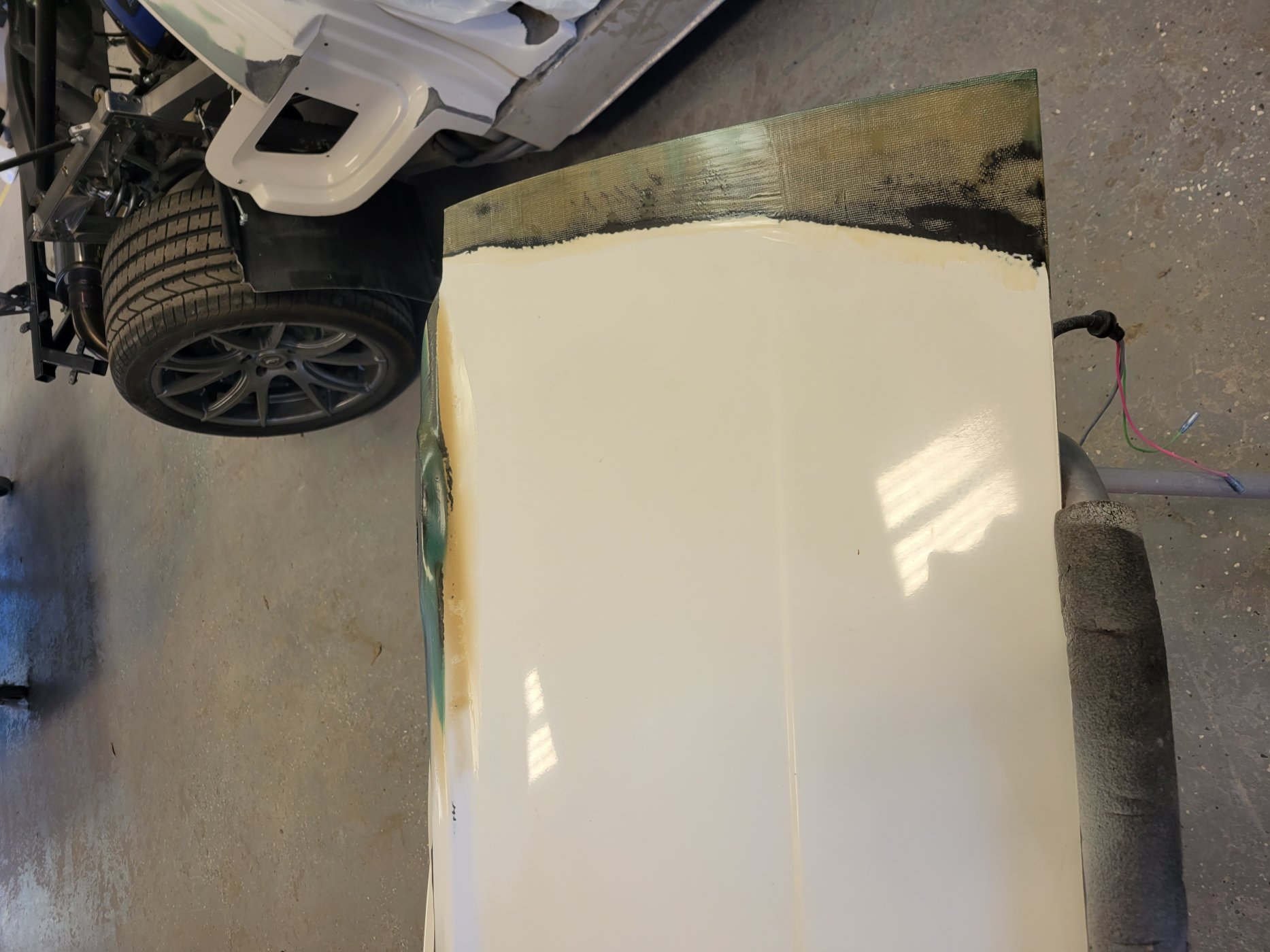

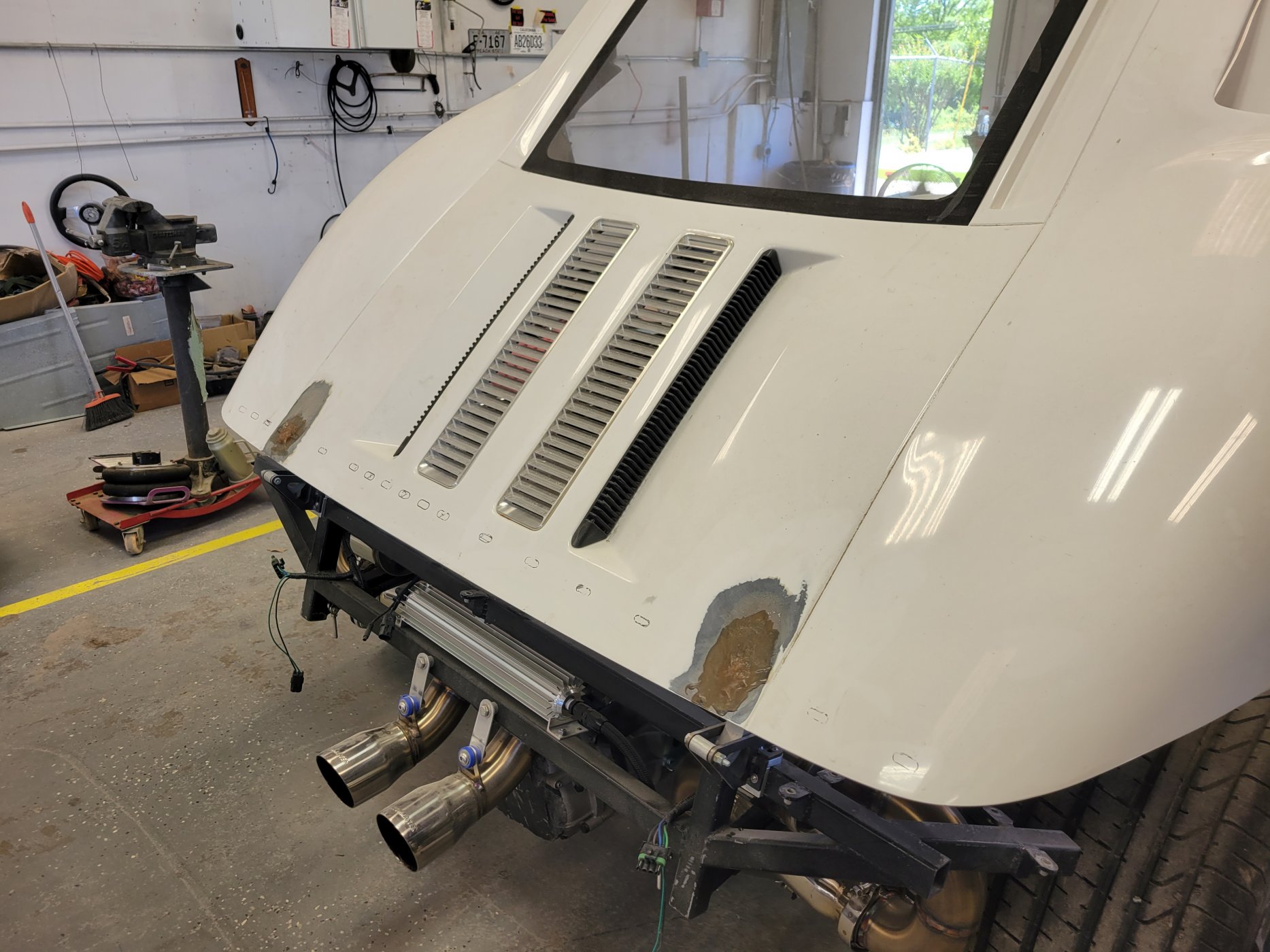

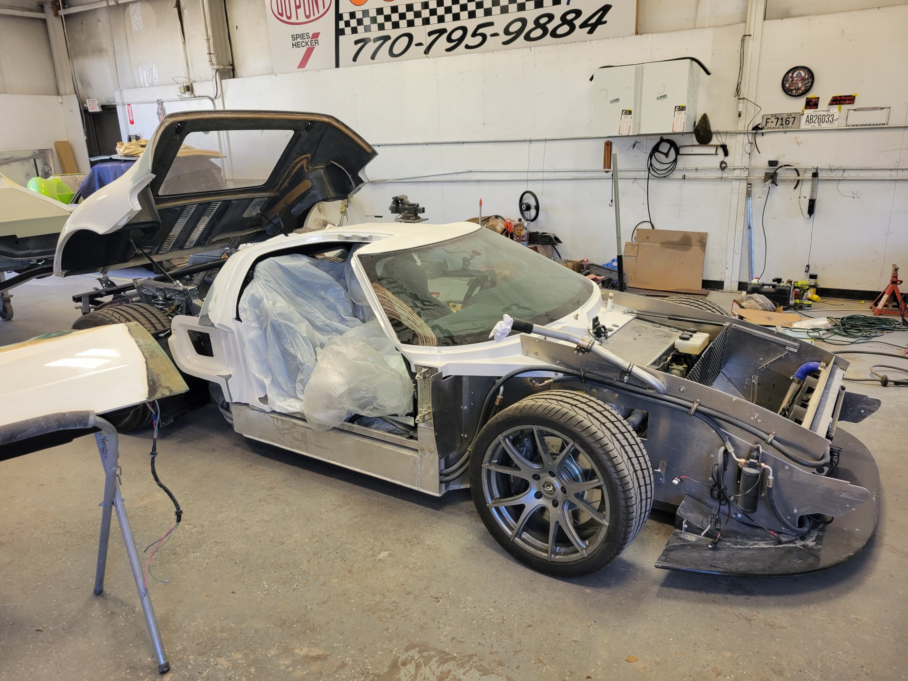

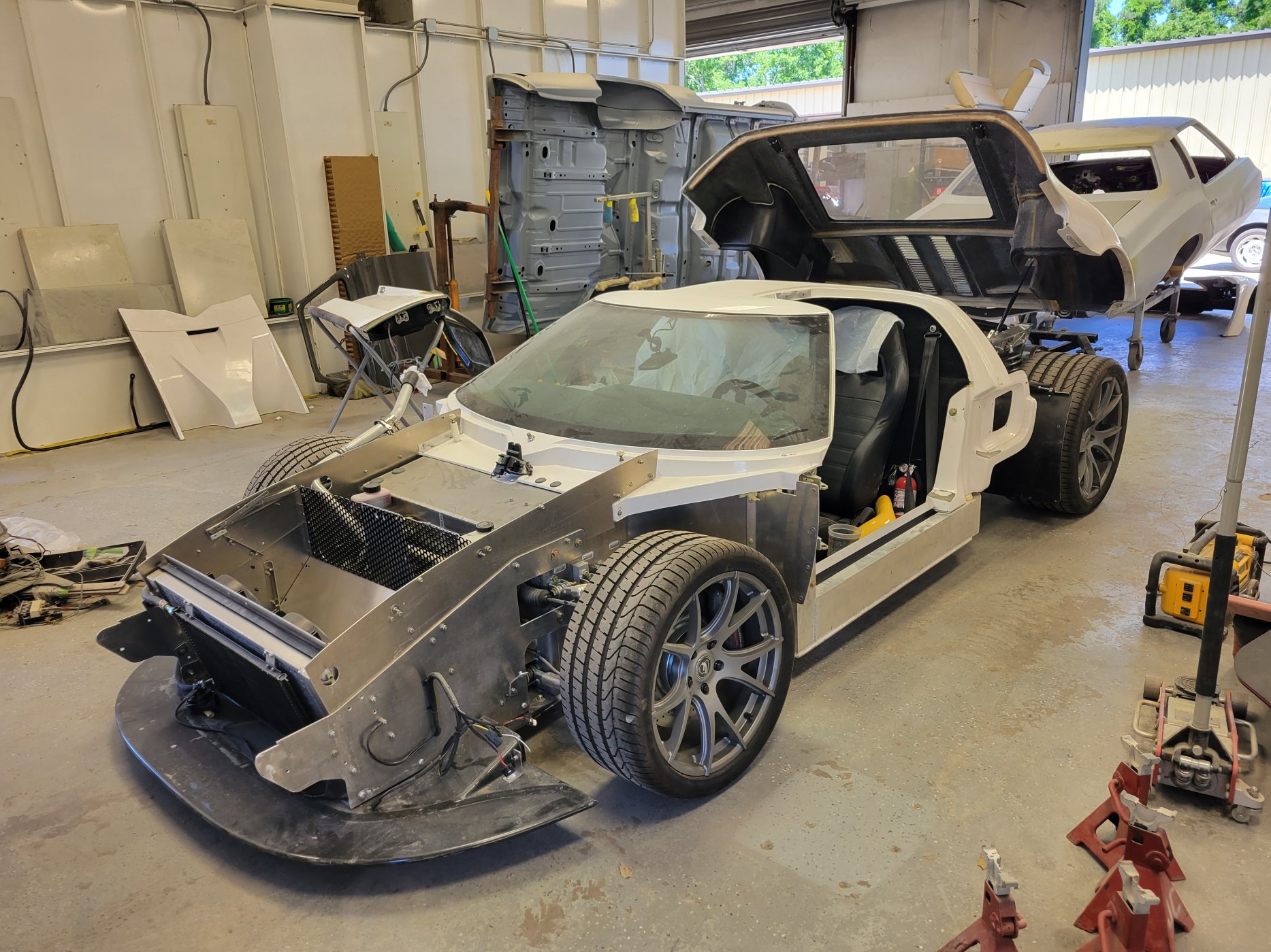

Dang. It's been so long since I've posted that I couldn't find my thread! My car has been at the body shop for about 3 months now and is moving along nicely. I couldn't find a local reputable shop that had less than a six-month backlog, so here we are! Last time I was there, they were moving along. Here are a couple of photos, and a link to a YouTube intro video I made just before I drove it over to the shop. The shop is Blalock Customs in Marietta GA.

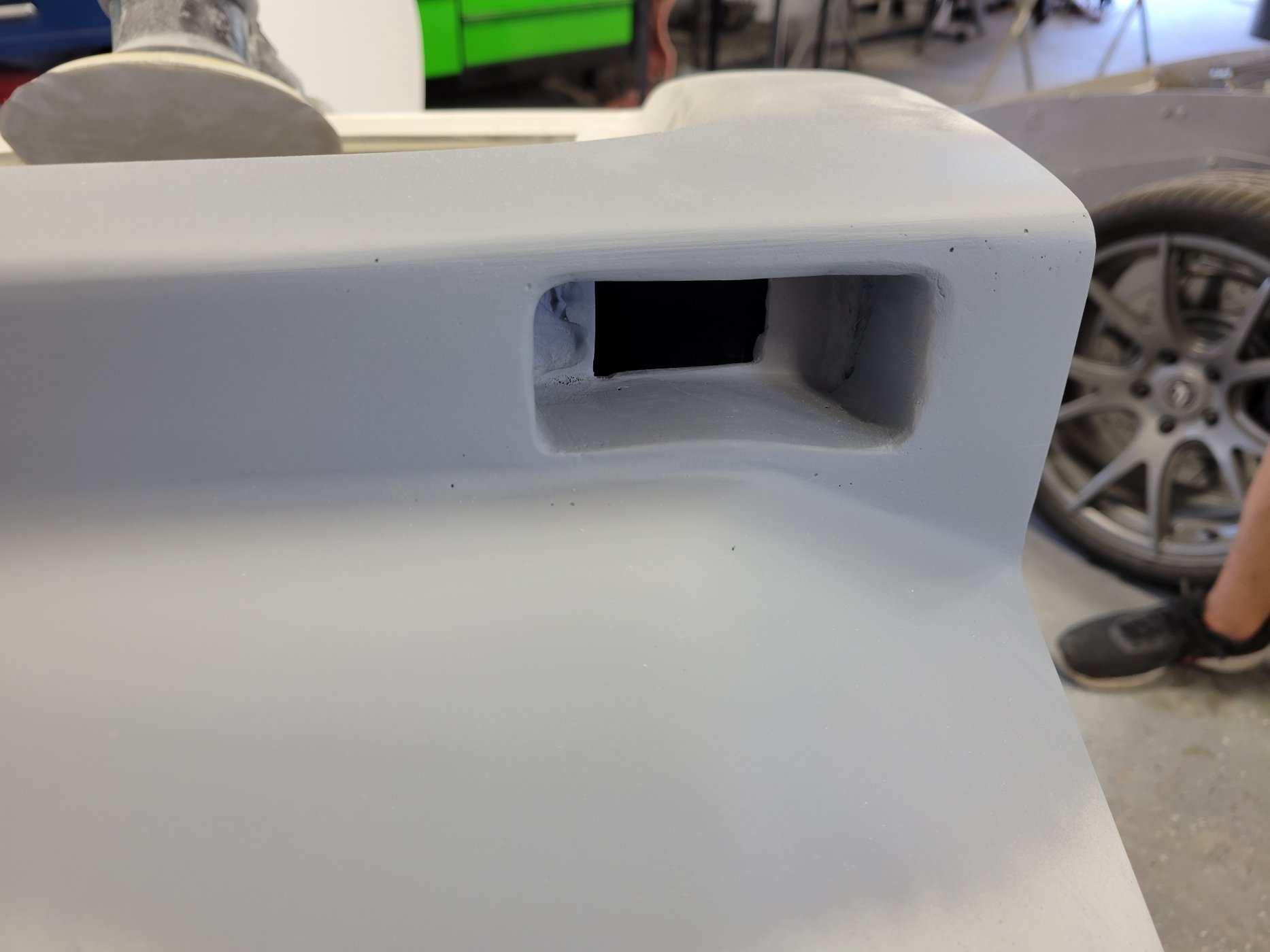

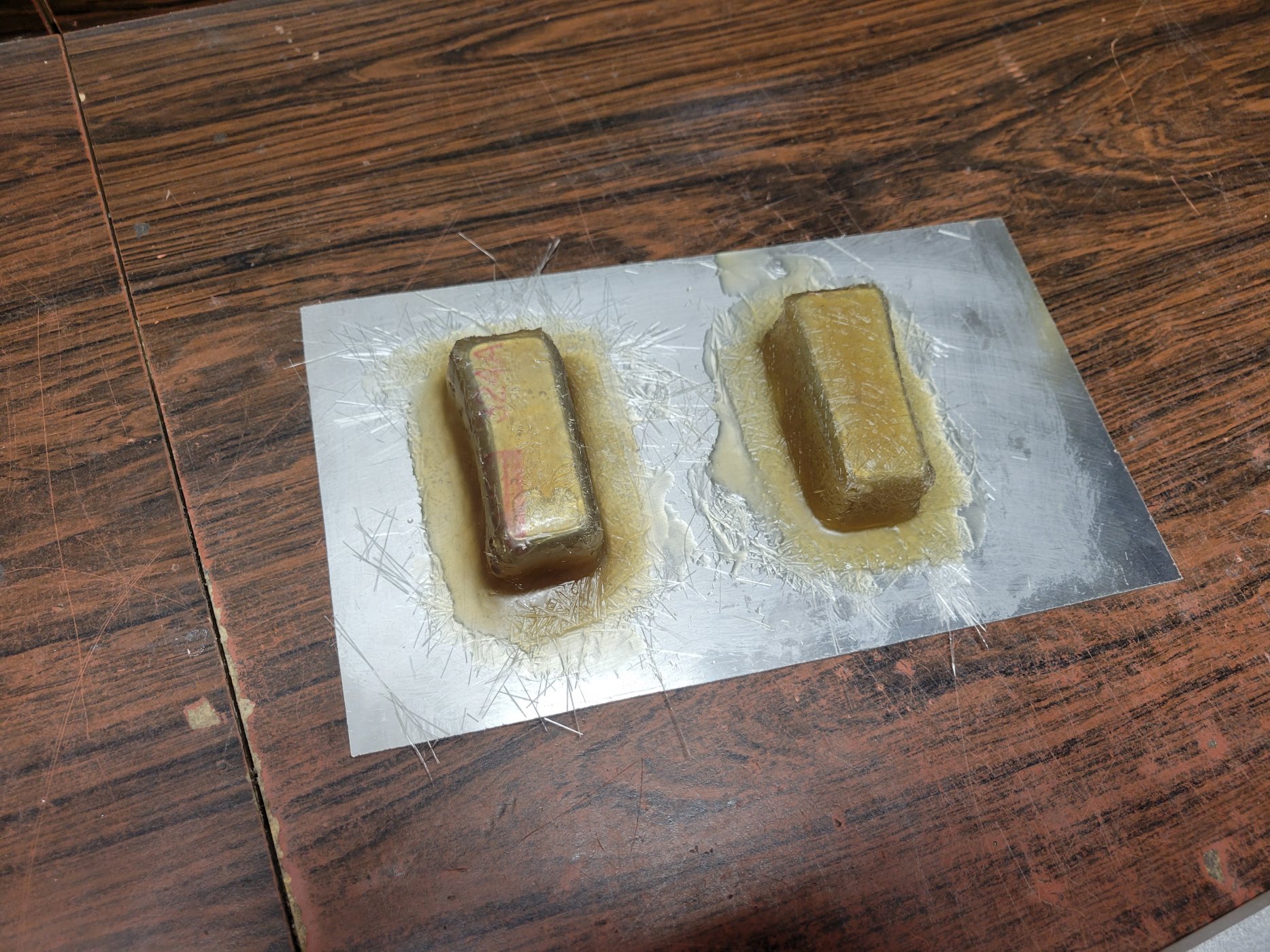

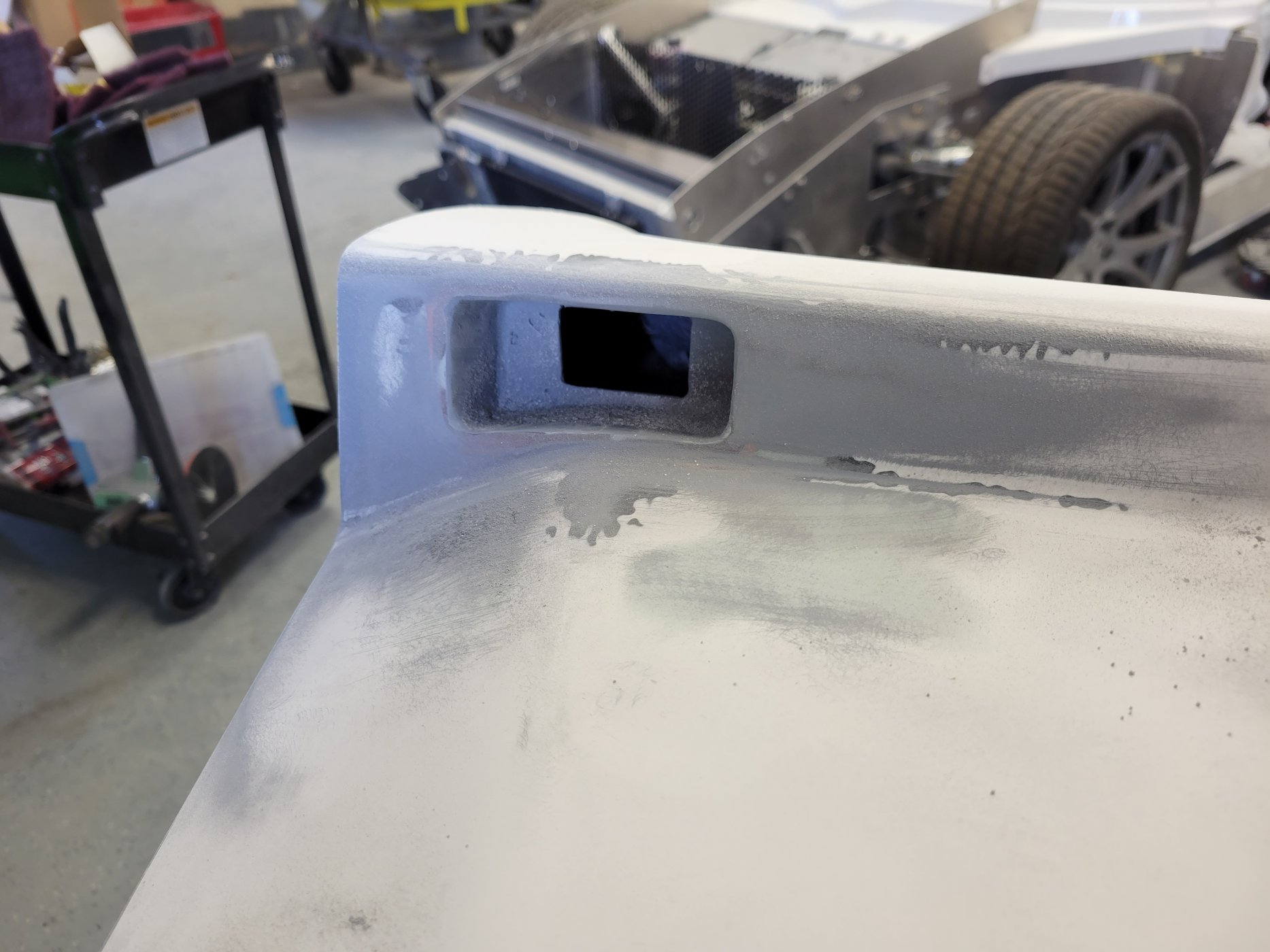

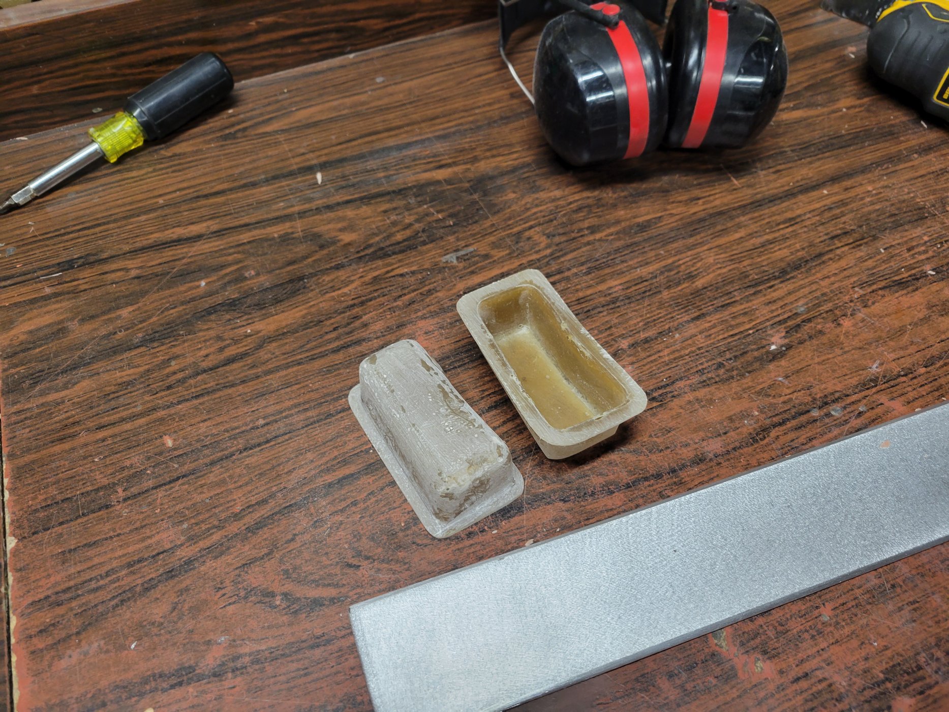

Fiberglass exterior door handle recesses. I am putting in the pushbutton door releases. As with Kurtiss, am using solenoid actuators (Electric-Life P/N 99003) , and original style pushbuttons (Dorman P/N 901-209). The switches barely fit in the recess, which barely fit on the door. The switches I believe are original style (and were for period Ford Taurus, Expedition, etc. rear trunk/hatch release). I'll get a photo of them installed when that happens.

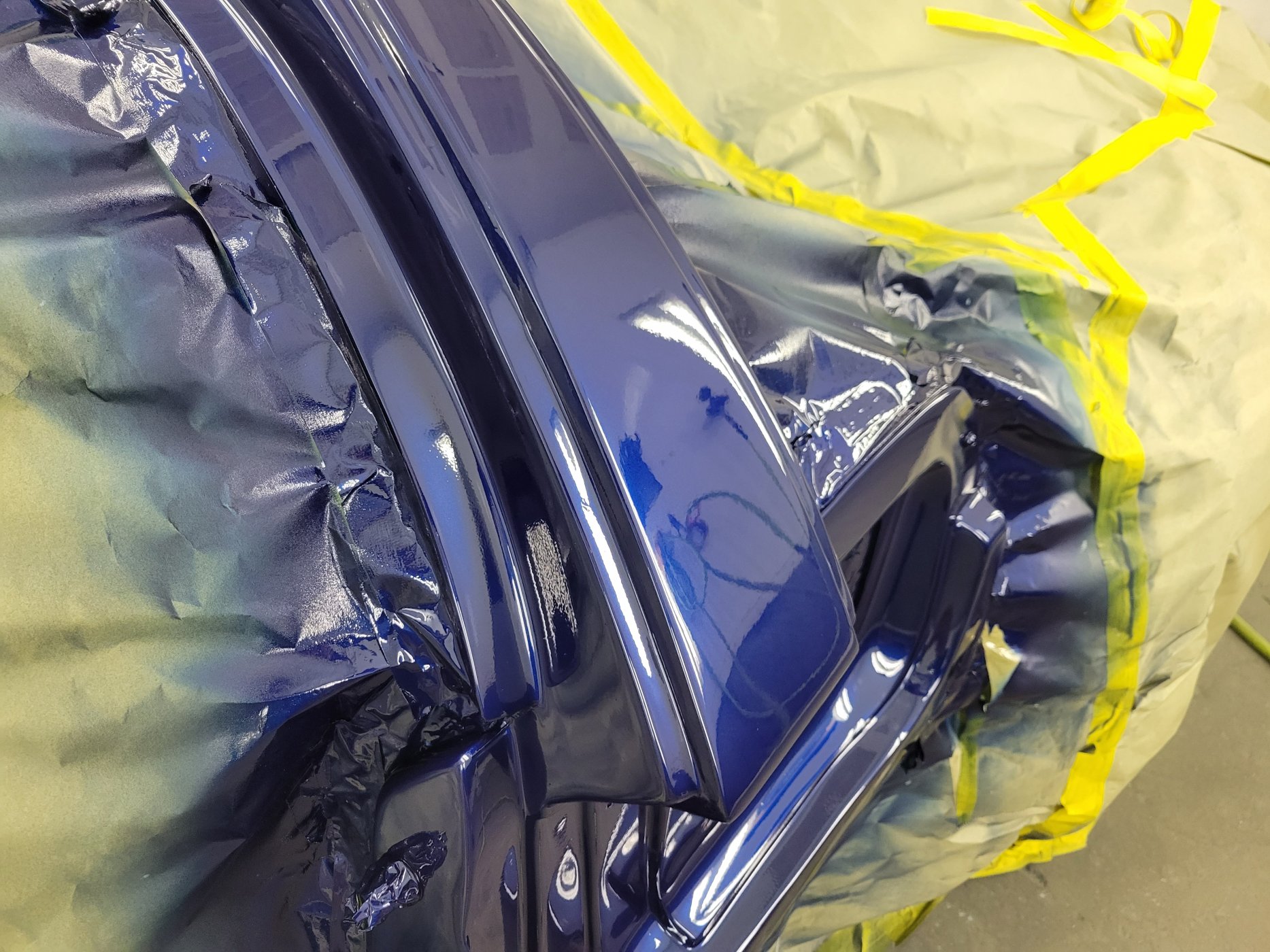

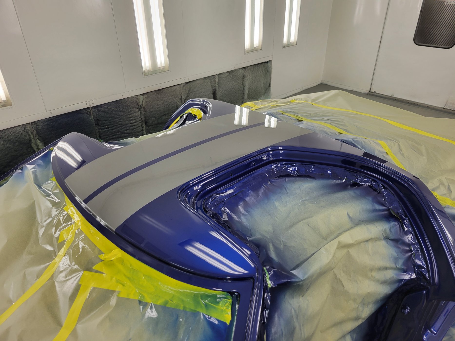

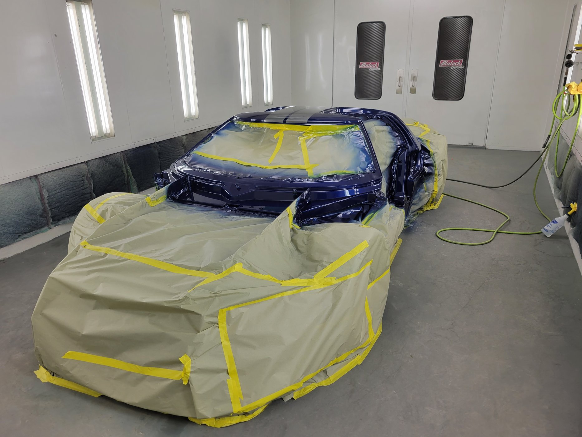

It has been excruciating waiting on completion of the paint. Every week, it is a little farther along, but I never imagined it would be 8 months later and no car. The shop is working on it, and I can't complain, as they are doing a good job. I am trying hard to be very patient!
