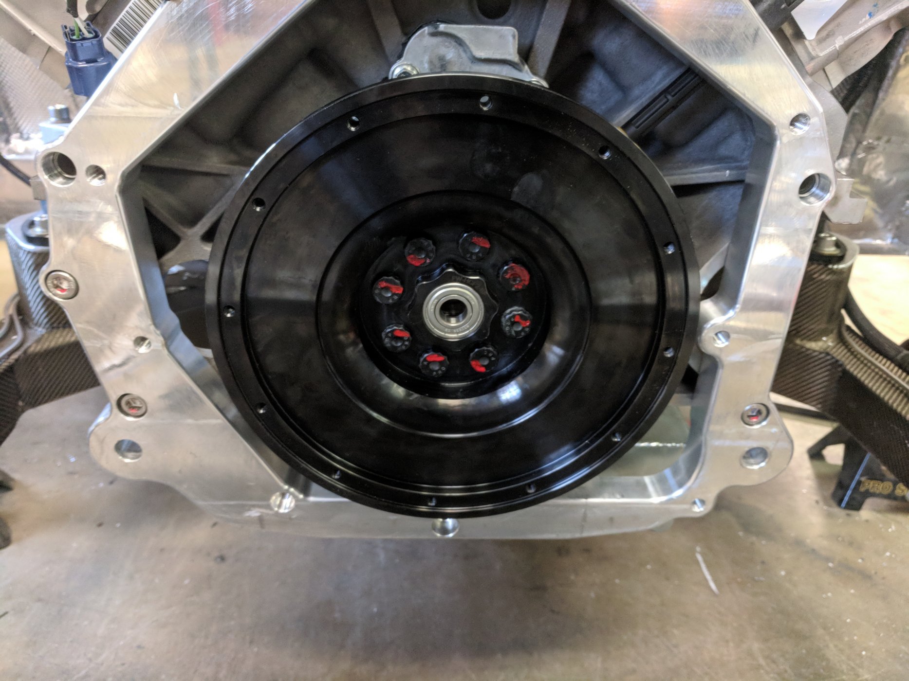

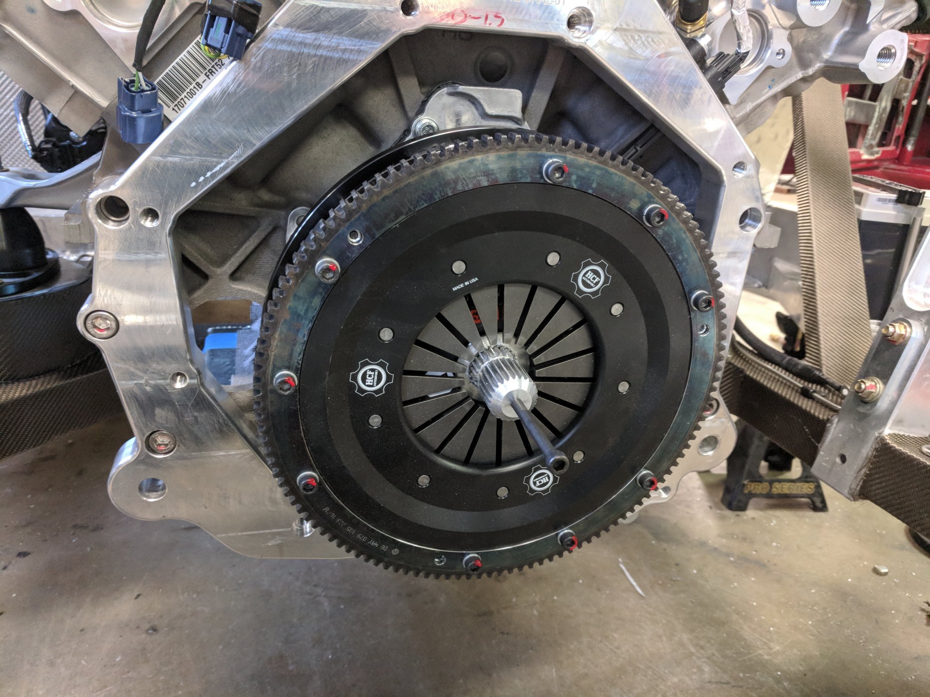

Congrats on the car!! Do yourself a huge favor and check out the clutch offerings from HCF Autosport for the L140.

HI Steve - must have missed your response. Sorry for the delay. Yes, I purchased my clutch and flywheel from HCF (HCF Parts - Ferrari, Gears, Transmissions (hcfautoparts.com) ) John is a great guy, and even gave me a list of the other parts and pieces required complete the setup (fittings, etc.). The starter is a common Audi/VW part, I believe. Try a part number SR0408X (Bosch). I got mine on Amazon.

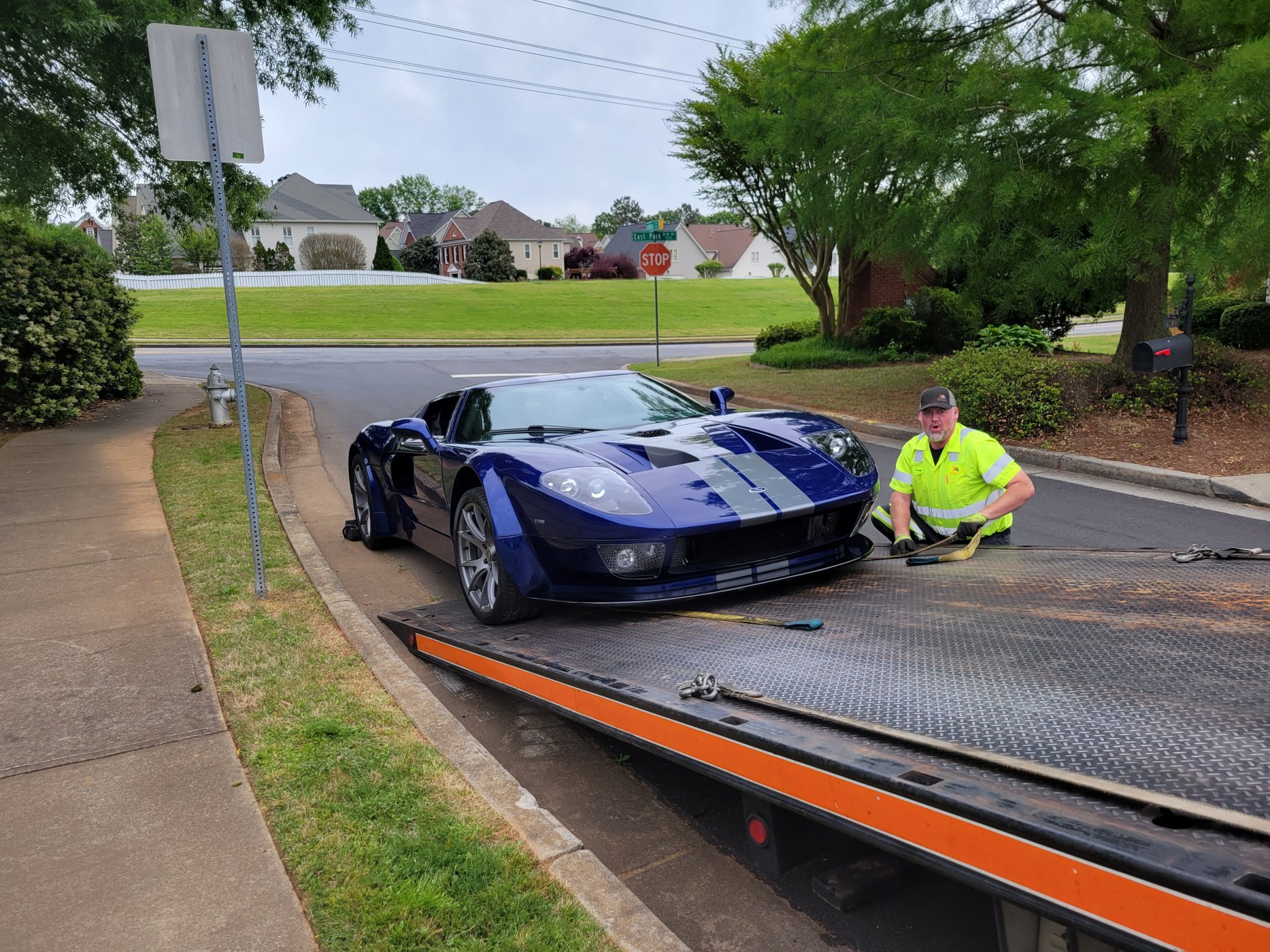

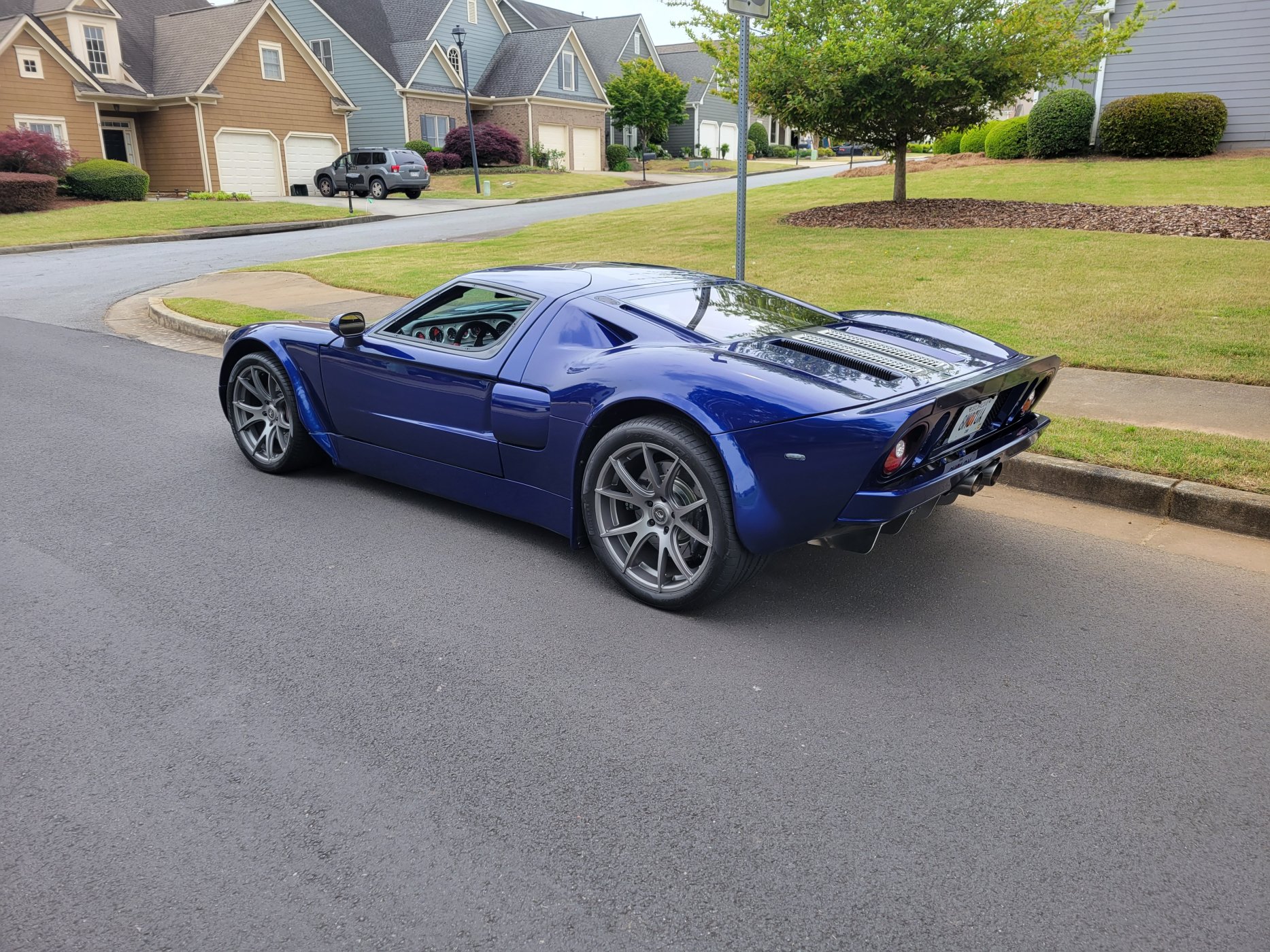

Here's a nice photo of my car just before the wrecker picked it up after I ran out of gas! :) At the time, I thought something was wrong, so I didn't think to just put more gas in it! The fuel tank sending unit is good for a general idea, apparently! I actually got all the way to removing the fuel pump from the tank before I realized the tank was bone dry!

Don't feel bad... on a cross-country drive back in 1969, i was approaching Denver and watching my gas gauge for its red warning light to come on, indicating that it was on "reserve". As i got just inside the city, the car sputtered to a halt on the side of the road. "What the...?" Can't be out of gas, the reserve warning light never came on. I took off my green sun glasses and there was the red warning light staring me in the face! That's when I switched to neutral density sun glasses. (Fortunately a gas station was close by)

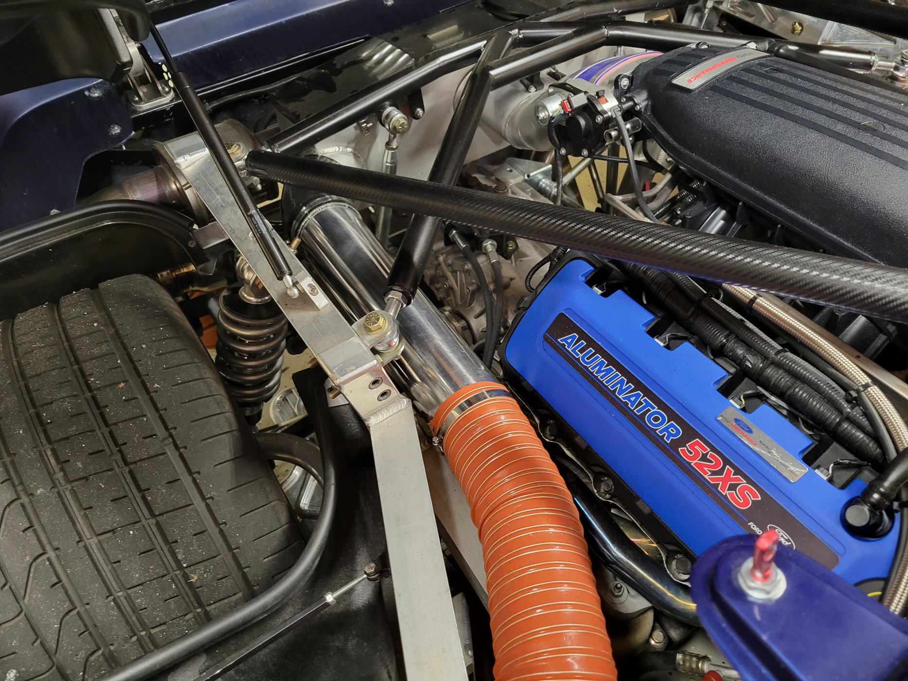

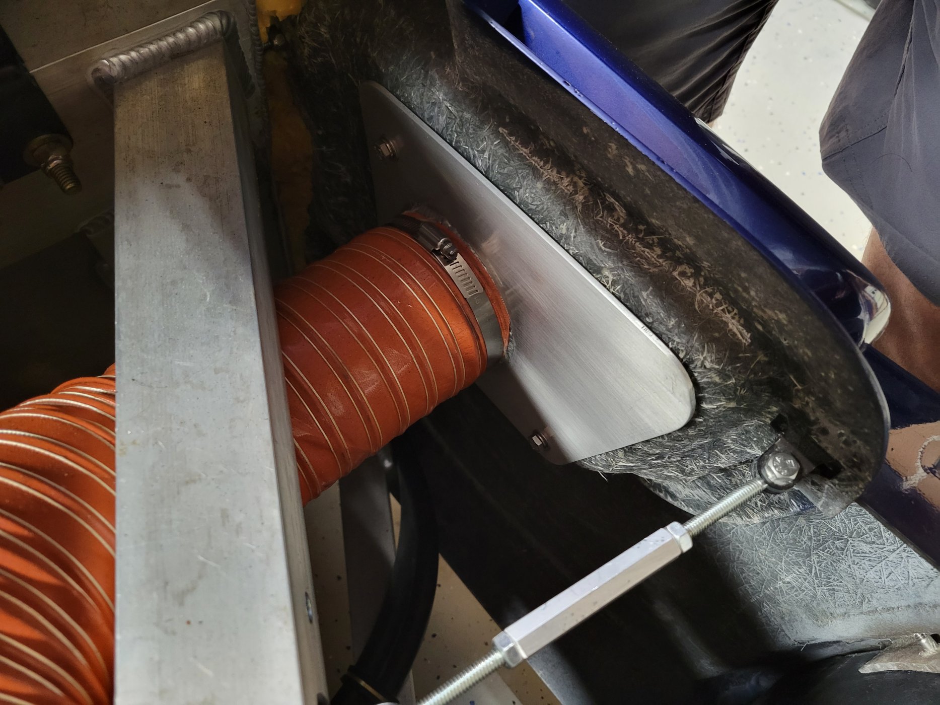

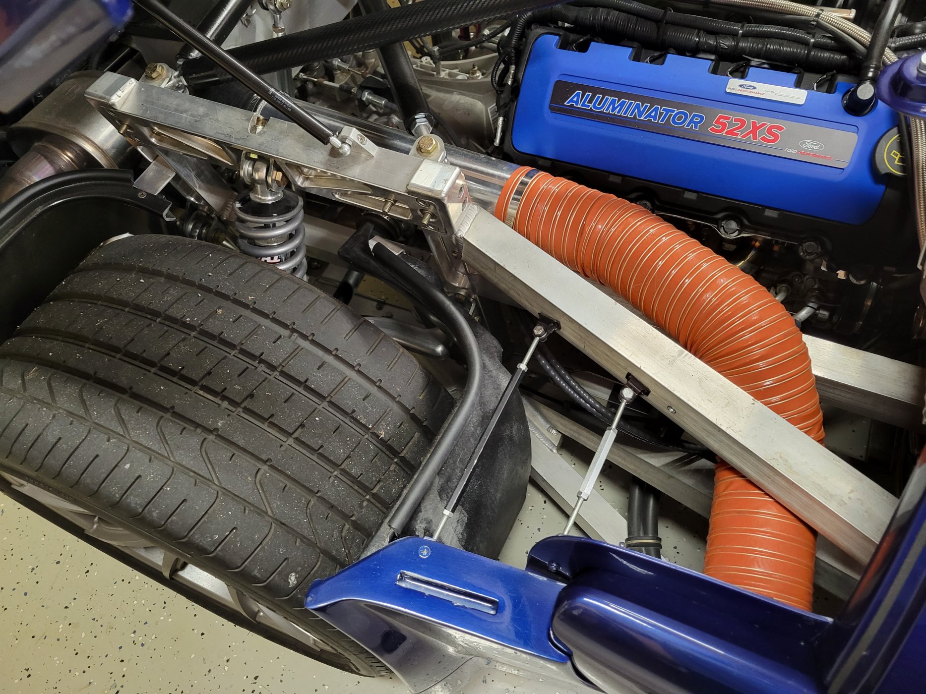

Still working on final tweaks and finishing touches... I plumbed up my air box to the side scoops. It would have been a real nightmare to try to connect them to the upper rear clamshell vents. The tubing is 4" polished 6061, 1/16" wall thickness. I welded a bracket on it that attaches to the upright. Then silicone elbows and air ducting to complete the circuit. I cut 1/8" aluminum sheet to fit over the vent holes, using the same bolt holes that mount the scoop on, then welded a couple of inches of 4" tubing to the plates for the tubing to connect to. It is amazing how different the car sounds from inside while the engine is sucking in all that air right next to my ear!

Excellent job with the ductwork.
Very clean and professional looking.
I have my kit on order and will be using the Aluminator 52XS also. (many months away)
One question, did you order the Graz completion kit from Superlite, meaning the clutch, flywheel hyd throwout bearing etc.
Or possibly did you choose all the components based on advice given by Ron McCall when you had the drop gears installed?

I purchased my clutch and flywheel from HCF (HCF Parts - Ferrari, Gears, Transmissions (hcfautoparts.com) ) John is a great guy, and even gave me a list of the other parts and pieces required complete the setup (fittings, etc.). I can't remember all the reasoning behind the decision, but I am sure some of it was recommendation from Ron.

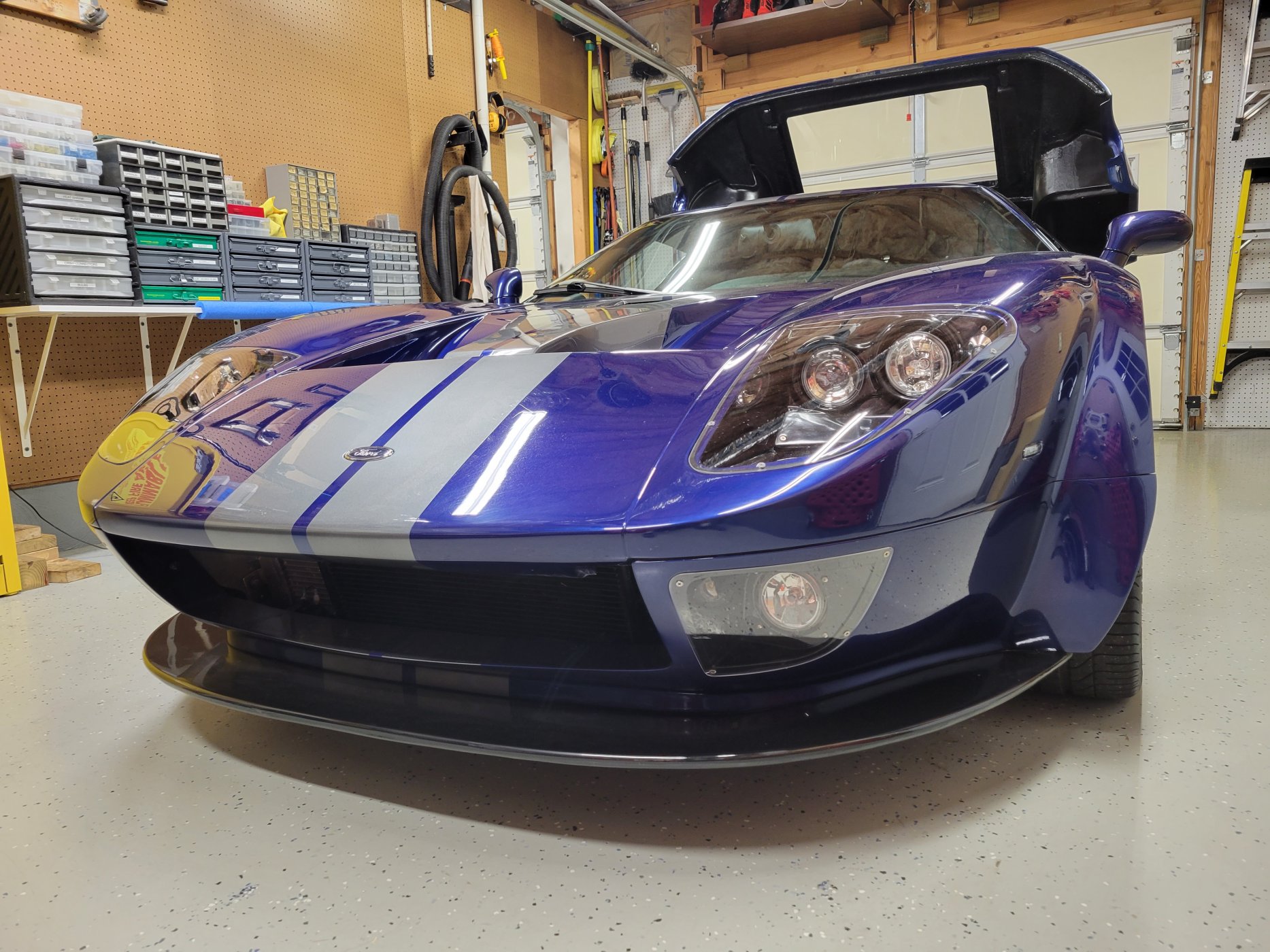

Nice work! It looks gorgeous
I like the way you handled the trimming of the front flairs.
The cut is more gradual than others, not as abrupt and blends nicely.
This is obvious from the last photo you posted, the front 3 quarter view.
I'm sure this was intentional, very nice
