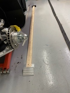

Yes it is a bit too low so I just ran a 2x4 with some ramp ends attached. The back piece is rubber and stops it from sliding.
