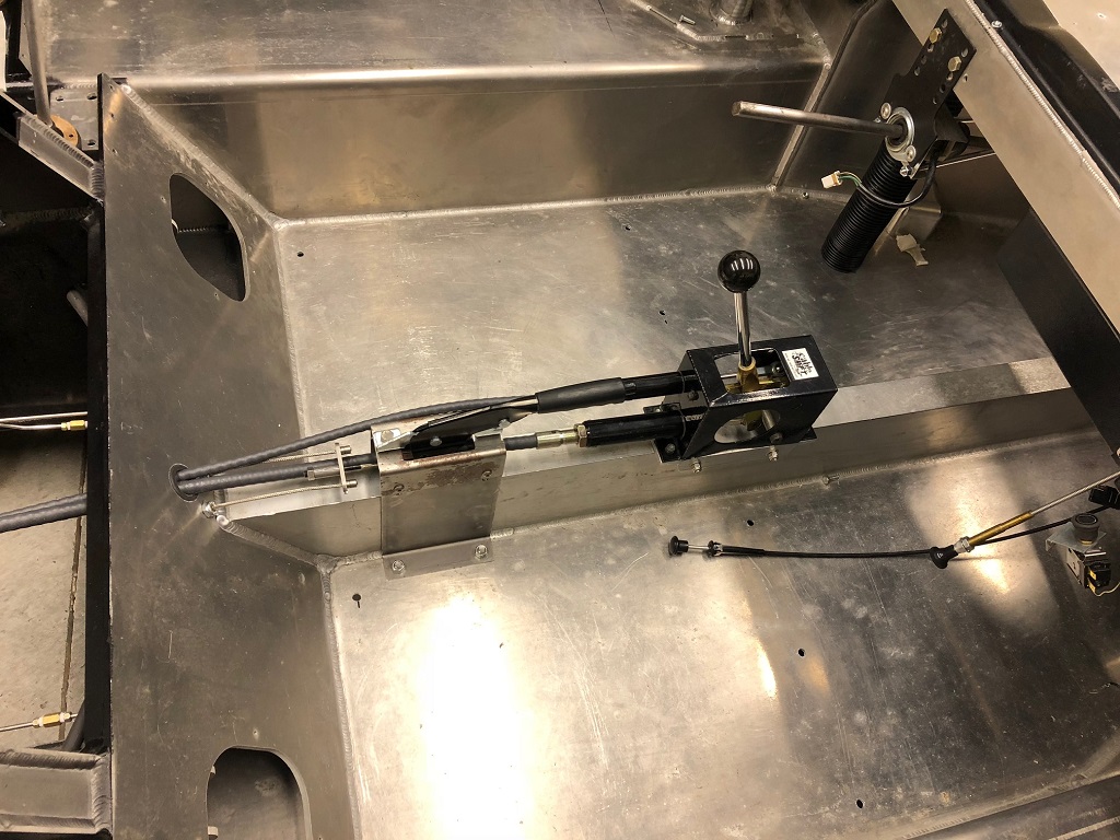

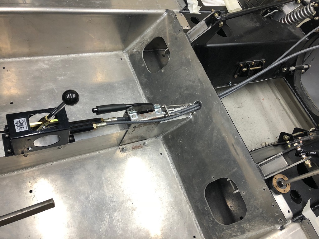

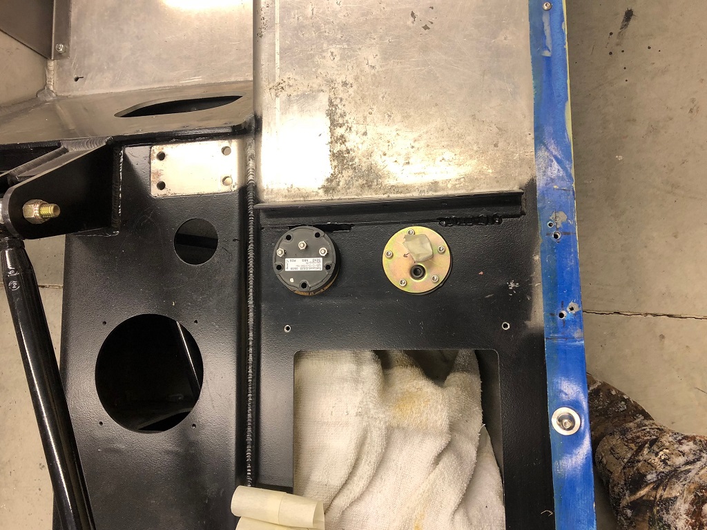

OK, time for an update. Shifter installed with fabricated mount and the holes drilled and cables ran. Sharp eyes might also note that the holes for the seats are drilled in the tub. Also, got the holes drilled in the fuel tank and the fuel pickup and fuel senders installed (or not quite yet on the driver side for the sender). This was the most fun, drill, file the edges, tap the bolt holes and all that and then try and clean up the inside of the tank. Not sure how everyone else did that. I used a piece of 5/8 heater hose that I duct taped to my vacuum (it was small enough to get into the holes), and vacuumed what I could and then used a flashlight and some paper towel on the end of a stick (with a rubber band) to "sweep" anything to where I could get it with the vacuum, or if it stuck to the paper towel to take it out.

I think that you will have to reroute your shift cables to the lower passenger side of the tunnel. As they are now I think that the bend in the cables would have to be very tight to avoid fouling with the harmonic balancer on the engine. With the cables lower they can run along the side of the oil pan without having to turn right and down rather quickly. Someone else may offer better input since My RCR40 is a right hand side drive/shift and my cables are in a completely different location.

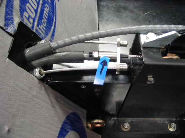

If it worked for them then is must be good. That is why I was hoping that others would chime in. I took your picture and added circles just above the seat belt anchors to show where I might have ran the shift cables (most likely one on each side of the tunnel) if I had a left hand shift car. I also will not be using the emergency brake (the bracket will be in the way for your car) since I like the line lock solution (I did this on my GTD GT40 in 1995, it worked great and saved weight).

Thanks for providing that pic, Rick. My interior shots are limited so I'll use yours to help visualize things.
My cables pass through the same location as Mitch's, except they both run inside that emergency brake mounting bracket (not on the outside), then they criss-cross and make a sharp bend outwards and down towards the sponsons. See attached pic...
The reason is the engine damper is almost centered behind that pass-thru (in my case) so you have to clear it immediately then guide the cable down (using Adel clamps) and along the bottom edge (under the motor mounts), then around the rear wishbone, and out and around to the transaxle shift cable adaptors. Hope the cable routing drawing helps. It would be much easier if you had the engine/transaxle mounted so you can route the cable accordingly. As they say, "your mileage may vary", depending on engine/transaxle used.
FWIW, I use a ZF Transaxle so cables are routed on both sides.

Rick and Tom,
Thanks both of you for the information and the visuals, it helps out. I will certainly have to work on the routing when I get the engine in. I guess for now, I will leave things as they are and see how the routing turns out, knowing that I might have to adjust downwards at sometime.

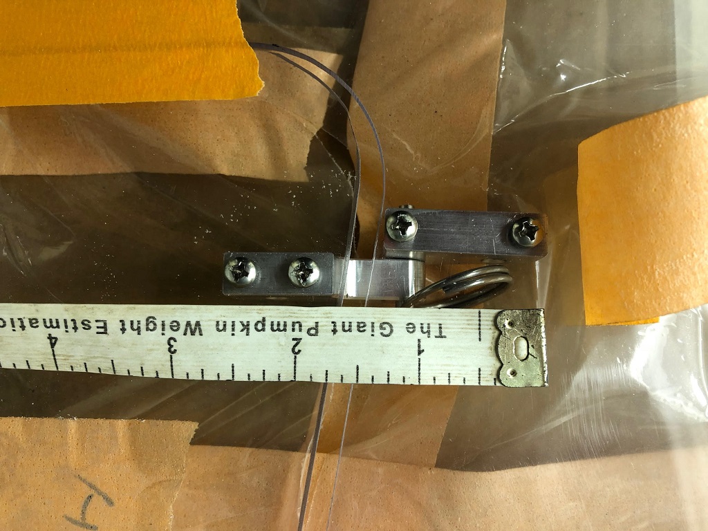

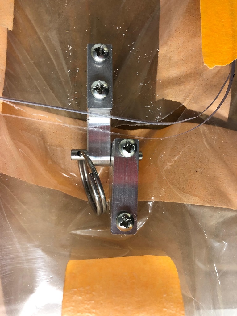

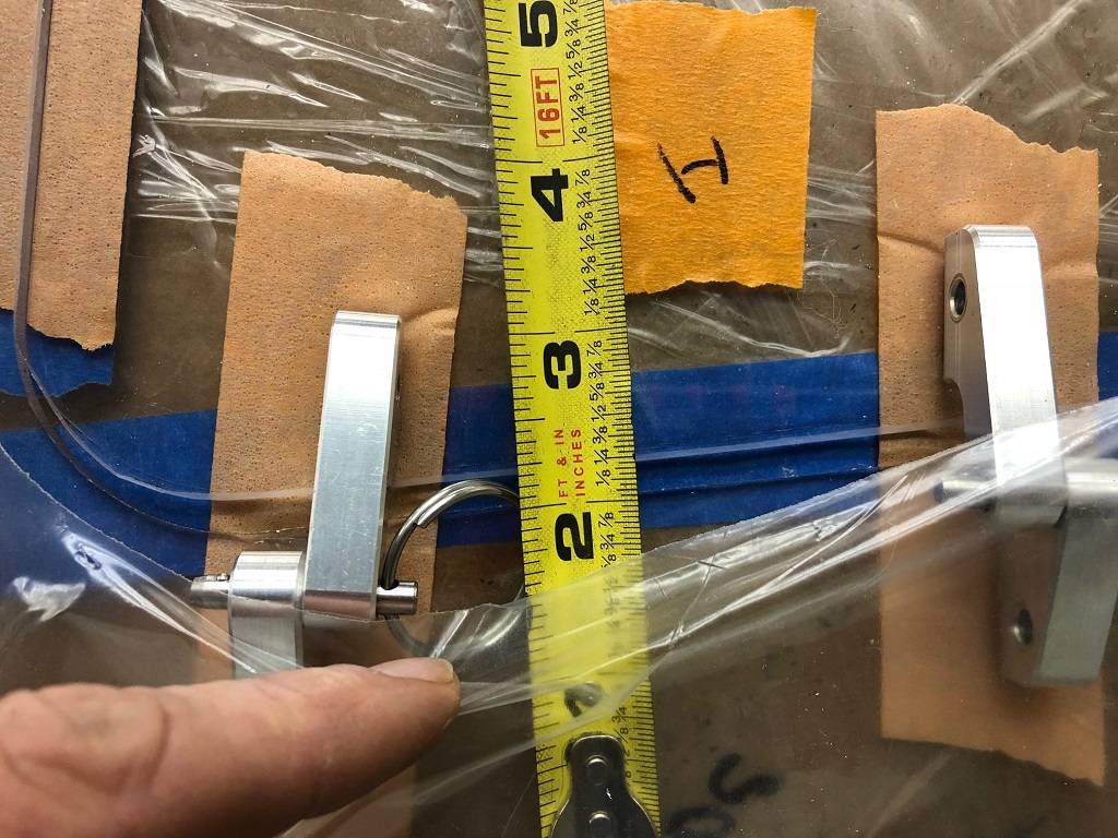

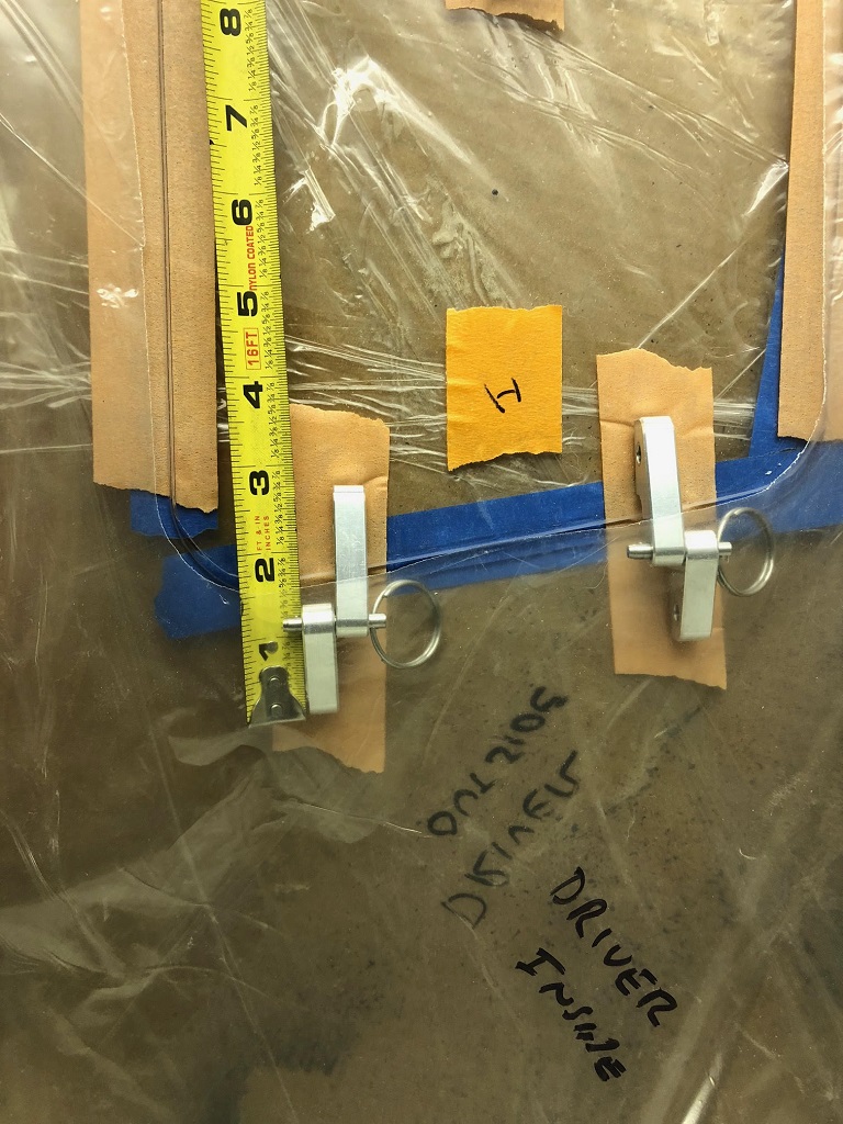

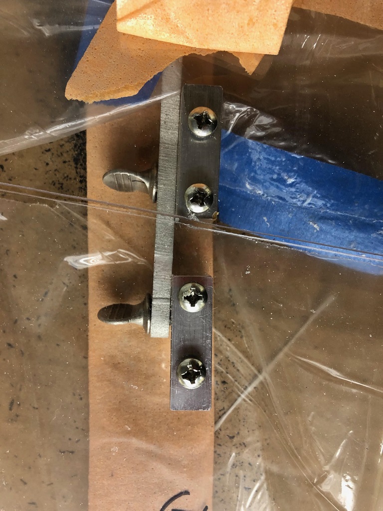

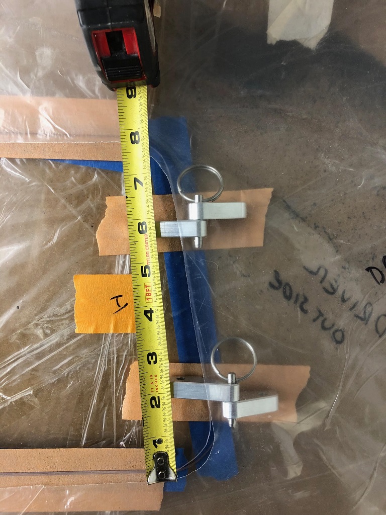

OK,
Someone had asked about the vent windows and I took some pictures and sent them to them, as I realized I didn't ever post "final" pictures after all the trials and tribulations that I went through getting things to work. So last night I unwapped them enough to get some images. I think the labels (inside, outside, etc) that are visible help explain things. So here are some pictures that I think show how things laid out and with them working without clearance or binding issues, maybe this helps someone else out in the future.

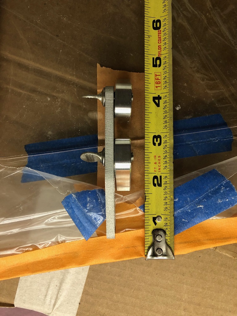

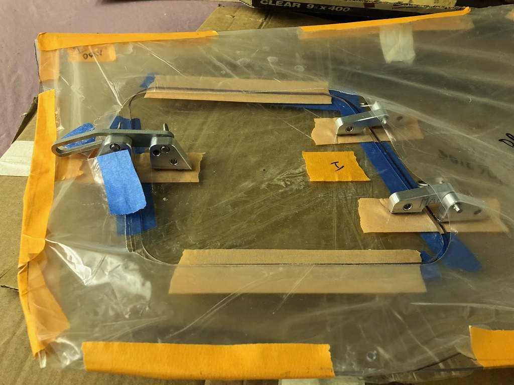

Vent windows part two
The last four pictures.
