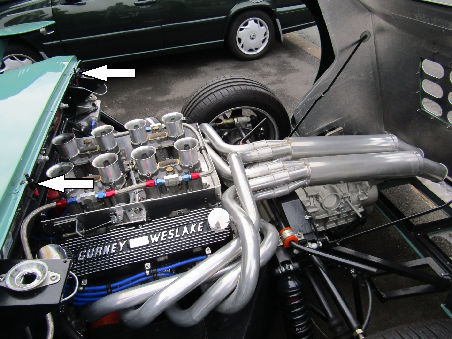

Two things now available for the GT40. First, electronic warning devices on rear deck to show it's not locked down,
I fitted two courtesy light door switches (arrowed in picture) connected to a buzzer. Only thing I would say is I chose a cheap buzzer which was a mistake. That may be because I have the same cheap buzzers for no oil pressure and indicator on, so can be a little annoying if the ignition is switched on when I have a perfect storm with all buzzers 3 doing their job.
Better than driving with no oil, an indicator left on or the rear clip scraping down the road I guess :)
