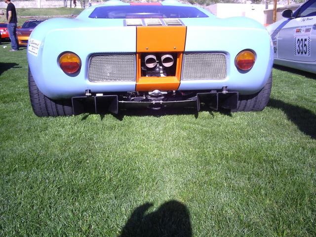

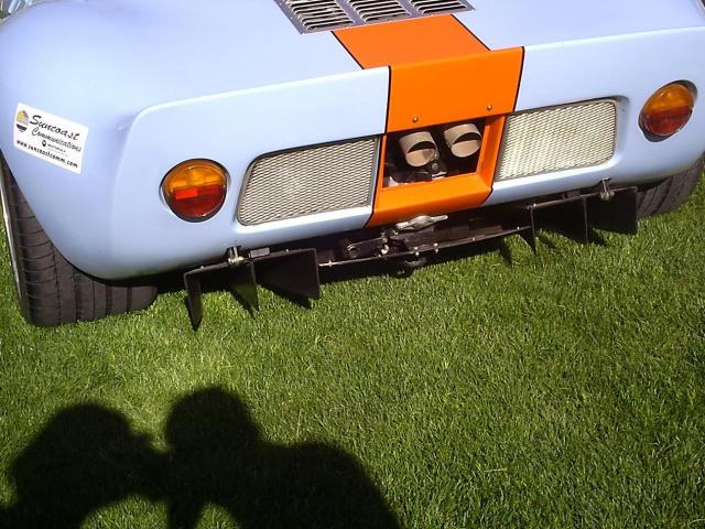

Cliff I open road raced with a guy who is not on this forum, his name is John Tiemann, he is trying to bust the 200 MPH flying mile with his car. He encountered many problems and once left the road, unhurt but still OFF the road. He has an Australian build 40 with Porsche transaxle with cooling for the long distance we race. He added the diffusers from the GT on his car which made it stable. I have pictures which I will post.

Dave, I'm in complete agreement. Yes the SPF suffers from a bit of lift at the higher levels but........IF we had the same aero improvements as the GT ie, a splitter, diffuser, etc, it wouldn't have even been a contest. For me I'd install a good set of canards, a good set of hoosiers, and I'd have no problem trusting my car to 200+. Personally I've been 166 mph (mathematically calculated) in its current configuration and that was just at the top of 4th. Felt pretty good too IMO.
