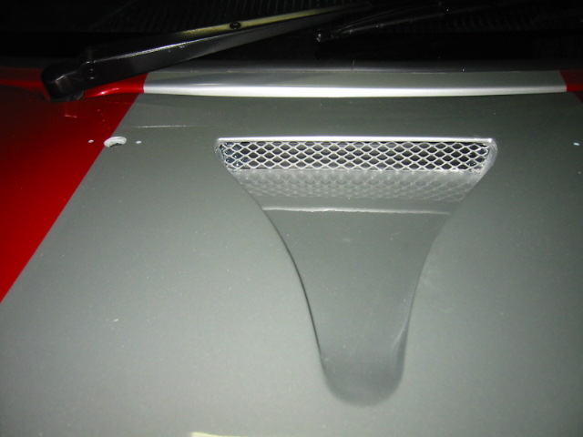

I've just finished cutting out ducts on my DRB, then made enclosures for them. The enclosures on side ducts allow me later to attach back into them under the clip where it can be done without damaging the paint on body. Also boxed the middle duct, but doubt I would bother using it. Norman is right, it's a huge amount of work just to do what I did. I have also had to clearance the the body for larger middle duct as well.
If you want to see my napa duct work, click here to check out photos on my build thread.
A lot of cars local to me just paint the front of duct black and put some mesh on front face. Actually looks fairly effective.

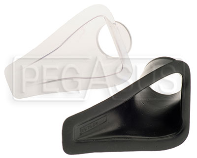

Here is the plastic "small" NACA duct from Pegasus Auto Racing supplies. It seems I could cut out the area on the front bonnet and glass in this piece. Then add the necessary ducting into the cabin. I plan on using an A/C system. I haven't figured out how to turn one off and the other on to keep from mixing outside and A/C air.

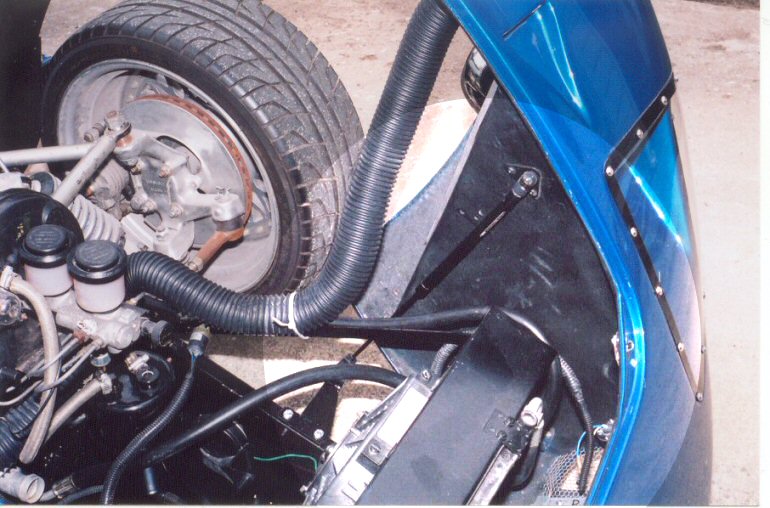

On most cars the use of the center duct would require a lot of work to employ. I won't say much beyond that until I take my trip up to Detroit to check out Fran's car in person. (This should happen in the next 4-6 weeks.) But generally a half box with rubber edging on the front of the spyder below the windscreen accepts the back of the duct when the front clip closes.
As for the the two smaller ducts on the front, I formed a fibreglass hose connector using modeling clay as a male mold and then glassed it to the underside of the front clip. (Again, I haven't looked at Fran's clips close enough to know if they have connectors already formed or not; most don't.) I connected hoses to these that go down to front of the foot well. I cannibalized a VintageAir MiniSpaceSaver for my A/C and one of the bits I saved was the demister section. It has two male hose connectors with a damper valve on the backside run by a vacuum motor. An electric vacuum solenoid valve lets me select outside air or none with the flip of a toggle. At the moment the fresh air is not drawn by the A/C fan, but relys on forward motion. However, sealing off the fan intake will not be difficult and is one of those "someday" jobs. The hoses are routed in such a way that opening and closing the front clip is not a problem. See pic below.
(No comments about the rusty brake rotor and tie rod end, please. I have a lot of this that I am still working on which is the result of having sat at the paint shop for a LONG, LONG time. I also have replaced the cheesy white tie strip with an elastic tie that pulls the duct into place when the clip closes. You can see a little piece of the duct behind the vacuum line and above the coolant tube as it traverses over to the passenger side footwell.)
