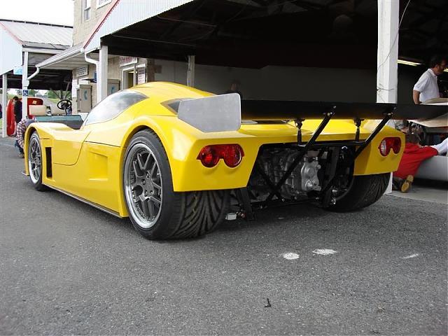

All I can say is WOW! and THANK YOU FRAN! I had the pleasure of finally visiting with Fran and seeing the RCR shop today. Fran - thank you for taking a few hours out of your day to spend with me - I truly appreciate it as I know you and your crew are VERY busy.
The shop is impressive and the products are even more impressive! I visited Fran primarily to look at the Superlight Coupe (RCR-P) but Fran was kind enough to give me the full tour. The quality of the suspension pieces, body panels and especially the welding on the aluminum chassis are really amazing.
While I have always loved the GT-40 Fran has struck gold for me with the Superlight Coupe. Pictures do not do the car justice – you must see it in person to really appreciate the lines of the car. The aluminum extrusions used for the chassis are welded so perfectly that it is like art. There are subtle curves and angles to the body – like the slightly raised hood section with extended nose and the tail section with its subtle curves – that need to be seen in person to be truly appreciated. 6-piston brakes on all 4 corners. Fully adjustable suspension. And, while I’m not a big fan of wings, the wing on the Superlight Coupe is bolted to the chassis (not just the body) and is adjustable. I might not use it for the street (it can easily be unbolted from the chassis) but for high speed outings or track days it would be perfect! Fran and his crew are working on custom seats for the car and I tried out the shell – it’s perfect for the car and while it wasn’t bolted in I can say it is very comfortable and shows RCR’s attention to detail. The wheels are ZO6 spec 5-bolt and beautiful – any wheel that fits a late model Corvette will work – LOTS of options! The interior is still in development but I was very impressed with the dash – very production car looking. Interior door panels are “in-process” that will line up with the nicely finished dash. I’m personally not a big fan of digital dashes but the one Fran offers provides a lot of information and fits the dash pod well. The scoop on the cockpit roof is fully functional feeding the engine compartment and the interior (via 2 air vents). The side vents are also fully functional. While the yellow car is a prototype, the fit and finish is excellent. The production door hinges will be more refined than those on the prototype but the ones shown are fully functional. Ingress and egress are made easier by the fact that one can actually stand in the car next to the seat prior to sitting. Interior room is impressive for a high performance car.
Obviously, I was impressed by what I saw today. Here are some photos of the car including first-time seen pictures of the front suspension.
Thanks again Fran – I had a blast!
Dave L
