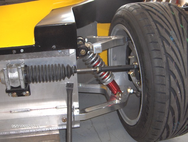

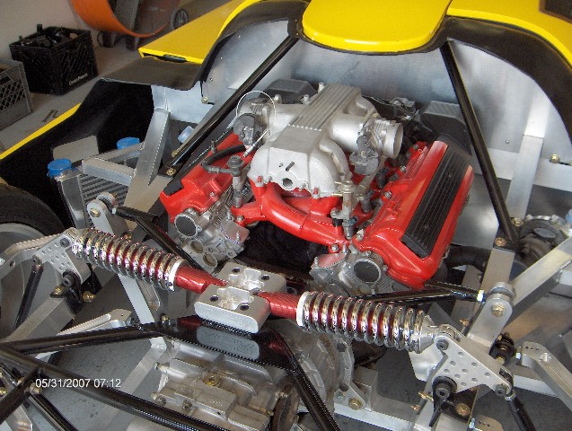

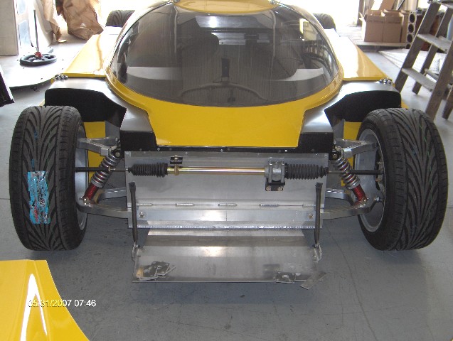

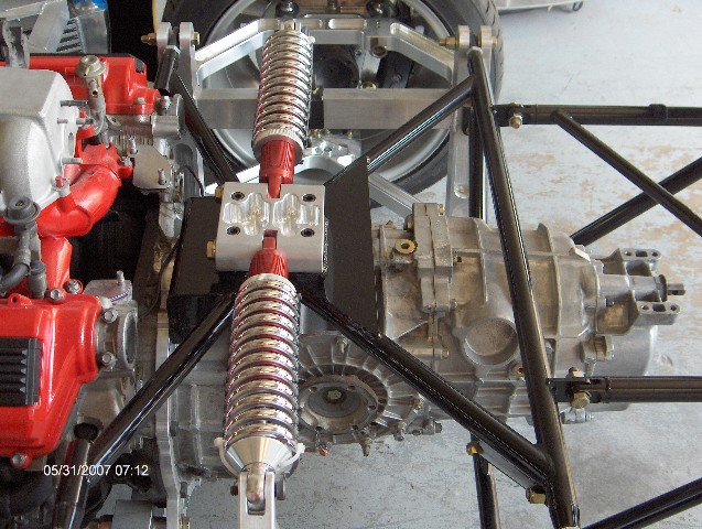

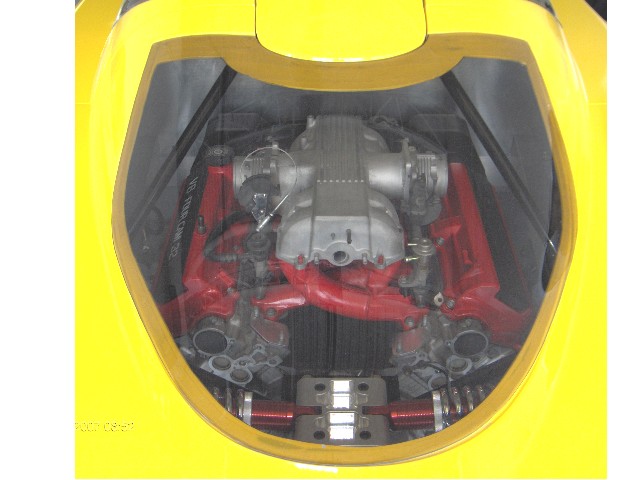

Lets try this photo thing again.....

Hmmm.... I really question if that Transworks joint is really a CV joint. It just looks like a shaft coupling. It may have enough clearance in it to allow slight misalignment, but in no way does it look like a CV joint. It appears to be a glorified U-joint.
Just adding my $.02.
