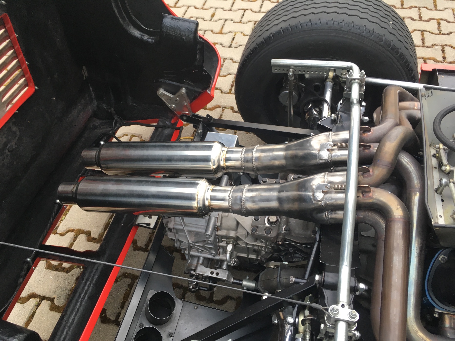

Chris, I use silencers similar to these that are attached to my megaphones. I think something similar is used in the IMSA racing series. Works really well and doesn't detract from the look of a GT40.

hello Jean-Marc,
we got below 103 dB for Spa with KOOKS mufflers and 90° turn downs. I doubt that 95dB is achievable.

Thank Chris, But I will not pass on most of the French race tracks, I have to found something less agressive.

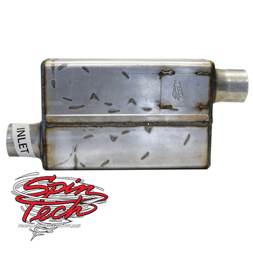

Does anybody try to use Spintech, they are the only ones claming able to reduce the nooise on rtace track ,
