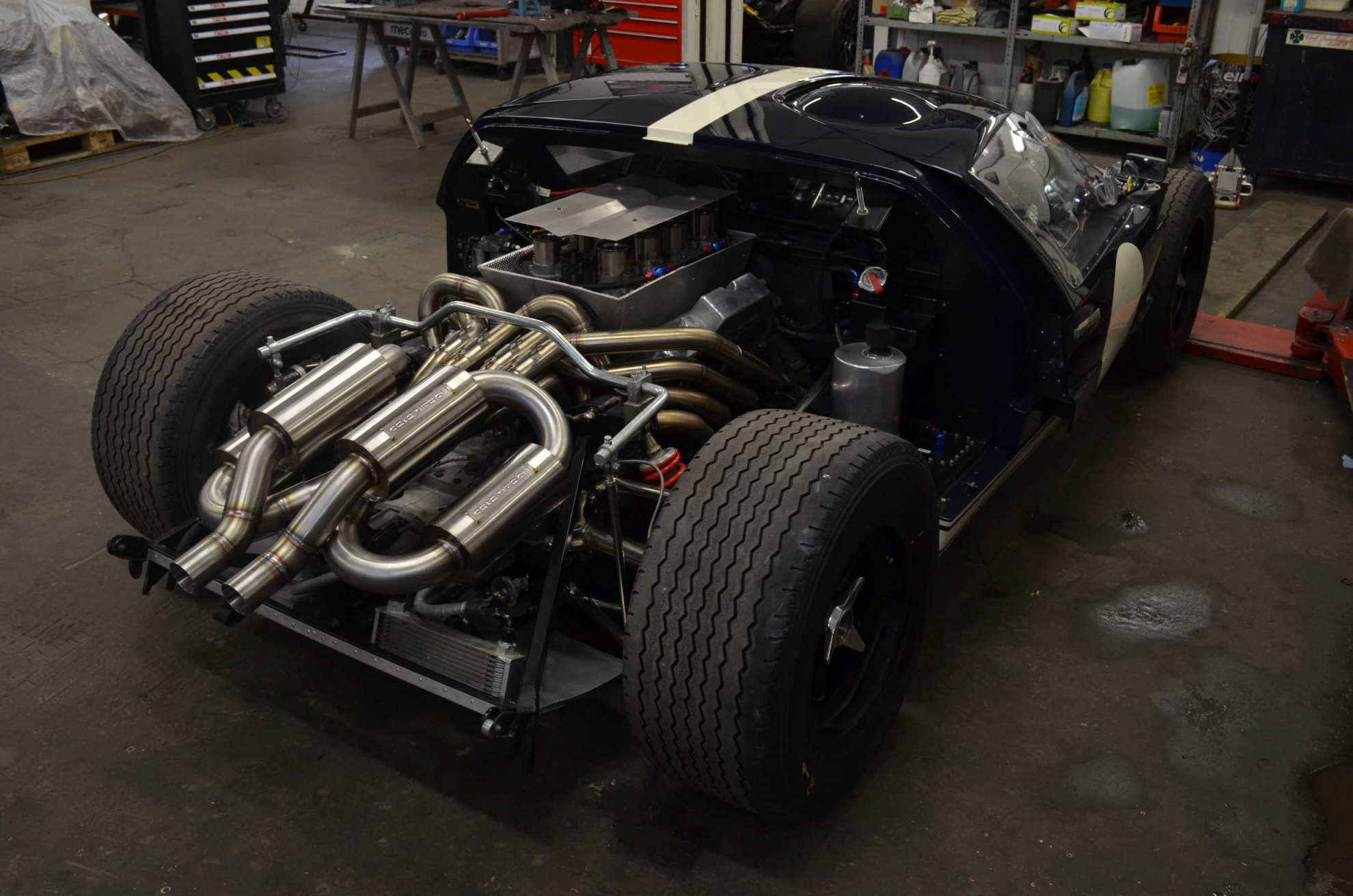

Glenn M
Southern GT make a pair of silencers to fit your need exactly. I used to faff about with add ons and wadding etc to get into Goodwood, and it was always nail biting at noise testing, as well as very restricting for the engine. But these do the job every time without fail and without any wadding.
I can thoroughly recommend them. Fit and forget that problem.
Glenn

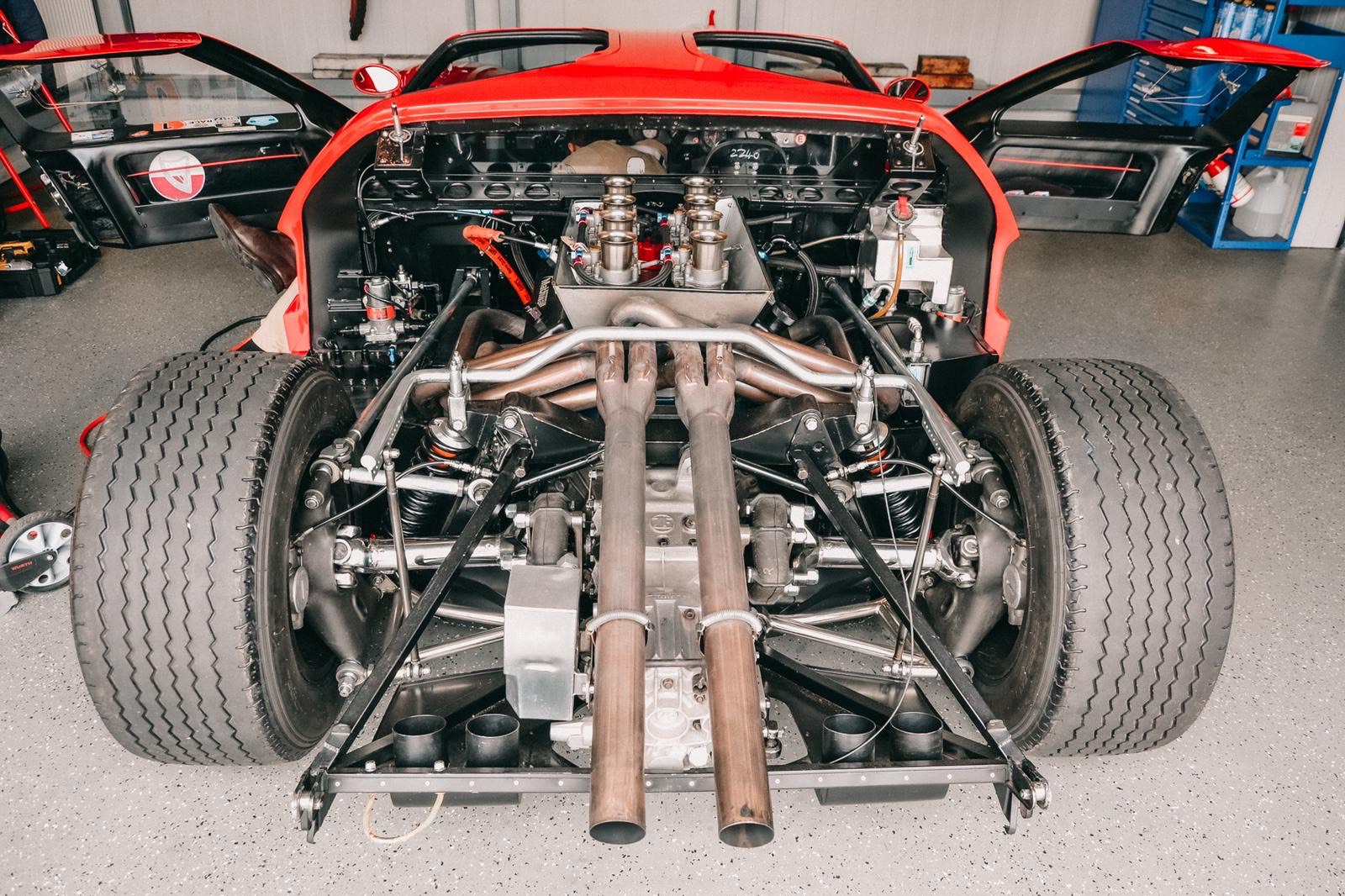

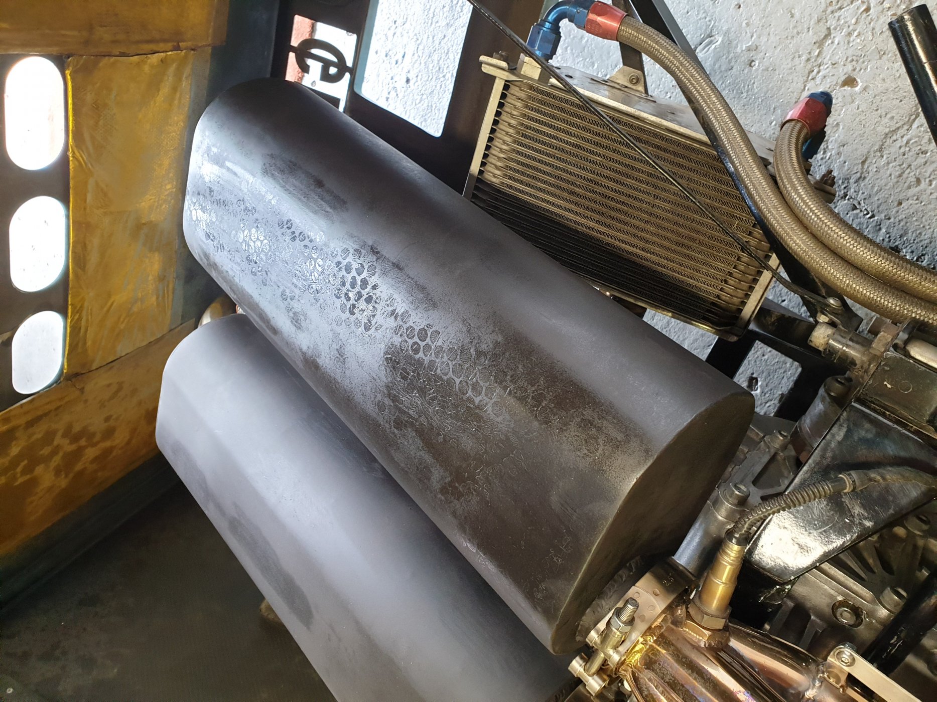

Rune
I made mine using 2 simons 2,5" turbo mufflers and 2 supertrapp mufflers. I used some nuts between the disks to adjust the noise level and had 97db on stand sound measured 2 ft from outlet 3750rpm. the disks was on only for regisration to get plates. Now disks are in a box much nicer sound. But the supertrapp is nice since you can adjust the db easy.

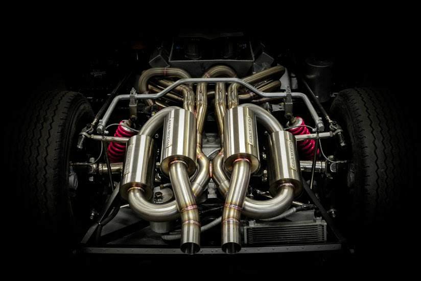

Glenn M
Thanks, Glenn. That sounds good. Could you send me a picture and a quote by PM or e-mail to sagamoore DOT noonan AT gmail DOT com ?
Chris,

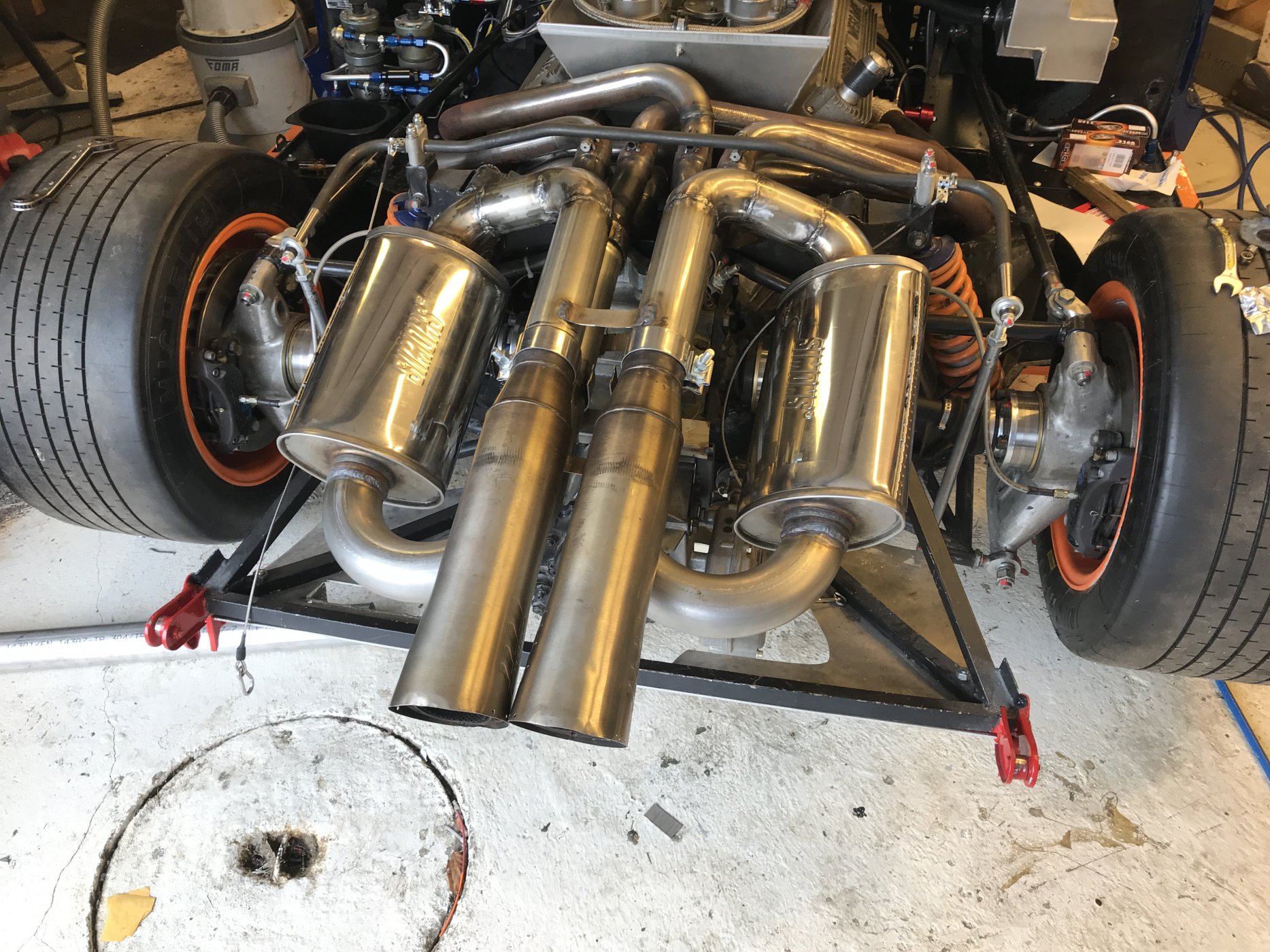

Speak to Mick at Southern GT for prices etc., (01489 890384) he's always really helpful. I'm just a (very) satisfied customer.
But here is a picture of mine. As Terry says, V-band clamps are the king to quickly slip on straight pipes for those noisy days!
