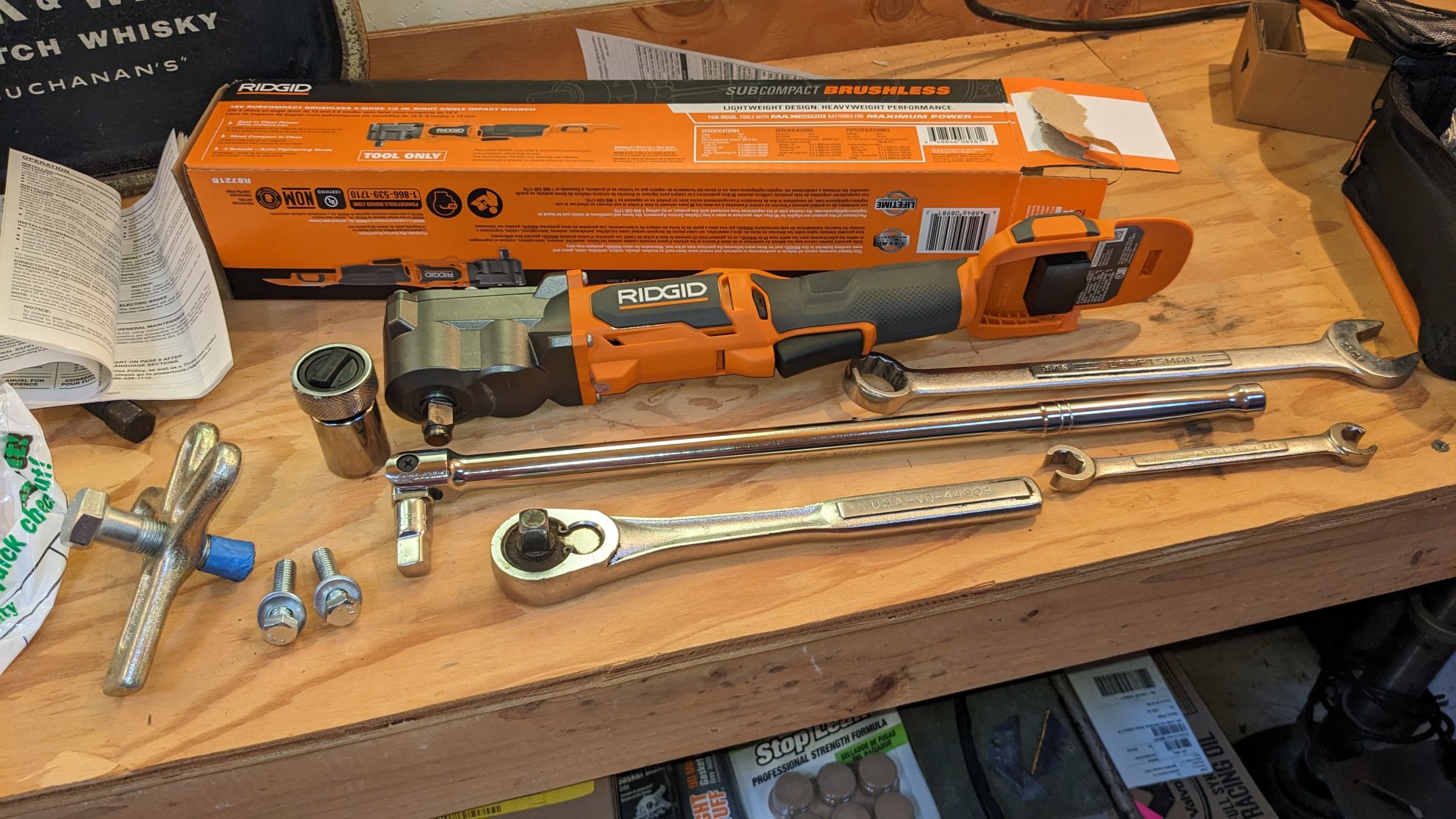

Thanks for the tip! I need to find a deeper socket and I have a 90 degree impact tool coming in if this doesn't work. Man that area is tight.
The next challenge will be trying to get a pulley puller in there...

I tried the top gear and ebrake with a reaker bar and it wouldn't budge. I do have a 90 degree impact driver coming this weekend. My goal is to get the damper off before I travel for a month...early next week. I would then buy everything I think I need for my return.

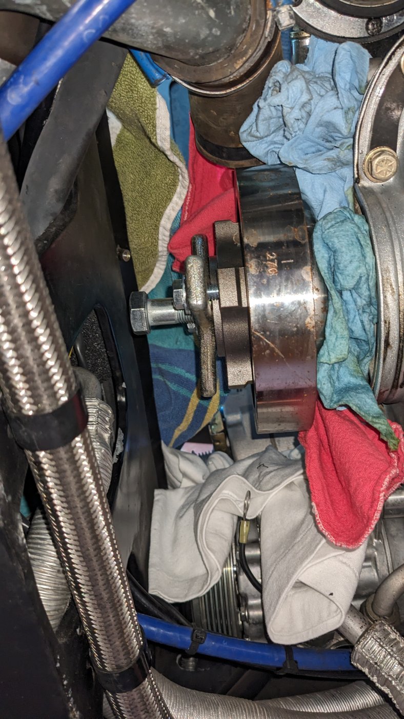

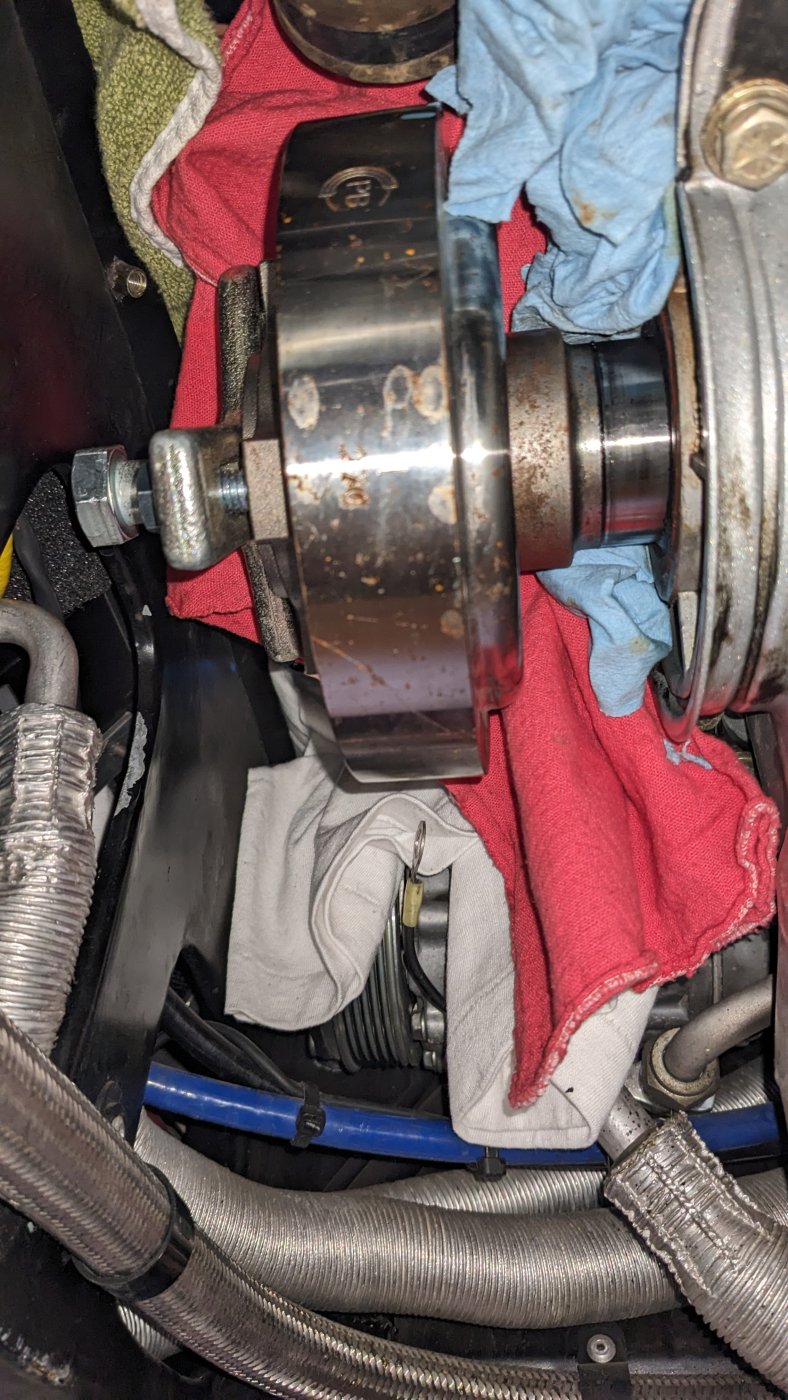

The 90 degree impact barely fit, but it worked. I didn't remove the bolt completely but just loosened it. Then I installed my modified pulley removal tool and worked the damper until it hit the bolt and repeated about 10 of these cycles of loosening the main damper bolt, installing the modified pulley and pulling the damper. The two pulley removal bolts only needed to be hand snugged each time. It all was a pretty simple process. I think the damper had to be pulled a good 3/4 inch (or more) out using this method until it became free.
The simple pulley removal tool was "modified" by replacing the long main threaded rod with a 60mm long bolt (M16x1.50). I found a small bushing to extend this bolt and have it sit against the main damper bolt head. Blue tape held the bushing to the puller tool bolt. I also reversed the orientation of puller as it flare in thickness at the center...this side was put in the damper void to by another 1/4" clearance between the tool and the bulkhead. All I can say is that it all worked.

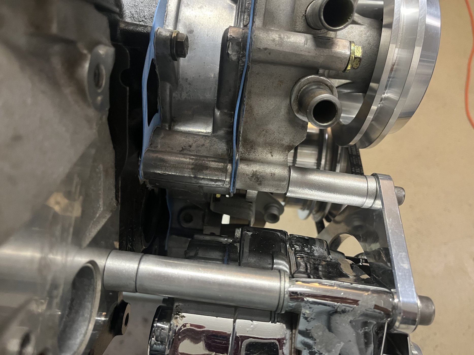

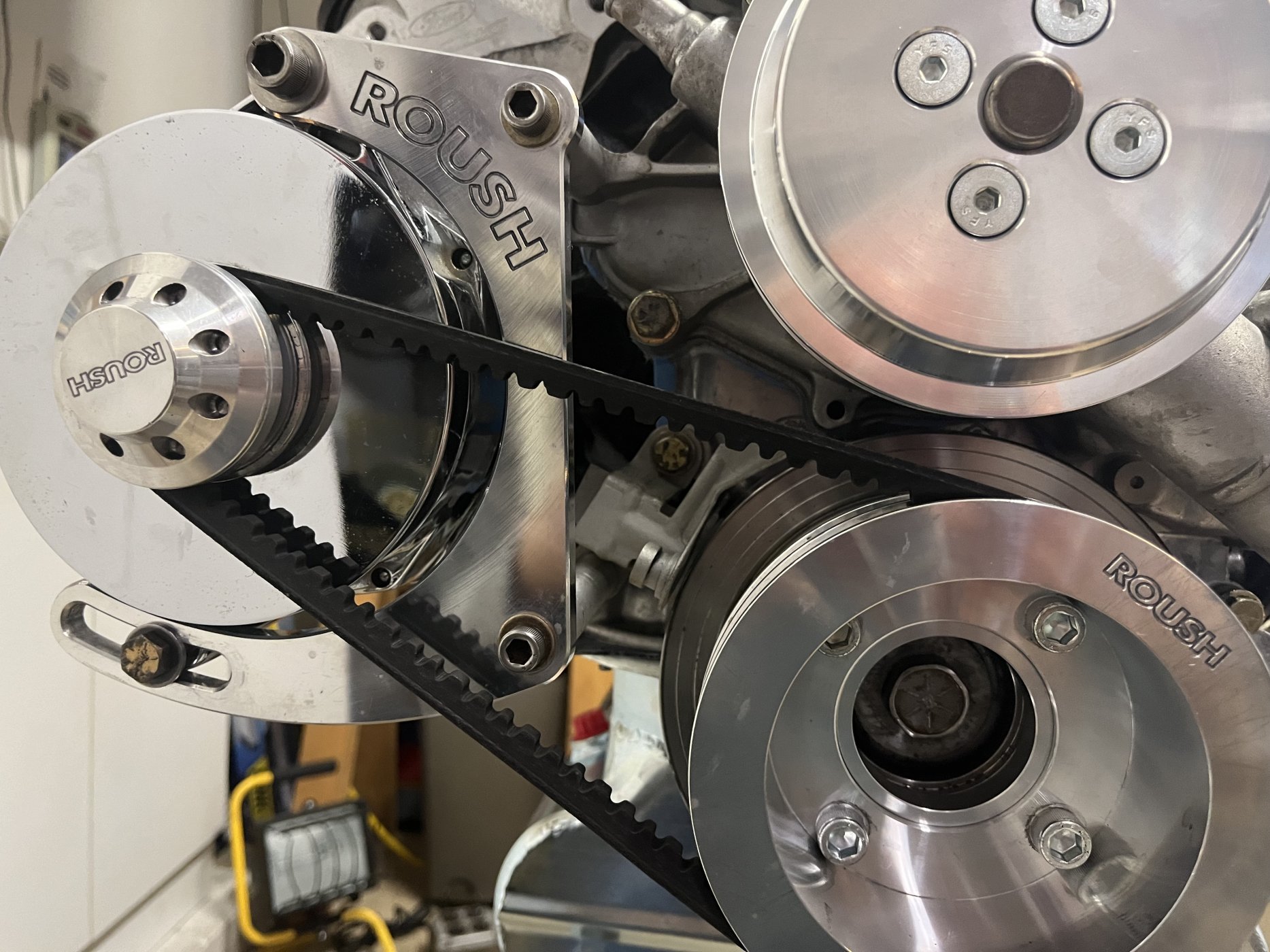

I have seen that one Michael. My concern is that the one I removed has no sensor mount on the left. I am not sure if that will interfere with the Roush accessories setup. Are you running a Roush?
I have Roush pulleys and alternator brackets, no interference.

You have a different Roush setup from mine. I think it is worth a try though. I am 1,000 miles away from the car, so I can't take a peek to verify. Going for it! Thanks again.
