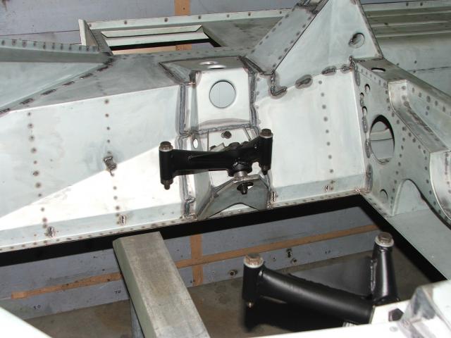

From the build logs. These are mk1 mounts for small block.
At this point I am wondering if there are engine mounts that don't intrude as much into the oil pan area.
Also, is it possible to raise the engine enough to swap out the mounts without fully removing the engine?

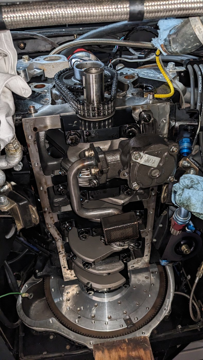

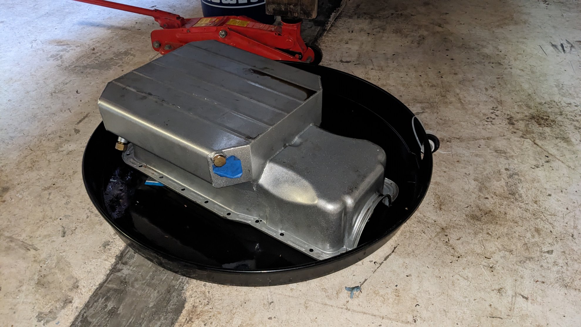

Some success today while following D. Olthoff's directions. The oil pan is off.
Does anyone know what brand this oil pan is? This is a Roush crate 427R from 2006 vintage. Now some cleaning and prep for reassembly...and another trip away for a few weeks.

Now test fitting the gasket to the oil pan, all holes line up, but one thing has me scratching my head. The oil pan has a pronounced rib in the half moons, but the gasket is flat across that area...this reduces the contact surface on the bottom sides of the half moon....hmmm.
