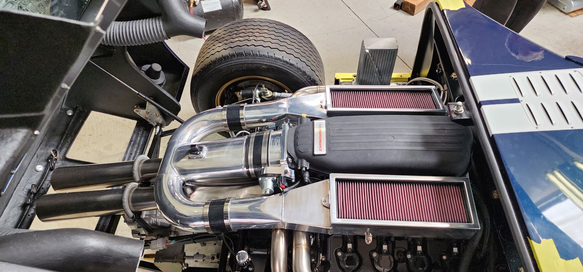

Hi All,
My first post of I'm sure plenty.....
My Pace GT is in the shed and I've been tinkering away on brakes, cooling, suspension in prep for the powerplant, a new crate Coyote that I picked up from my local Ford guys last week. Amongst other things I'm aquiring bolt ons like a/c compressor and alternator before I hoist the engine in for the first time. Any tips on the best places to get these bits or is it straight to the kit the Ford Performance offers?
The intake of course needs to be reversed and I have been told that this is possible on the gen 1 coyote and before I start removing mine, can anyone enlighten me on whether you can do the same on my 2017 engine.

Alt and AC compressor should come from Ford. They are relatively inexpensive and of OEM quality. I don't believe that the 2017 intake can be reversed. You can either bolt on an earlier intake and reverse it or install an aftermarket intake such as the Ford Boss 302 or Cobra Jet. Keep in mind that the Cobra Jet intake is very tall and requires its larger oval throttle body.

Thanks Ken, yeah the stock one looks like interference with the coolant offtake would occur. I've been advised overnight by a wrecker in the US that the electics may not be compatible with the 2014 either. The problem in the short term is that the car must be engineered/1st registered as stock standard, then you might consider aftermarket changes ;-) I may look at modifying the cooler pipe.

Are the 302 or Cobra Jet intakes reversible on a 2015 Gen 2 Coyote?
