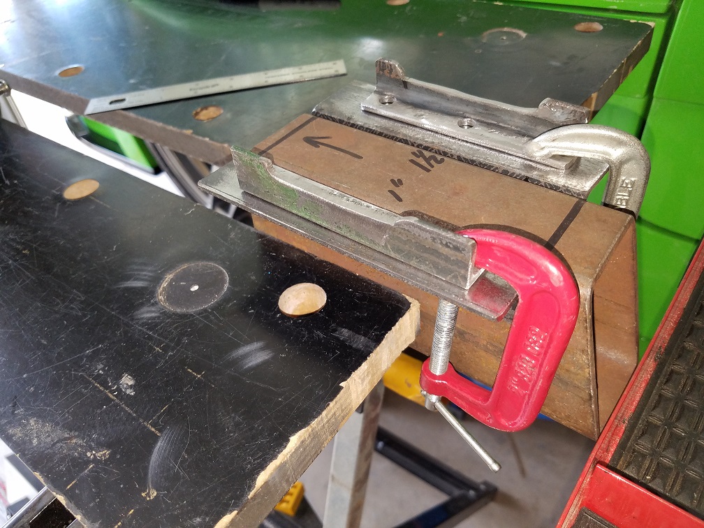

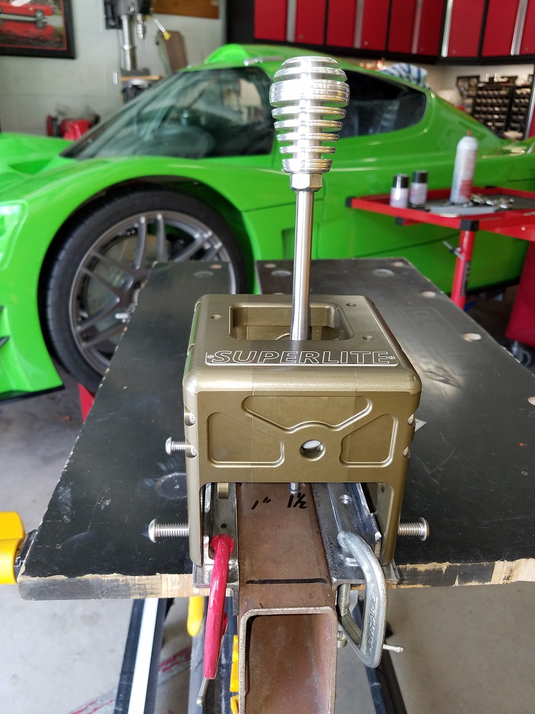

Started working on the mount for the new shifter. Using a piece of 2x3 tube to simulate the center rail so I can work out of the car. Keeping it offset 1/2" to the passenger side to give me a little more room in the driver's seat. Next step will be to weld up the two brackets then drill the 4 mounting holes. My welder (daughter) is passing through town this weekend so will get that all finished then will position in the car.
For those that have been looking for dimensions, the base of the shifter is about 4 1/2" square so it overhangs the 2" center rail. I used a piece of 1" angle on one side and 1 1/2" angle on the other to get the 1/2" offset I was looking for and to fully support the front edge of the shifter.
Since the shifter is wider than the console, will need to come up with a new strategy there and then get the assembly sequence down so I can hide everything within the console.

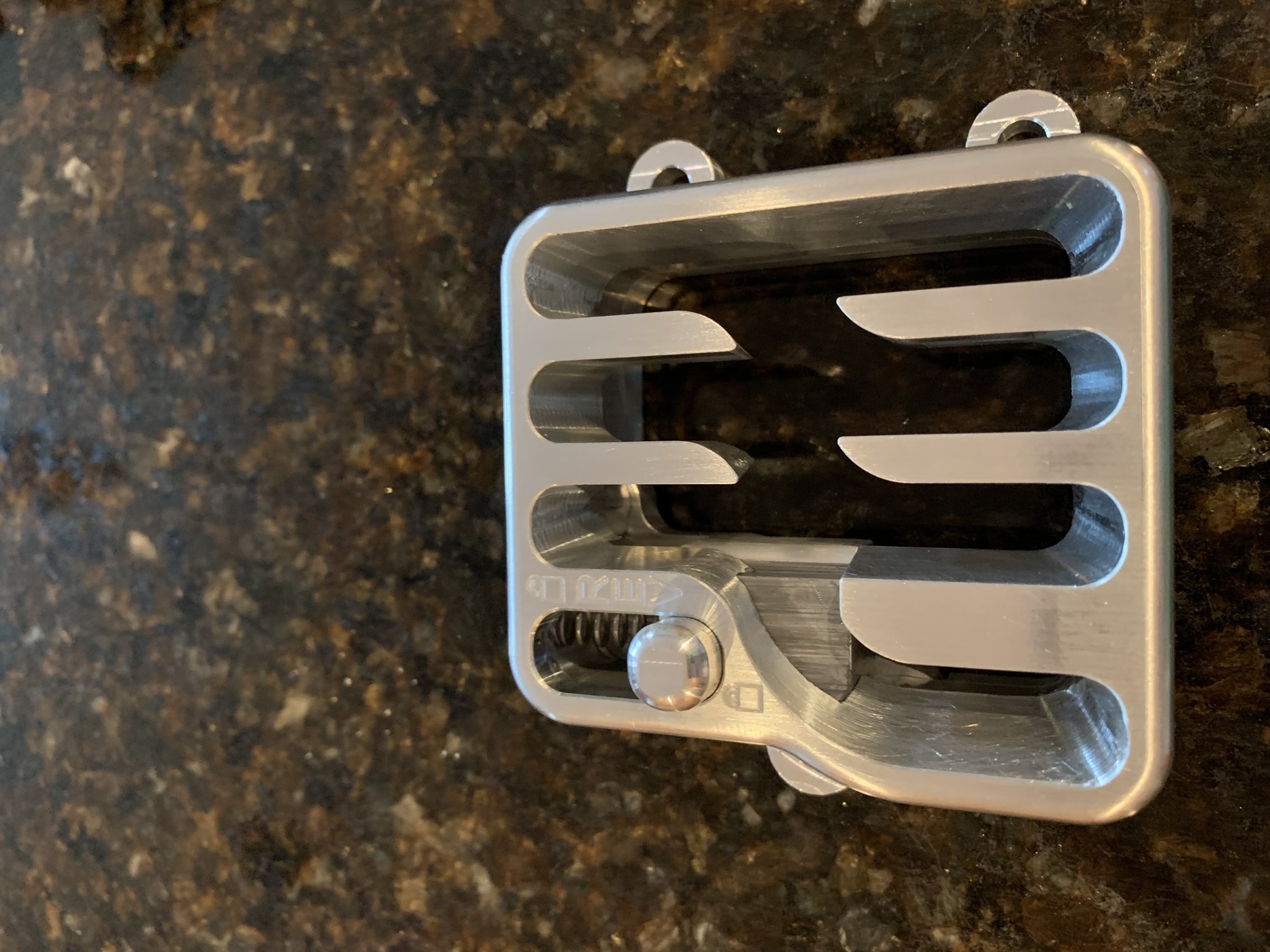

Superlite is pleased to announce general availability of their new in-house designed and CNC-machined billet shifter for the Graziano transaxle cars. Many builders have expressed a preference for the OEM Audi R8 shifter because of its improved feel and appearance, but these are increasingly difficult to find, and will only become harder to source in time. The OEM shifters are also physically large, which makes installation more complex, and often requires modifications to the car. And of course, the Audi OEM shifters are expensive, even when you can find them.
The new Superlite shifter for the Graziano gearbox is more compact, has an improved shift gate, uses the same geometry as the OEM shifter, and dramatically improves shift feel and accuracy compared to the previous shifter.
These spectacular shifters are available for $1495. Existing customers with a Superlite car and a Graziano from Superlite should contact the factory for more details. Please allow 2 weeks for production of your new shifter, as these are very machine intensive to produce.

The shift knob shown is for testing purposes only
