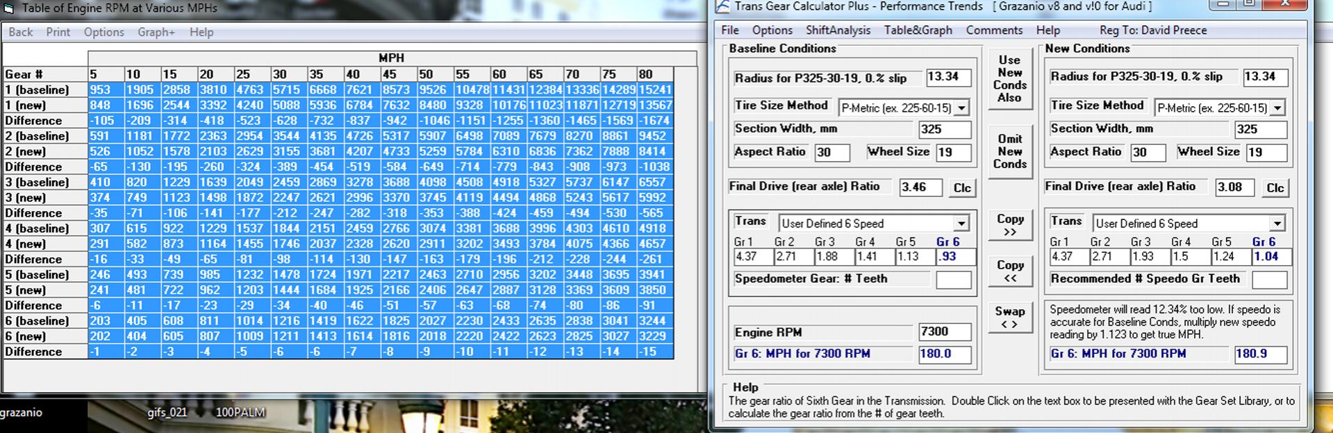

Mike (or Dave), is there any way that you can determine from your models what the rpm's are at 75 mph in 5th and 6th?
Looks to be ~3400 rpm for 5th and ~2800 rpm for 6th

I realize this thread is old at this point, but I believe that RX-Heven was looking at the 70 MPH data rather than the requested 75 MPH data. Correct answer for 75 MPH should be ~3650 RPM for 5th and ~3030 RPM for 6th. Compare this to ~1600 RPM in 6th for the normal late-model Corvette Tremec setup.
I will continue to follow the Graziano threads, as I don't understand how these factory gear ratios are palatable to SLC owners that are (1) likely OCD by nature, and (2) spending $10K on a gearbox. The V8 Graziano's 2nd gear, according to my speadsheet, is shorter than the Tremec's 1st gear.
Not trying to disrespect the efforts of anyone involved; rather just trying to understand the compromises and final product. Perhaps I simply lack the appreciation of how starved folks have been for any durable transaxle package. I have seen rumors of a Graziano drop gear setup and will keep my eyes open for news on that front.

I've modified the latest gearing spreadsheet floating around to include the 0.7586 drop option (detailed by <a href="http://www.theraceline.net/the-race-line.html">these guys</a> on a thread on factoryfiveforum) applied to both the V8 and V10 Graziano boxes. I also included a late-model Covette Tremec ratio set for comparison since most people are looking at an LS engine. Included a redline of 6,600 RPM for the LS376. See columns N, P, Q in the attached.
The drop option looks nice. The factory Graziano ratios without the drop... not my favorite.
