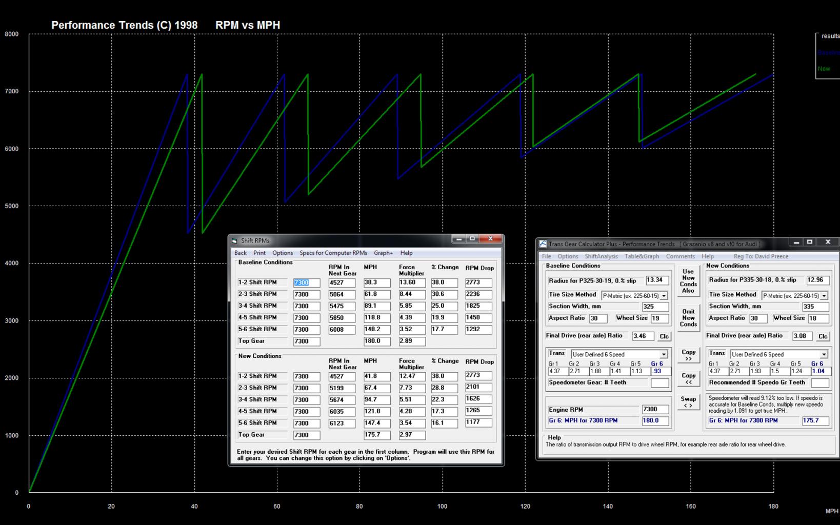

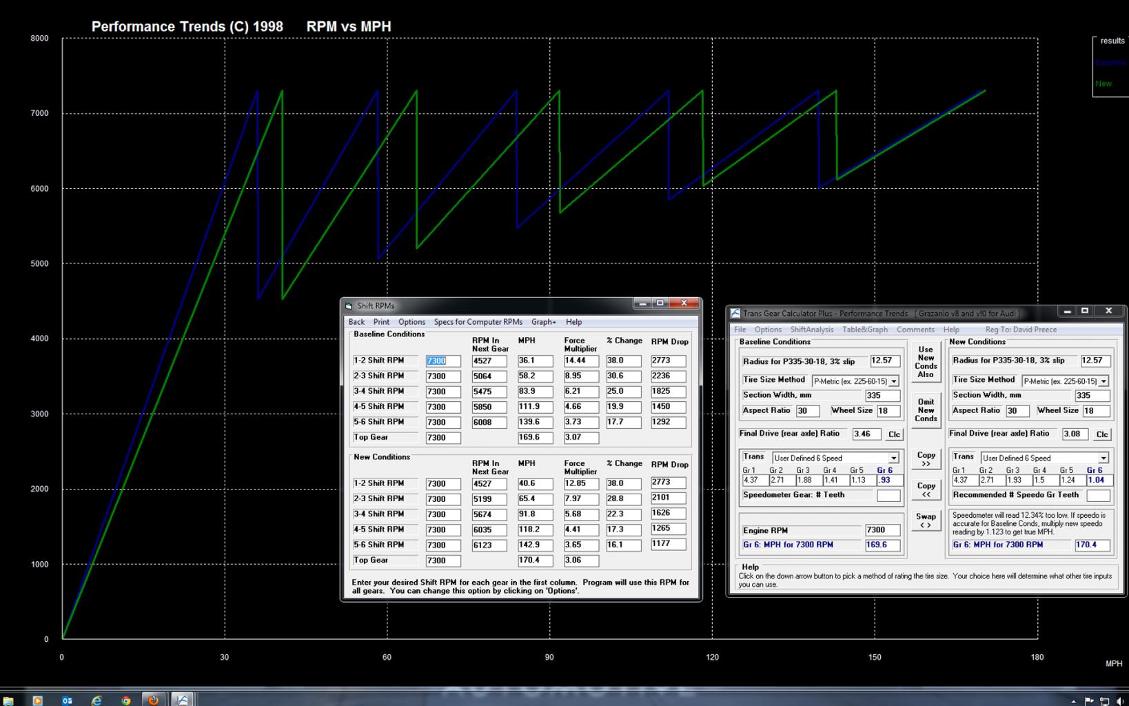

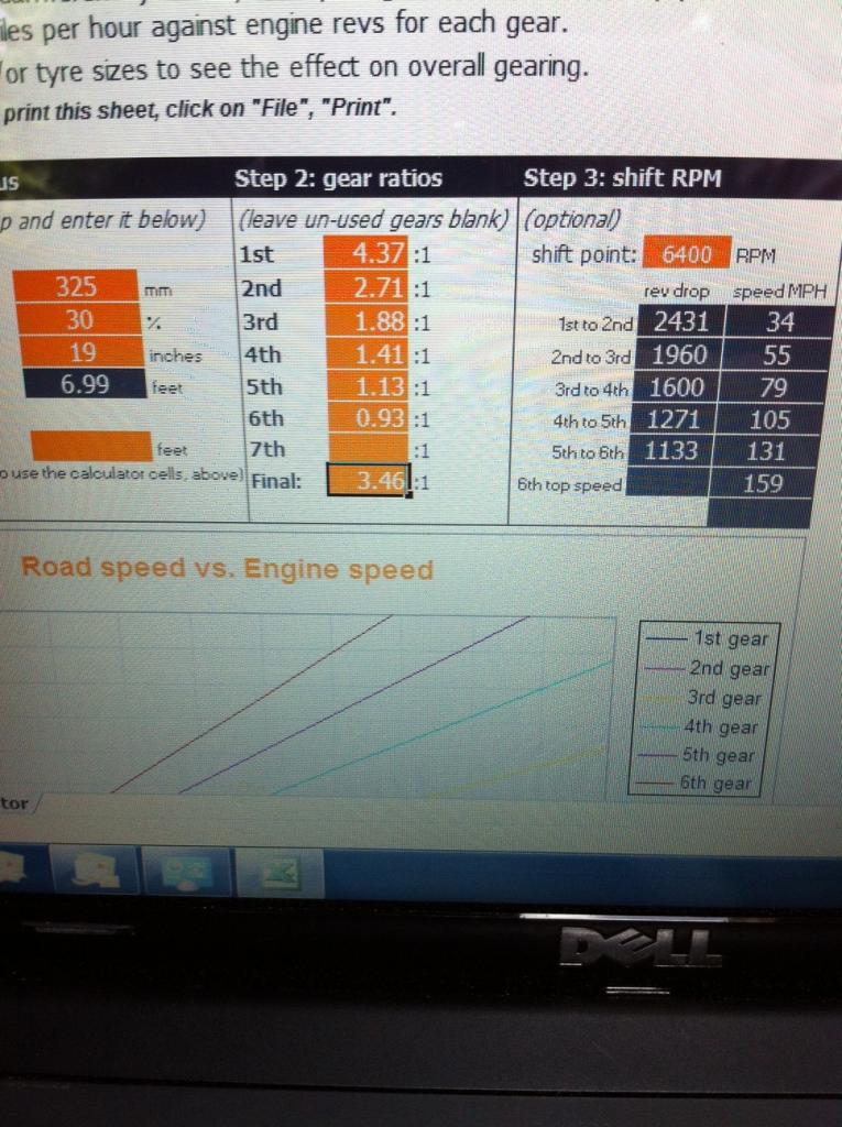

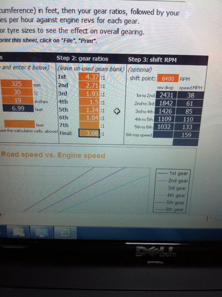

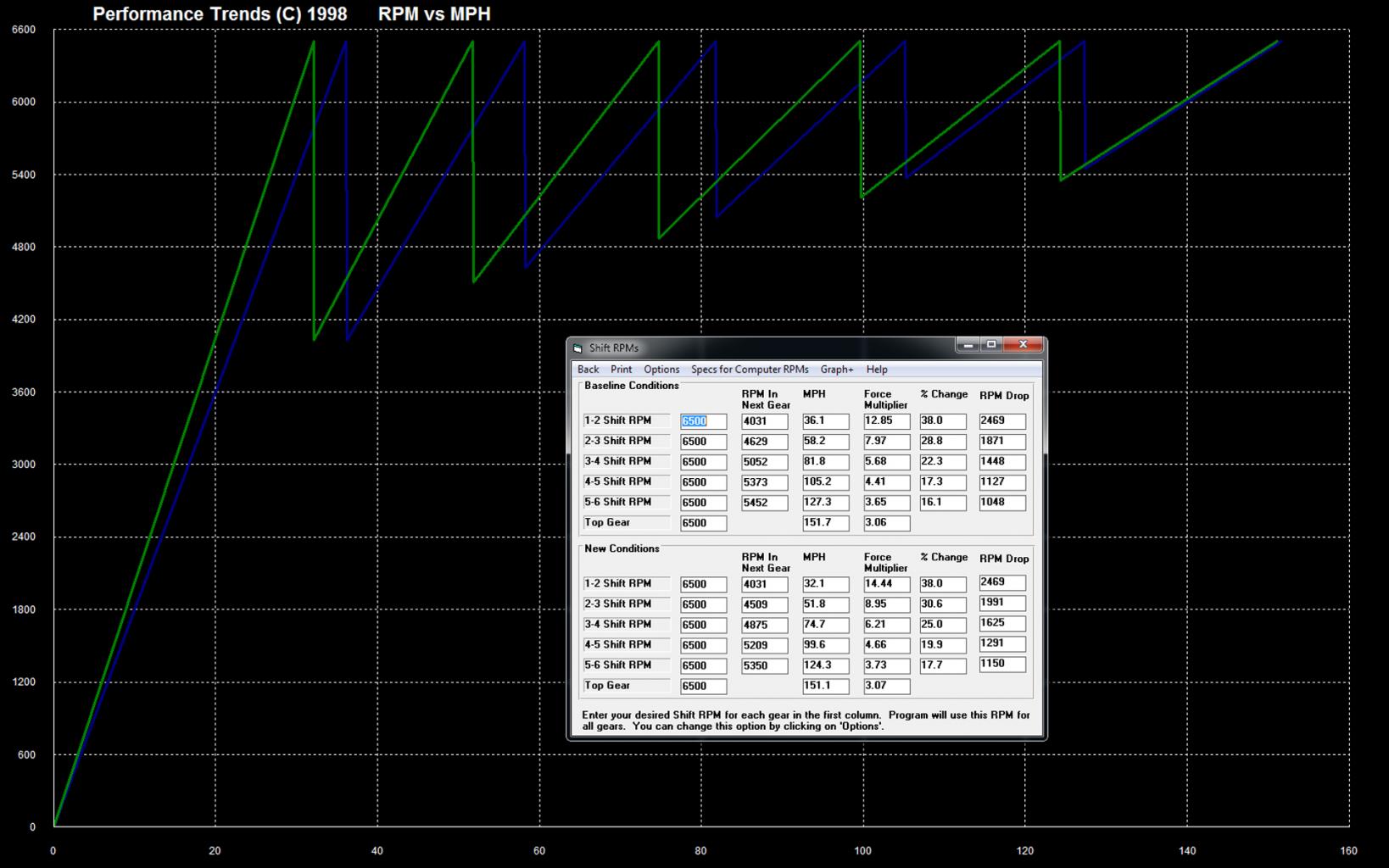

Gear-speed-tire-rpm figures -- pics attached
Haha. I set mine to 6500 rpm too. I assume those boat anchors couldn't rev any higher...wut do i know, I'm a rotary guy :shrug:
Updated to 325/30/19...didn't know that was the new standard. I am running 335/30/18.
Also eliminated tire slip that was set to 3%. This latest graph will show the absolute highest figures but will be pure theoretical though without tire slip factored into it.
attachment.php
