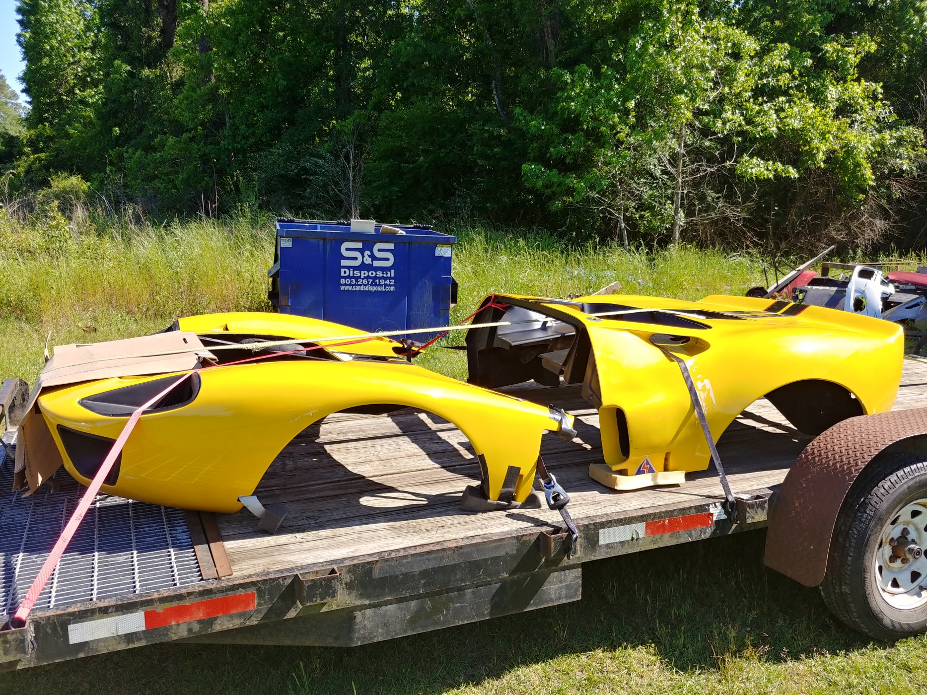

Thank you all. I was blessed with the opportunity to purchase the racing spare body parts from P1027 (just fiberglass copies but I think it's cool they were on an original car). I have built other replicas and own a shop that builds street rods and muscle cars. I've been in business many years and helped my father in law build a cobra and intend to build the GT40 to share with him. He's a Ford nut and he built a two car garage for his cobra, one day I hope to see this GT40 in the spot next to it.20200427_161034_HDR.jpg

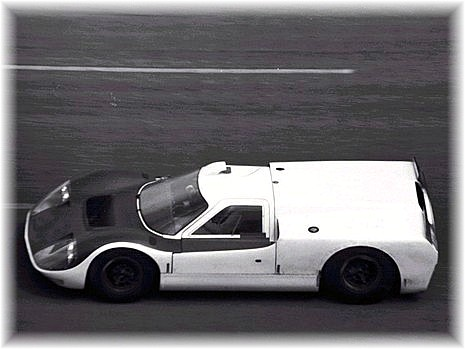

although surely nobody in their right minds would recreate the 'bread van'
If this is the J car, then it has been done Andy, molds of the body are even available in the USA.
it has been on display at the Simeone museum in the past/may be there now? alongside other MK I and MK II GT40s. its a proper deal as well, many GT40P numbered parts, Clip latch hooks in mag, T44 gear box, 427 engine, alloy chassis, correct turbine wheels ect

Bart, a fiberglass copy of an original fiberglass part is pretty damn authentic ! (just place a 'wanted' ad for the middle bit & you're there....)

Thanks. I'm excited. I got the front and rear clips and the nostril panel that were on the car when it came in for restoration. I got the spare doors that were never mounted. I bought a pair of rockers that were supposed to be copies of originals (but were not spares for the car) and I have a roof spider on order from Jay Cushman.
I have a lot of chassis figuring out to do....well a lot of a lot of figuring but chassis is on my mind at the moment.
