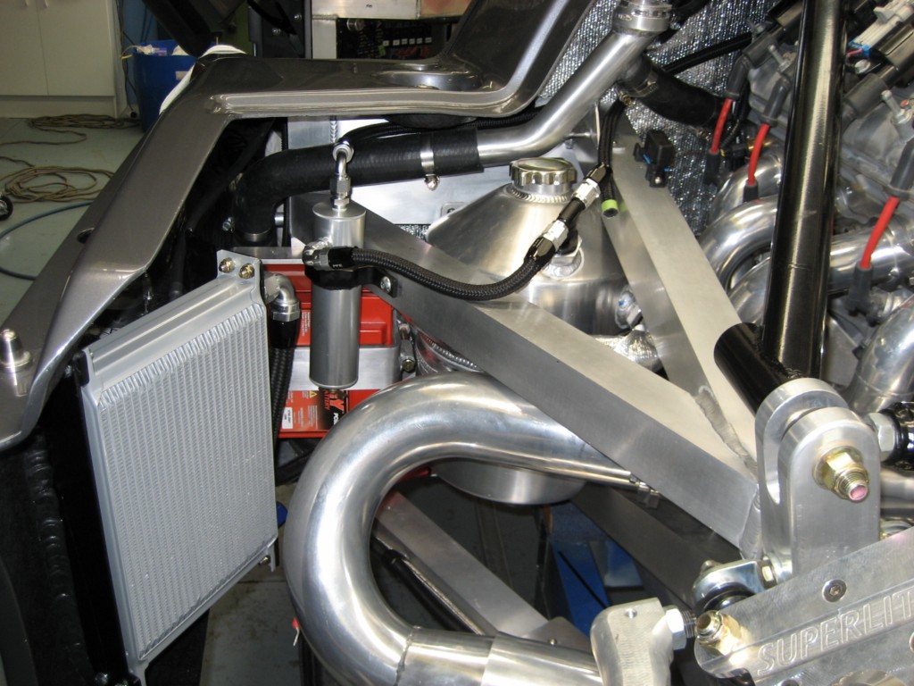

For those putting the coolers in the side ducts, how are you getting your hoses to the cooler since it seems they have to pass over the exhaust (and heat rises). Just clamp them to the rear x-brace away from the exhaust best you can and maybe cover in heat reflective tape?

I have two Setrab 650 series coolers, one for each side vent but they are not plumbed yet though the routing is planned to be in front of the engine with my dry-sump tank on the drivers side in the triangulated area...much like Fran's original car, just the opposite side.
I guess it depends on what coolers and how they are oriented in that area as to how they will be plumbed. Plan accordingly.
Does this photo help? If so, I might have more from other angles.
