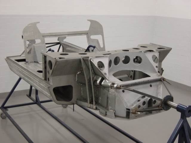

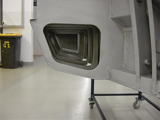

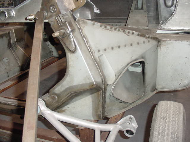

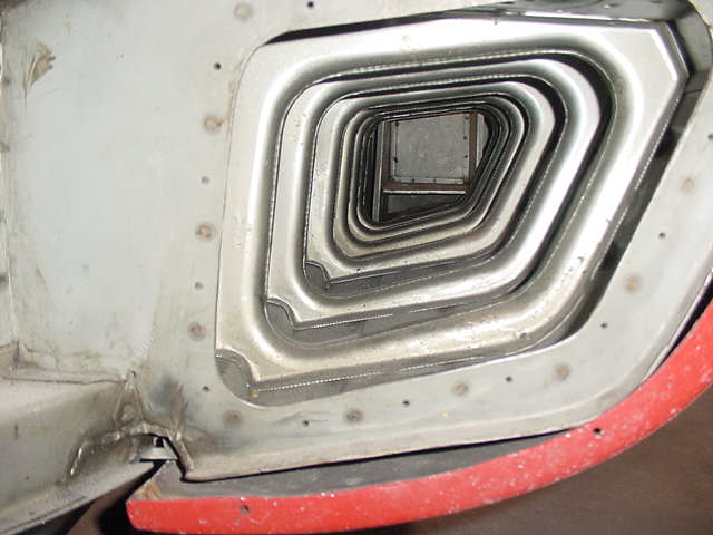

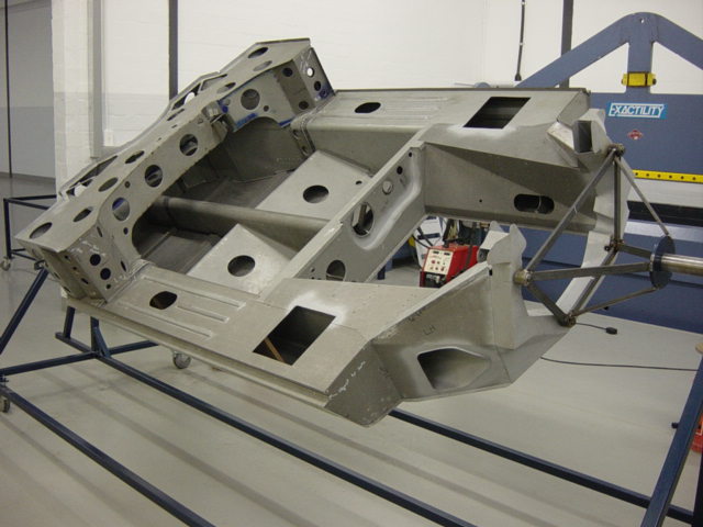

some chassis pics

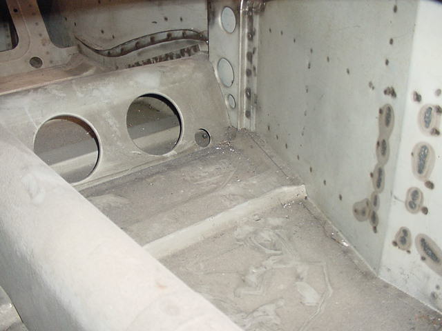

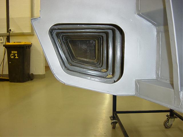

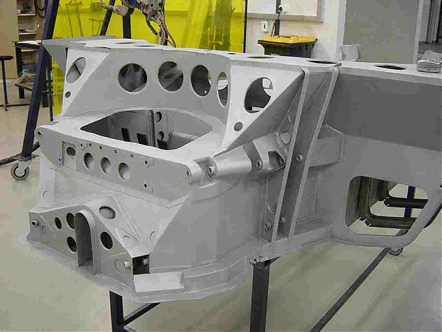

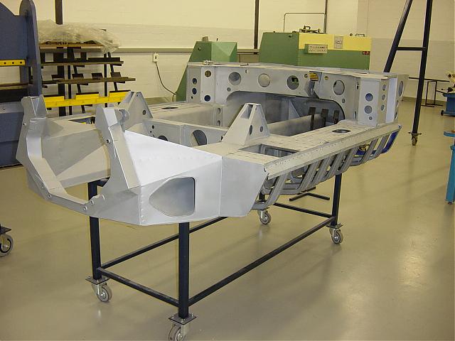

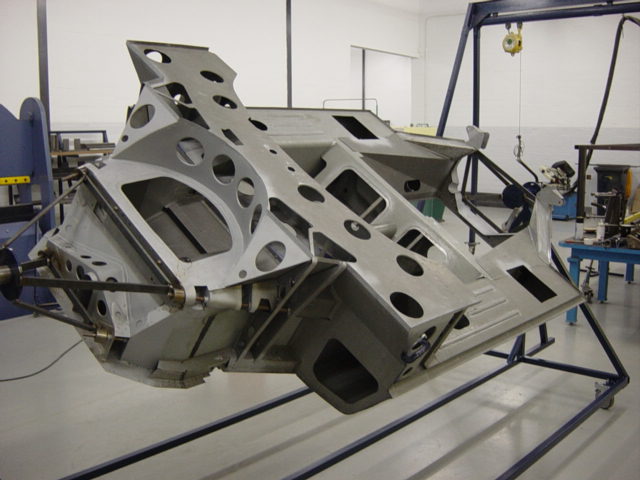

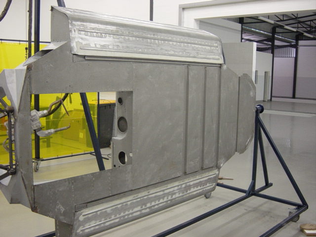

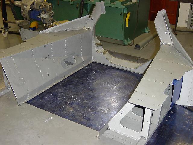

some more SPF chassis pics
Thanks Chris, great pictures hope you didn't have to kill anyone for them. Looks like I have way more work to do than I thought. There is one shot that almost shows the structure of the frame around the tube that the lower control arm runs throght. Guess I’ll drill a hole at the rear (just in front of the rear tire) and see how far forward I can see. Like I said in the post I really don’t want to play proctologist. Do all the ribs (not sure what else to call them) have holes through them the same shape as the outside perimeter of the part? Now if I could only get my halo deck fixed I could just walk around the part and have a look, lol. I’ll post pictures as I go. Might still need that endoscope.

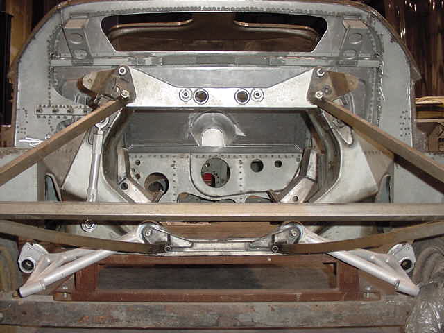

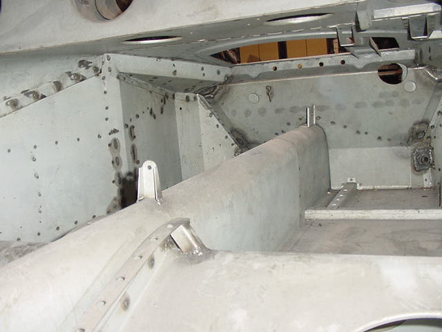

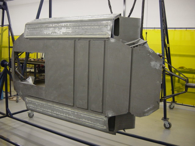

Some original chassis pics
Chris, Thank you for posting the pictures. Those were all of chassis #1. As you can see all the panelling is automotive grade "zintec". Before etchcoating and painting we also seamseal all joins. I also agree with Roy that the original bag tanks were a cause of most of the sill rusting. Our stainless tanks allow plenty of ventilation space inside the sills as well.I very much doubt that, with the type of use our customers put their cars to, corrosion will ever be a problem. That said, any extra protection cannot hurt.
kind regards Jim Price
