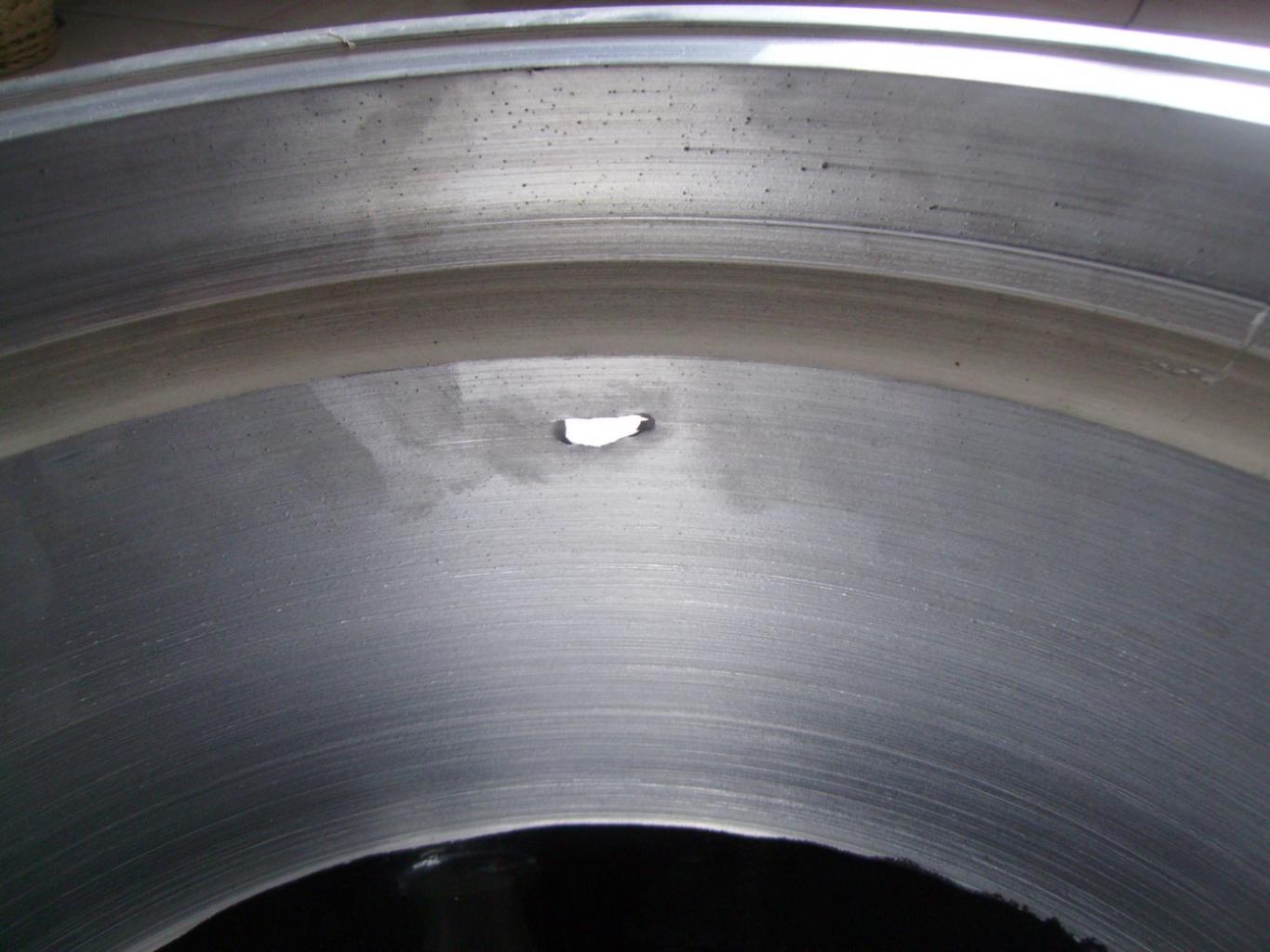

Il manque trop d'alu ,cette jante était très abimer ;ils ont sortie trop de matière:huh:
May I help for translation, and add few details to the story...
Serge means that the guys who restored his wheels (aluminum) machined one of them a little bit too much, as it was in poor condition.
Setting back the old tires on the wheels, just to move the car more easily in the workshop, made a hole in one of the rims...! After careful checking the rim section of that wheel, appears now being far too thin (1mm left only !).
Better for Serge to realize that weakness in the worksohp, than in the middle of a hard cornering...
These wheels, now only considered as decorative items, will fit nice on the workshop wall... Looking for a brand new set, by now.

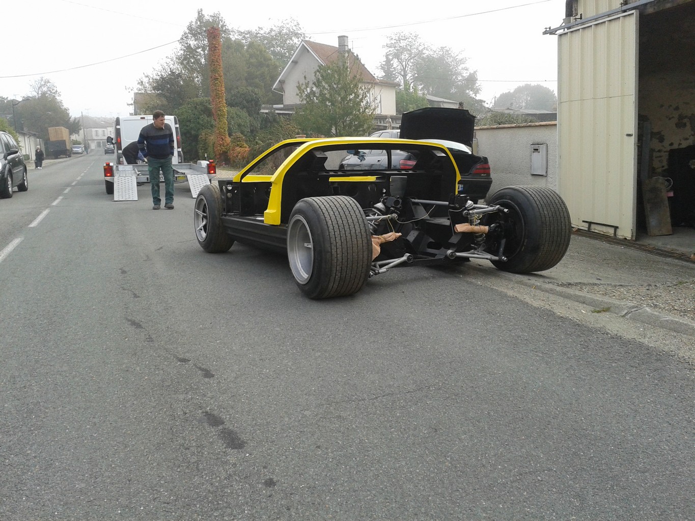

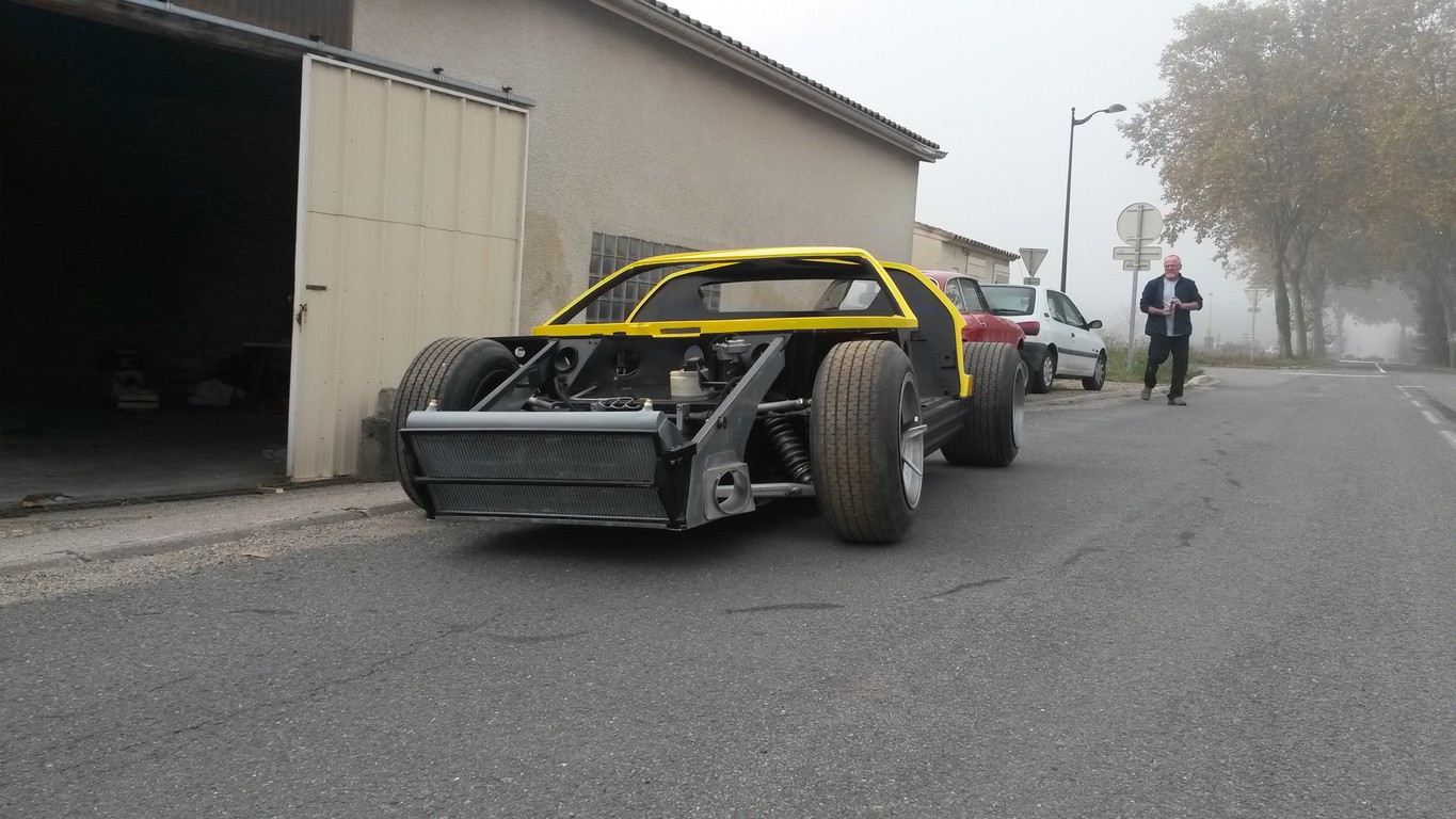

Hi all,
As my garage is definitively too small and dusty, few days ago, I decided to move the GT in a new facility, more adapted to the works still to be done. This workshop, as large as a cathedral, belongs to my friend Michel, who also built a GT40 out of a Marcadier kit (French light GT40 replica kit, normally fitted with a V6 PRV usually fitted), highly modified to handle some good V8 power. It is to mention that he also built the whole facility himself, alone from scratch ! See the pics to appreciate

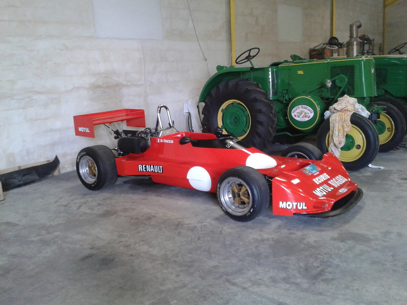

This new place is more adapted, more secured (there is some nice Fi and Formula Ford ex-Prost stored, among some classic farm tractors), and above all, well have here the heavy tools we need to put the engine and gearbox back in the car ASAP.

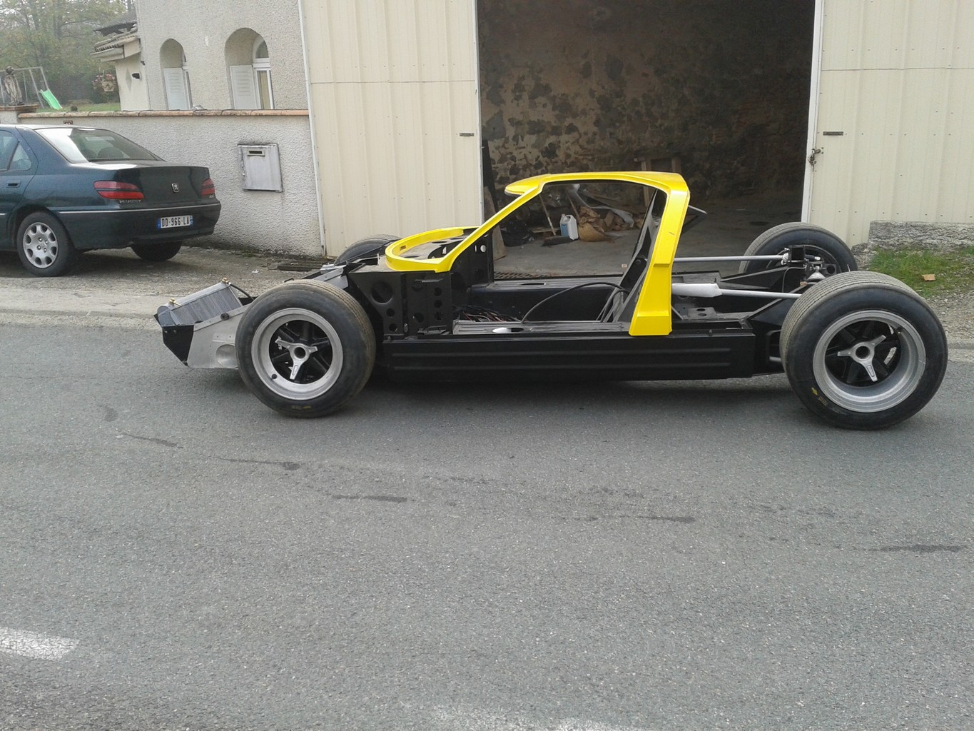

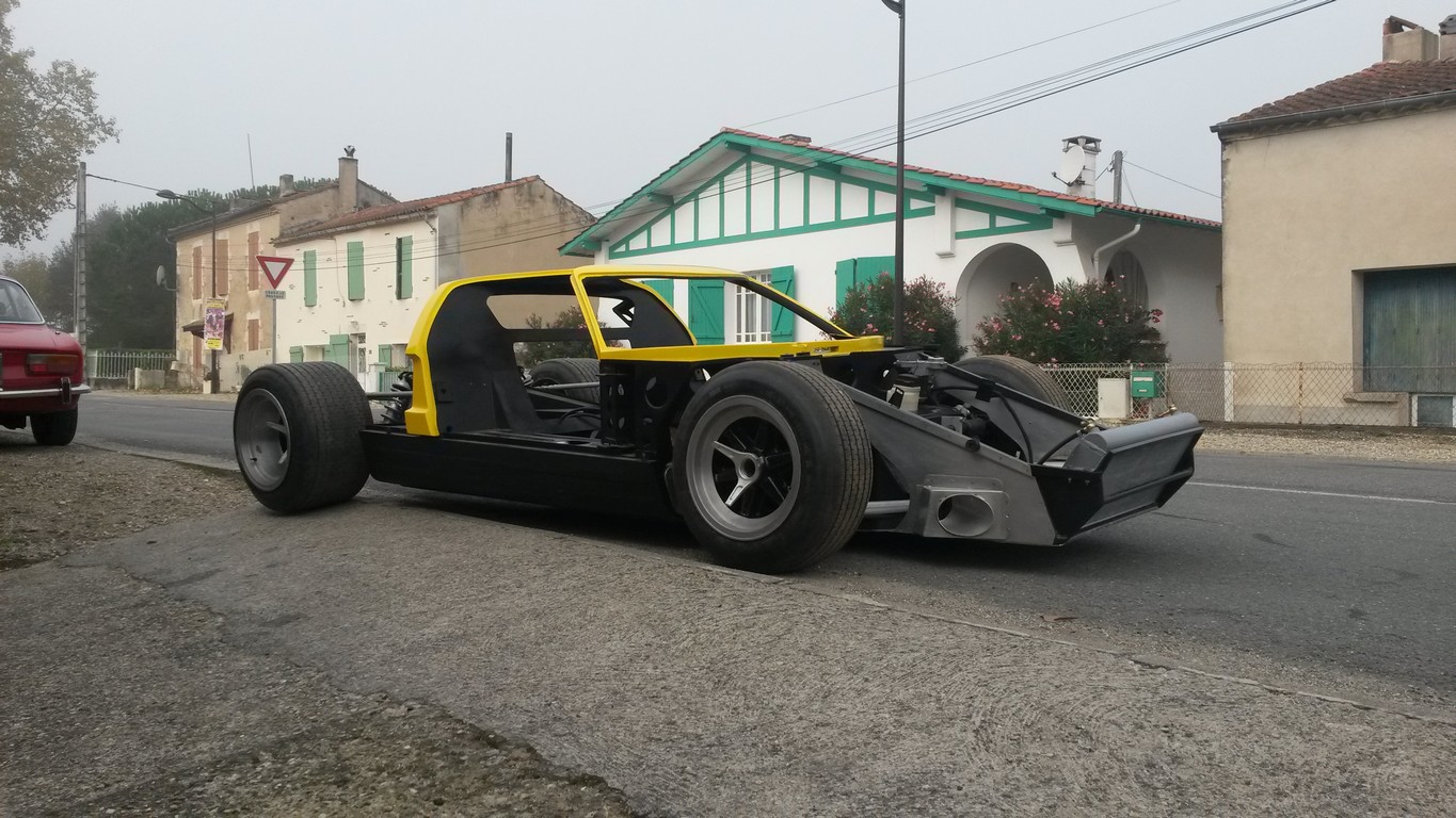

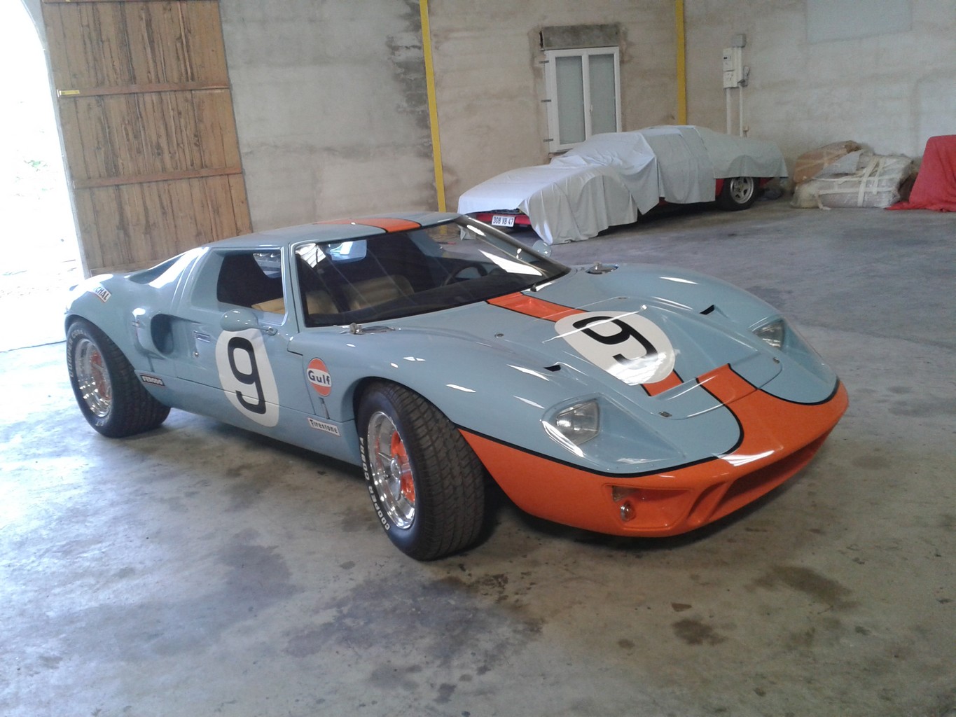

For now,at last after being 20years stored into parts in many boxes,the GT is back on its wheels!Isn't she lovery(forget about the wrong tires,only for built purpose).
I aslo modified the front hood into a single nostril shape,to be correct with a late version MKI I'm replicating,restored the dash,replacing gauges and lights in right place.(I was fortunate enough to dicover that few oh my gauges,among some orthers parts,were rare period original ones,adsolutely specific to GT40s).
I consider I've achieved the most difficult task,redone the brake lines,the engine mount,fabricated and machned the missing parts I couldn't get from the spécialized suppliers,and countless others parts modified,redone or restored.
I'm still fighting with the wiring loom,but I've good hope that on next spring,the GT will be on the road again,and hopefully back on some fast track.
I have to thanks my friends for their good support in that rebuild projet.I know well that F.Sbarro is some of controversial figure in the GT40 world,but I can testimony that,from a pure technical point of view,this car he produced is oh very high quality,perfectly well engineered.
For my part,and far from any controversy,as a simple gearhead guy,I have great pleasure to turn wrenches on such a car.Thanks to the people encouraging me on this thread,as I've had some hard moments of despair in the past.
I'm on the good way now,I can see the light at the end of the tunnel! in few months,she'II be roaring back again

Exciting stuff congrats. The tires appear to be undersized for the width of the rims?

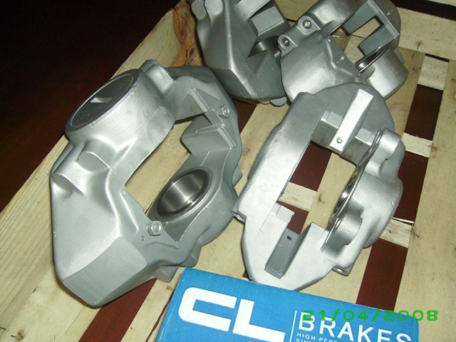

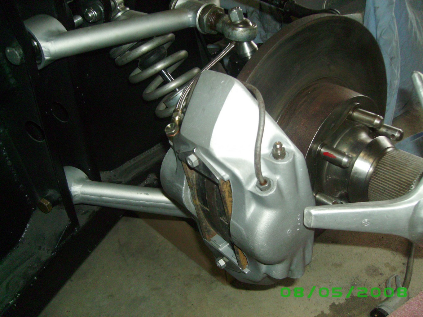

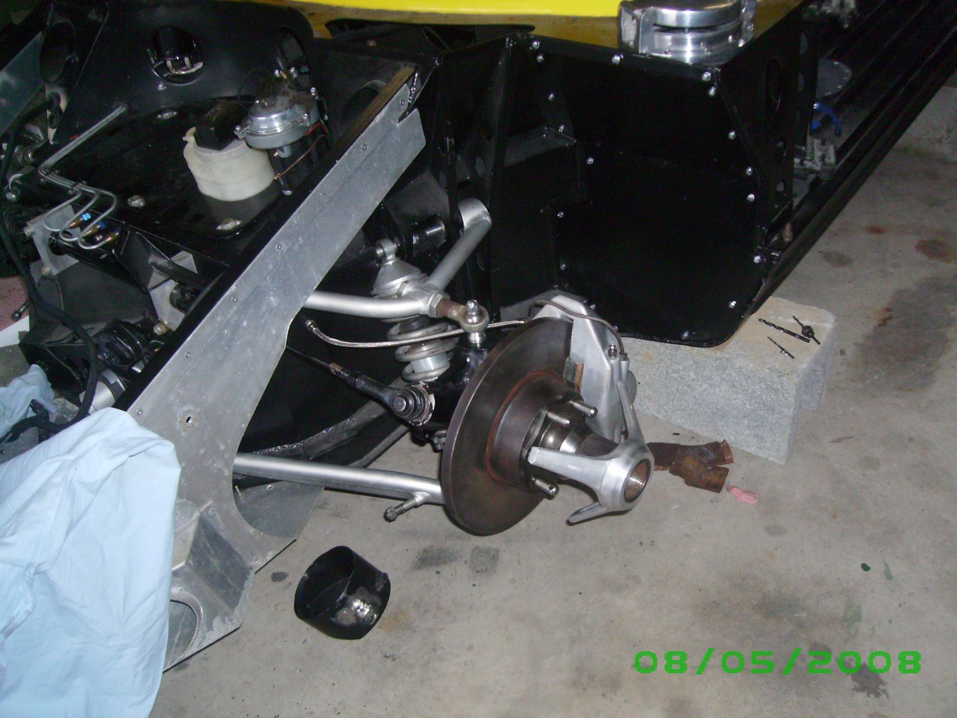

PL thank you for the pictures of girling calipers
A 289 FIA compliant motor costs a lot of money, especially the hard to find cylinder heads. Rebuilding this car made a hole in my bank account. But, later, if I get a chance, I will put back in a more original motor.
serge
I have to add that, with Serge we found evidences that the car was originally fitted with a real period correct GT40 289 engine, and we are sure it had initially a 4 bolts dash-1 ZF.
When Serge bought the car, engine and gearbox were missing. Now they are probably powering a splendid and expensive FIA compliant GT40 clone...
I know at least another Sbarro, which lost its original engine the same way...
Here are some photos, Girling front brake in place, the steering column as the lock doors are also in place.

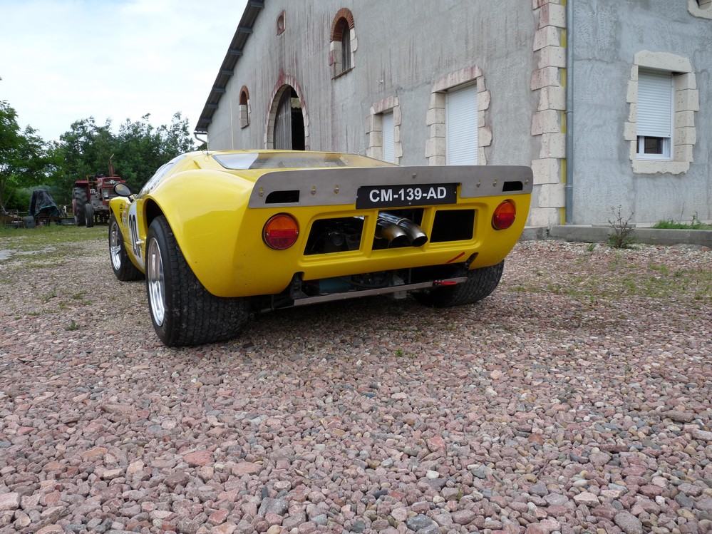

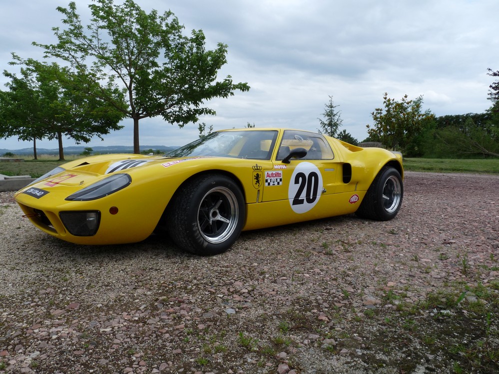

My Sbarro replica is finally finished, I have to make engine adjustments.
After 4 years of research work and discouragement parfoit what a pleasure to have done the first laps.
I made a copy of the 1079 I still have to do some mofification to be even closer to the originale.Je am thanked "Pilouleshublots" that my help and my much encouraged in difficiles.Je times attached a link to my complete restoration.
Cobra - Forum Cobra - GT40 - Shelby - Forum 427 Racing • Consulter le sujet - GT40 Sbarro
Thank you to all of you.
