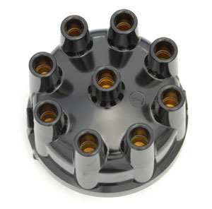

I am also getting the Autolite cap shown...

Also be sure the cap has brass contacts, later caps and some reproductioons have alloy contacts that don't hold up like brass.

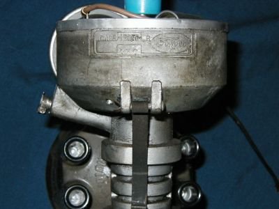

This distributor is good for a standard 1965 onwards Ford engine. But not a HiPo.
The original XF distributor racing core was based upon the 1964 1/2 Fomoco casting and made in a magnesium alloy. The original cap was either Fomoco or Autolite marked internally and with the number "1" cast on the top as an index and did not state "Autolite" or Fomoco externally for that matter. (see my photos or the early Mustang distributor shot below)
The bowl is different (more like a chalice) and the oil inlet is missing from 1965 onwards also tacho drive gear housing is missing.
Later cars used a chipped GT350 Ford regulator with the dual point distribution instead of the usual transistor kit if I am not mistaken.
Some guys reckon that I am anal about detail but there you go - for what it's worth.

Thanks James, the Autolite cap shown above has aluminium contacts and thanks to your info is incorrect, I have located brass contact caps and have ordered order one (brass contacts with a number 1).

The photo refers to the shape of the core with the oil feed as discussed and not the cap.
