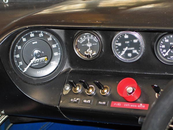

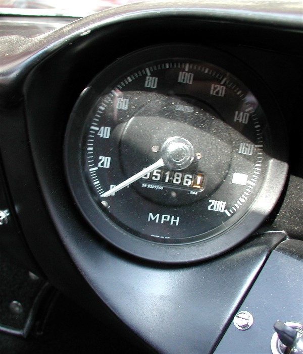

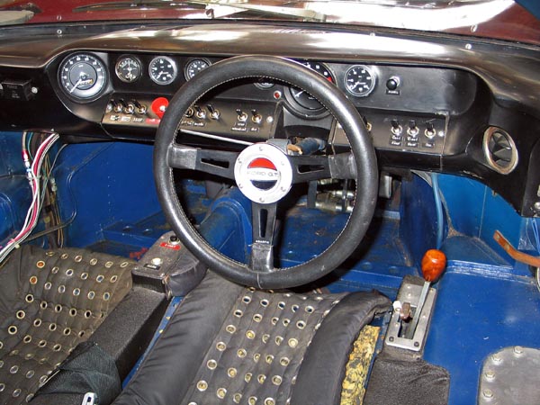

dash photos 1034 current
single fuel gauge swaps over depending on which pump is operating
so if LHS pump operating it shows contents of LHS tank

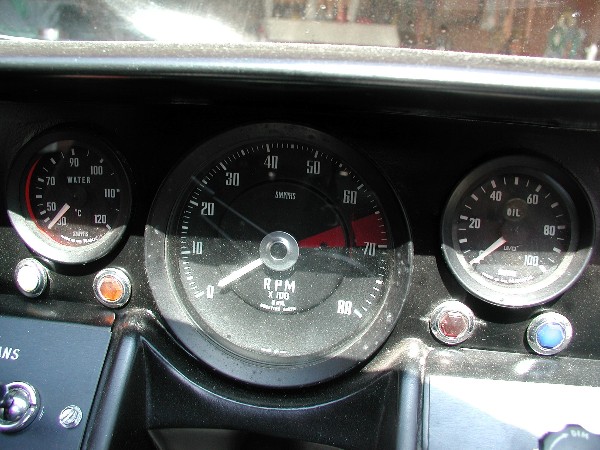

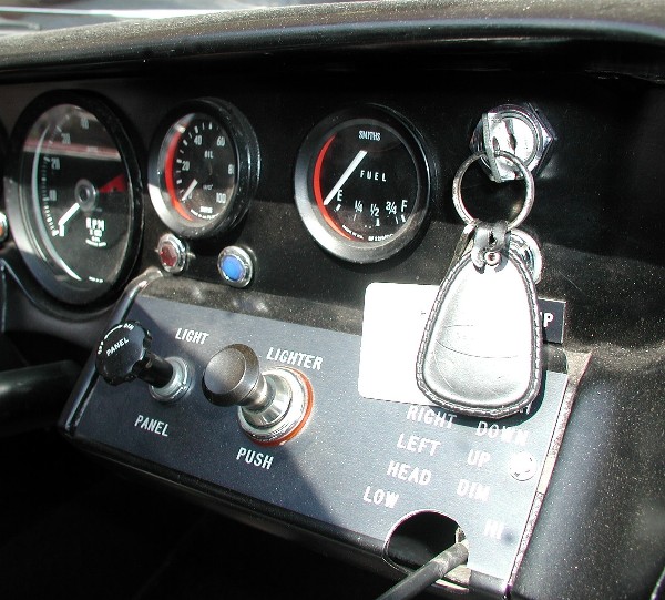

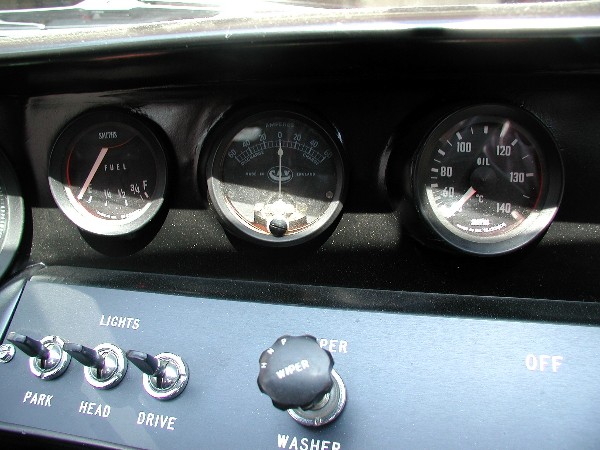

dash photos 1063 road car with LH and RH fuel gauge .
Road cars only had one SW 240 A pump
lever on RHS to operate indicator and hi or low beam is BMC mini , with push button on end for horn or brake lamp

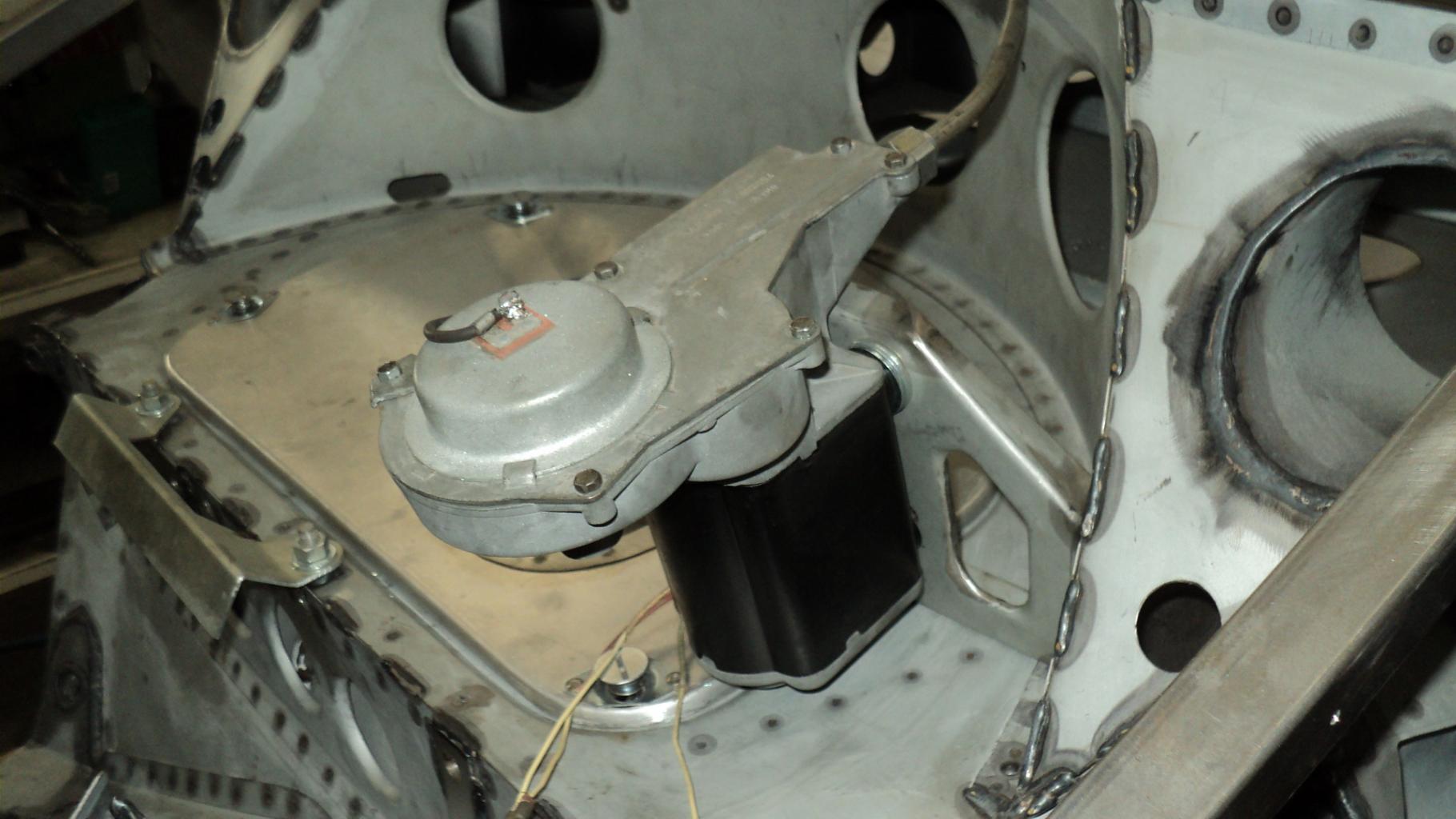

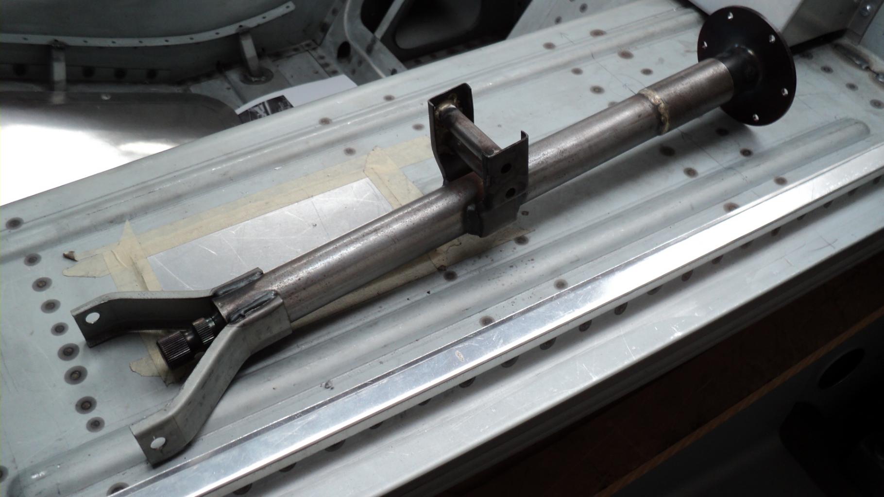

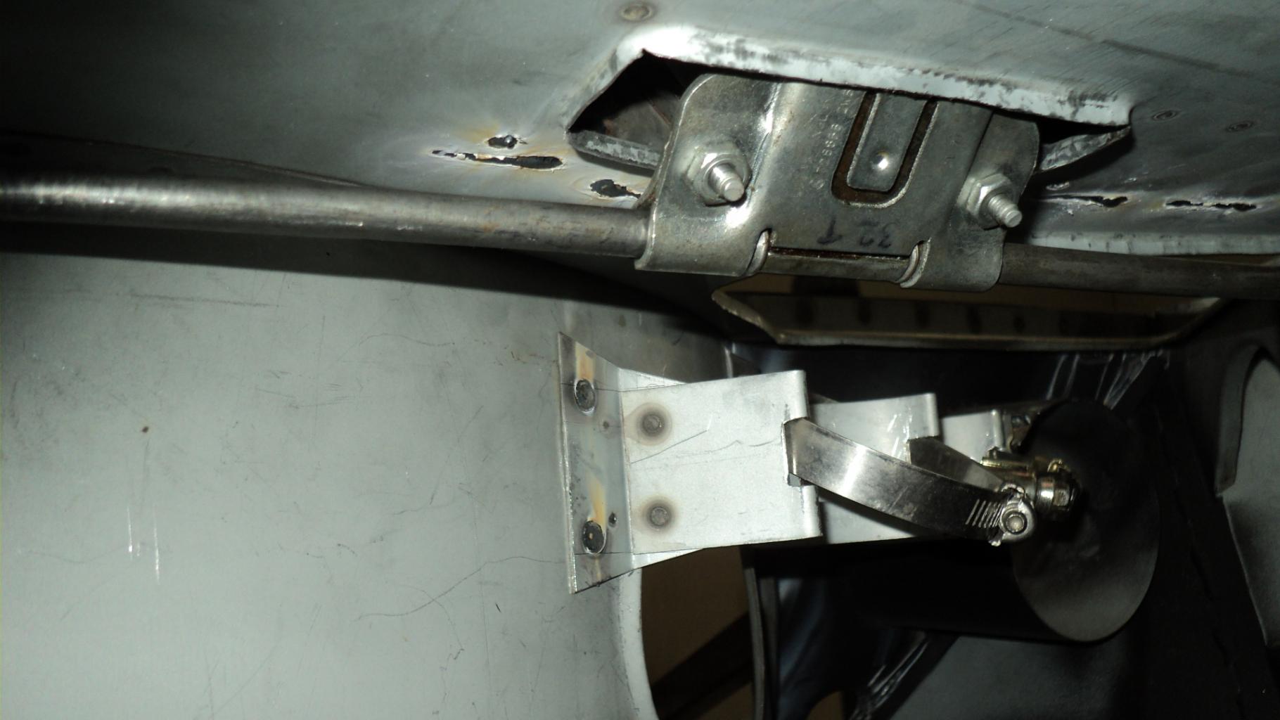

Trevor.. thank you for the photographs, which are of great interest. Here are some photographs, showing the wiper set up in P/1042. Regards... Andrew

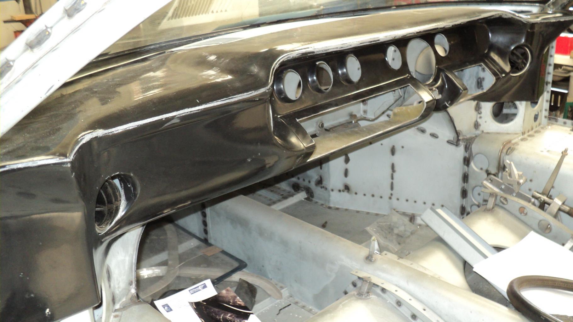

Sorry, it's been a while, but to continue the story... here are the latest photographs from the restorer, showing the dashboard in place... exciting times! Also pictured, and for those not keeping up with the story... are a couple of photographs of the Martini International Trophy, which took place at Silverstone in 1967. GT40P/1001 failed to finish the race with Hulme at the wheel, but my steering wheel (off GT40P/1026), won the trophy! It placed 2nd overall, in the hands (literally) of Mike Salmon.. see previous pages for images of the wheel. Thanks to everyone for your messages of encouragement. Andrew
