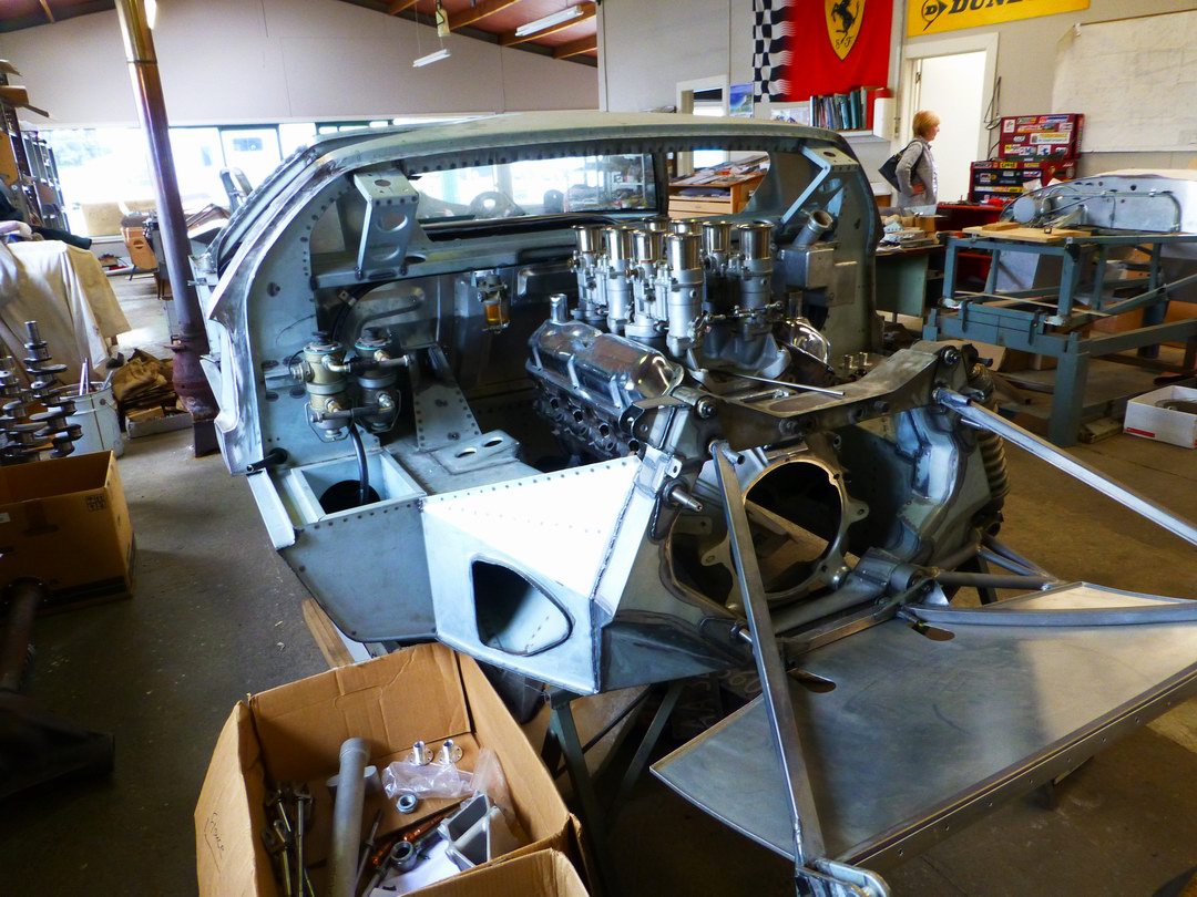

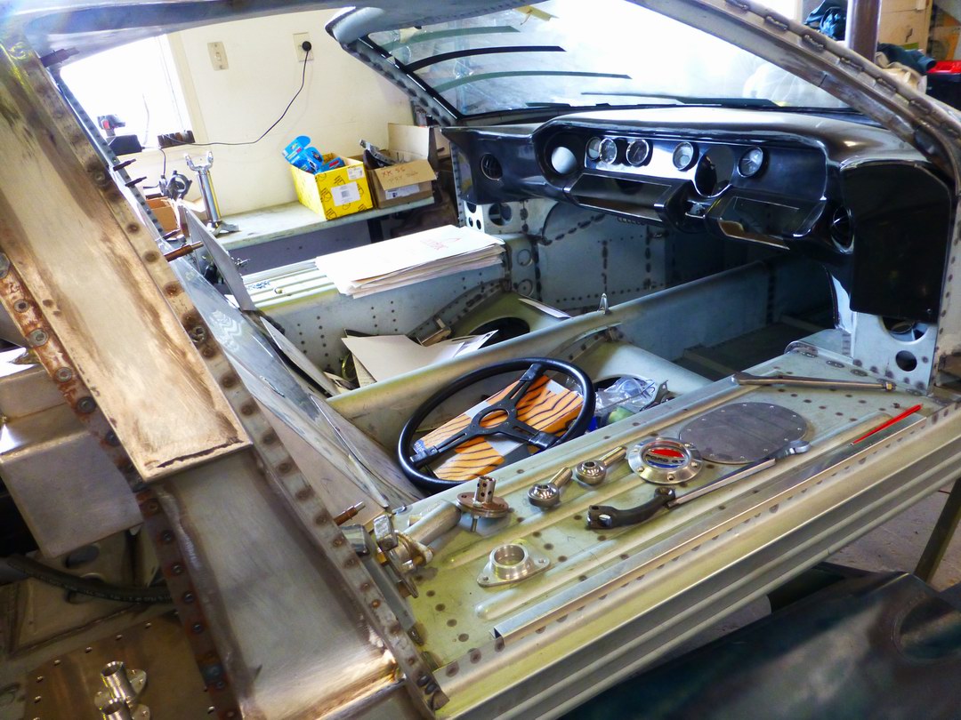

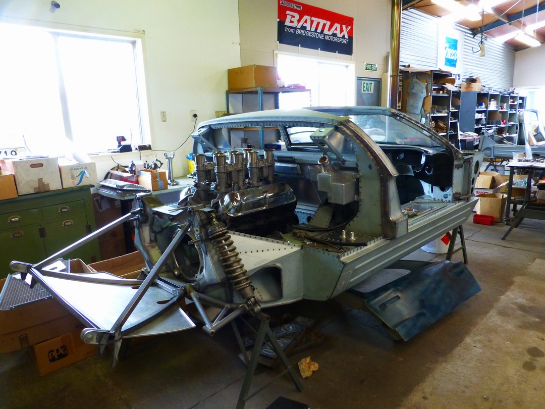

Some photographs taken when a friend visited New Zealand back in March. Some of the chassis is period original, although most of it is new.

Dave makes an awsome chassis.
I wouldnt have bothered putting a period part in, it makes no diffence at the end of the day it will be painted anyway.
What part did they reuse.
Brown and Glescoe I think its called (jimmy macs chassis)and John Shands would be the most authentic I would say.
You living in Britain how come the Glescoe was not the choice due to location, transportation ect ect.
The coin dosnt seem to be an issue with the project so what was your decission breaker on that.
Fantastic.
Jim
Sorry Jim, but this is where you just don't get what I'm trying to achieve. If I wanted it to look brand new, then everything would have been brand new. If I wanted to make it more useable, then I'd have used modern parts out of a Toyota etc and then I might as well gone all the way and bought a modern kit with far less headaches.... Andrew
