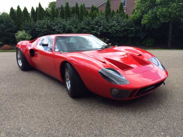

So close. About 10ft from my garage. Got it that far, but currently not running. Eating main 80AMP fuses, so need to do some diagnostic work. A few bugs to work out, but nothing unexpected.
A little warm in the cabin. Anyone want to help me decipher the 3 AC controls in the door...and how they relate to the fan dial switch on the dash?
- Jeffrey

Dang that thing looks good in the driveway.
Thanks!
- Jeff
