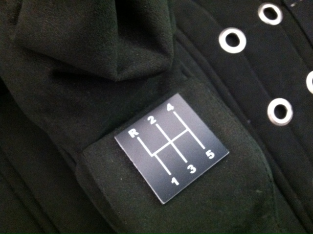

Ok, I really am a newbie idiot. I've been complaining that the shift linkage is a bit of a mess. Well, last night I figured out half the problem. Me. It definitely helps to know R,2,4 are up and 1,3,5 are down. Yep, go ahead and laugh at me - I deserve it.
I have not driven it much, but I was not especially happy with what I felt were too high of revs at freeway speeds. At 80MPH (indicated) I was at 3000RPM in what I thought was 5th (up to the right). Well, of course that was 4th. Finding 5th down and to the right certainly transformed my freeway experience.
The linkage obviously works much better knowing where the gears are. I still struggle a bit to find 5th - but have only driven it once knowing where the gear actually was. The Olthoff linkage upgrade should really be able to address some of the remaining vagueness in shifting (now that I've fixed the biggest problem - me).

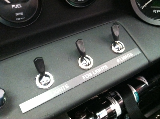

I have the upgraded Olthoff shift linkage and it really does help. You might also ask Dennis if he has a set of dash labels for your switches. They are engraved black plastic and they look nice. His set also includes a label that goes next to the shifter so anyone else who may drive your car in the future will know where the gears are located.
