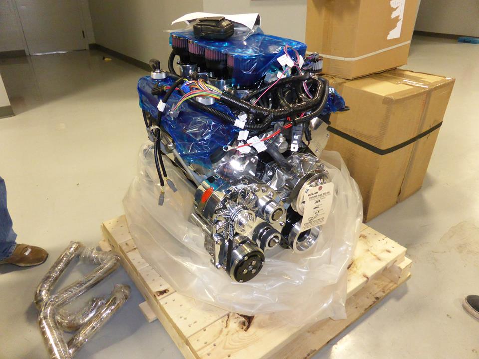

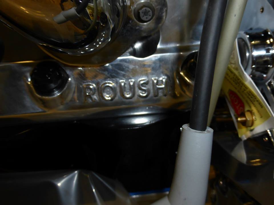

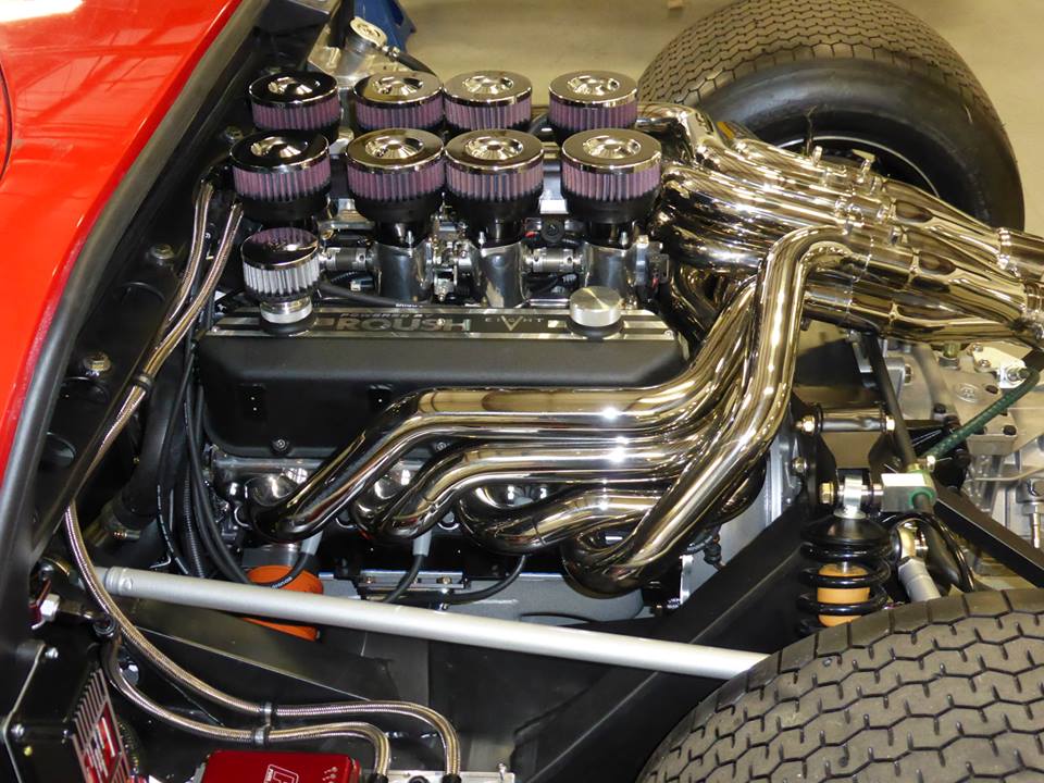

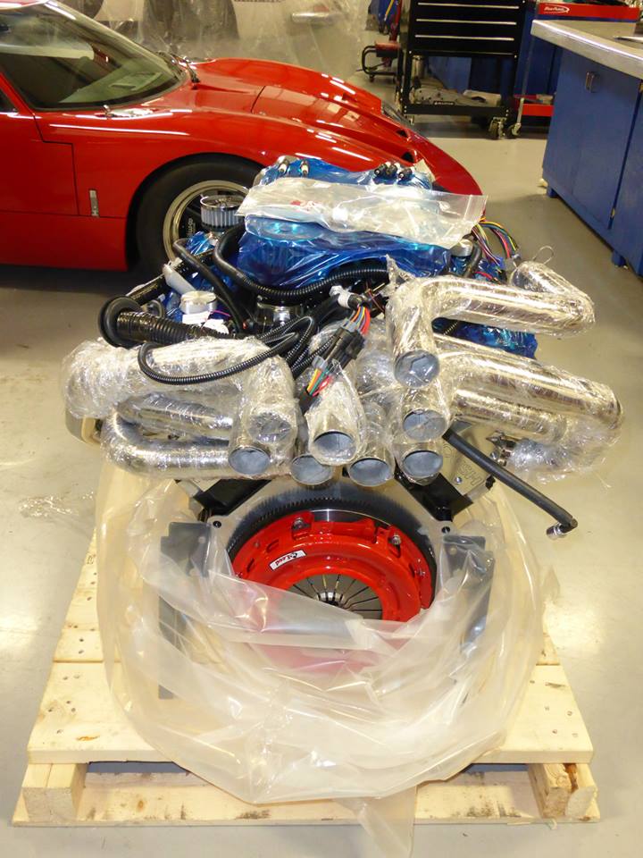

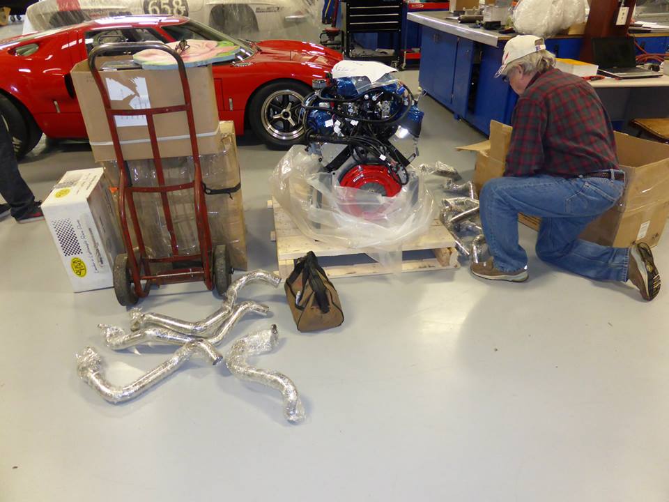

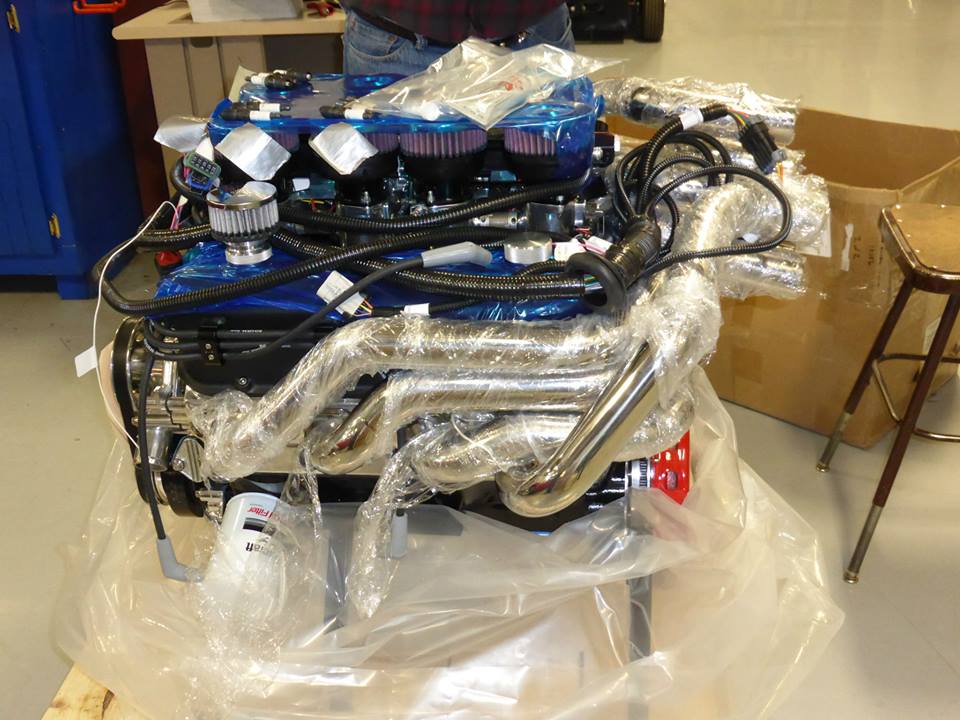

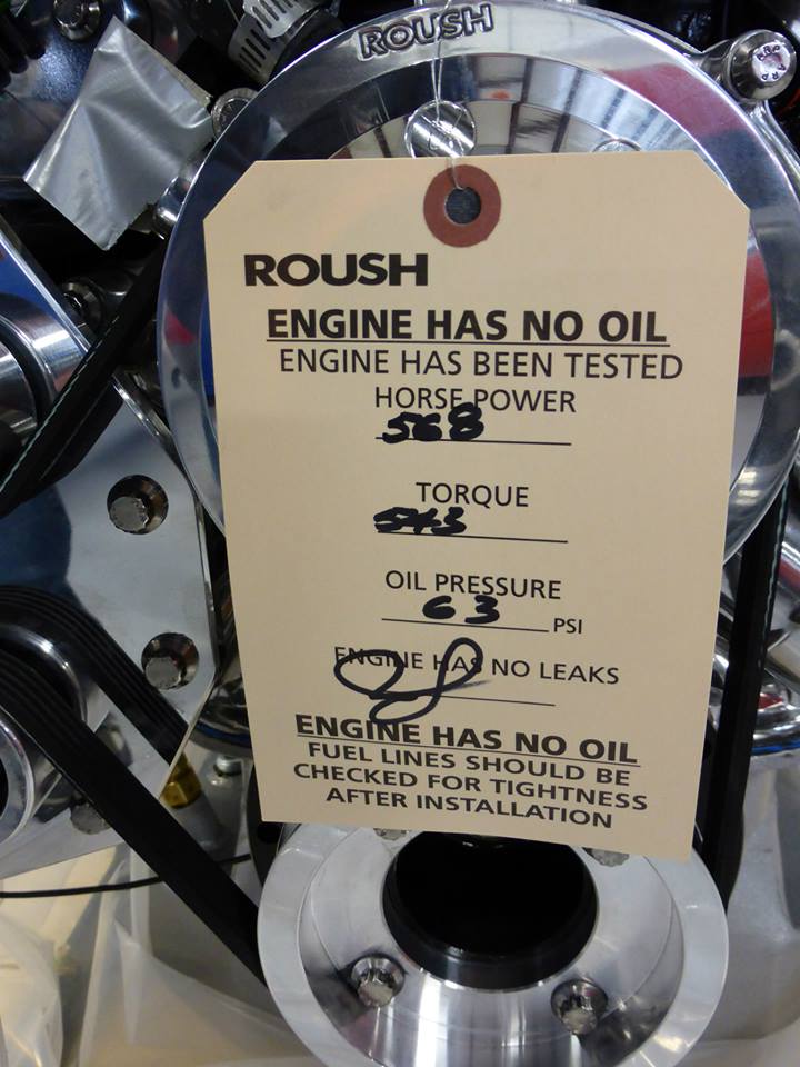

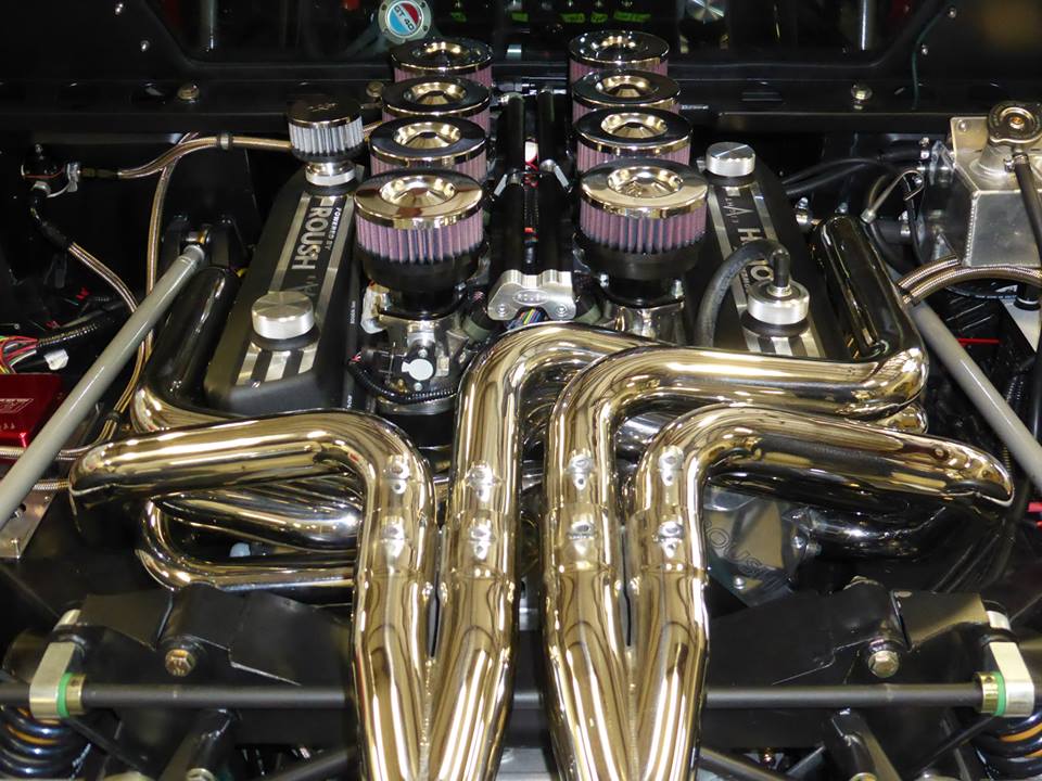

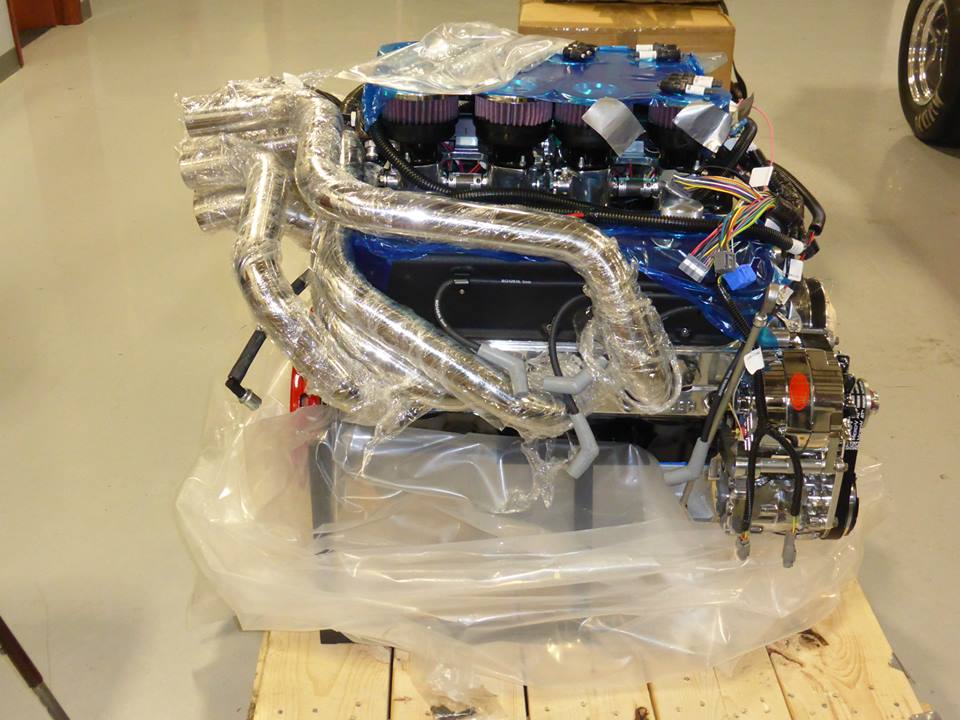

Test fitting Firefly Performance stainless steel headers to the Roush 427 IR.
- Jeffrey

Awesome car Jeff, but the finish on the engine blows me away! It should be on public display until it goes in the car! I'm with Jimmy P on the patina thing, if you use the car it is impossible to avoid stone chips and patina will develop. I noticed at least three marks I picked up from my trip to Goodwood, and they were not in the places you would expect to get them, but - worn with pride!
I look forward to seeing the finished car and your driving impressions.

I did not want to strip the packaging off the engine while it's sitting in the shop awaiting install, but I will get some better photos of the engine in a week or so.
As for the too much horsepower thing...after extensive consultation with Superformance and a few others, I believe the Roush 427 IR offers relatively acceptable streetability and reliability for it's horsepower rating. Of course there is still plenty on tap if one desires a little silliness. I do however expect this to be a little bit more of a challenge to drive than my E350 4Matic Wagon.

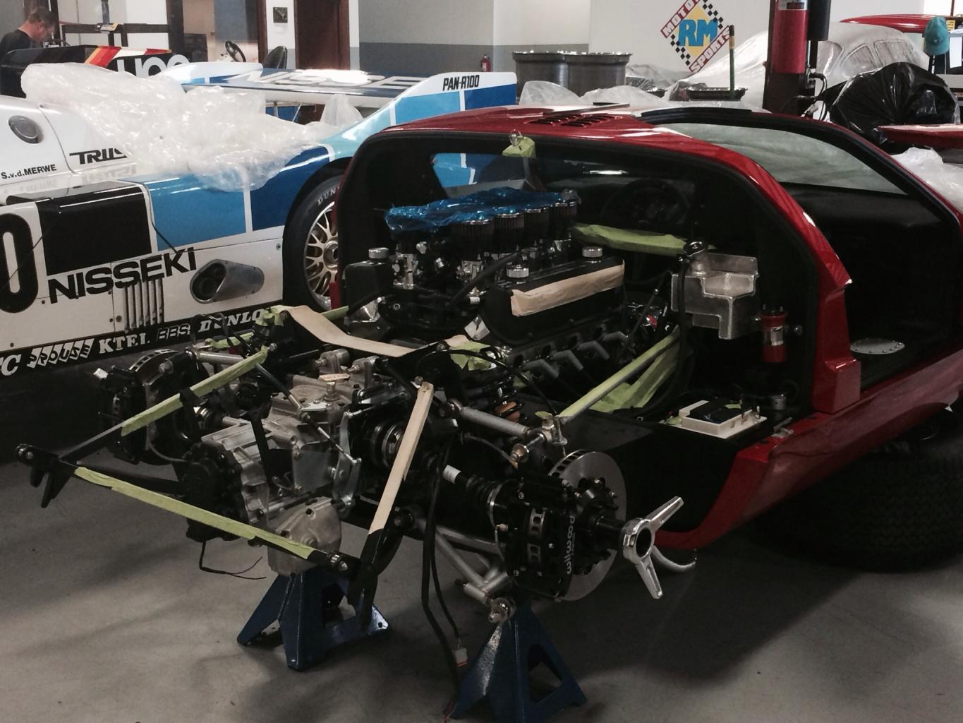

RM Motorsports does not mess around. The delays to date were just waiting for the RBT. RM is on it. The number of tweaks and improvements they've made along the way certainly have made me thrilled with my choice of installer. Attention to detail is stunning. Every line, every bolt, everything - done to a degree of perfection beyond my knowledge and ability to have even asked. Things I just never would have noticed have been raised to an incredible level of perfection. They have a list of about 15 things they slightly reworked or addressed to improve on what was delivered.
I'm not sure how it will be possible, but they tell me I will have it for the 4th of July weekend.
- Jeffrey
The car looks fantastic. Consider putting some sheathing over the upper shift cable to shei;d it from header heat. Are you running the stock Girling reservoirs?
Thanks for the tip on shift cable shielding. I would think yes they left the stock Girling reservoirs, but I'll have to check. What is your thought there?
Thanks for the tips.
- Jeffrey
Jeff, here is some heat shielding. Those headers get warm.
https://www.pegasusautoracing.com/productdetails.asp?RecID=6520
Regarding the reservoirs, some including myself found them to be leaky and create messes with brake fluid running down the side of the chassis. I replaced them with the Tilton reservoir. I would encourage you address it now before you have to clean up the mess the Girlings create. My 2 cents...
http://www.gt40s.com/forum/superformance-gt40s/37706-brake-reservoir-update.html
Dave, thanks for the tip. How are your spark plug wires routed? Mine go down and back - away from the headers, so not sure I'll have a problem. RM Motorsports did a fair amount of rerouting things to clean things up. For example, the fuel rail is normally supplied from the back. RM switched it around so the supply comes from the front and only has to neatly cross the bulkhead. They did a lot of interesting things...like shortening up the AC hoses, etc. An incredibly clean install. Nothing out of place, all cables and such routed for maximum efficiency and clean look.
Mike, thanks for the tip on the shifter cable. Added that to the list today. Along with shielding over the headers to protect the rear clip. Stone deflecting material going in the tops of the inner wheel wells. Mirrors very similar to yours, except black. I may throw an accent color on them in the future - as I've said before, I really like your mirrors.
