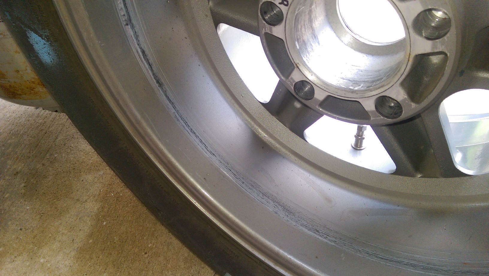

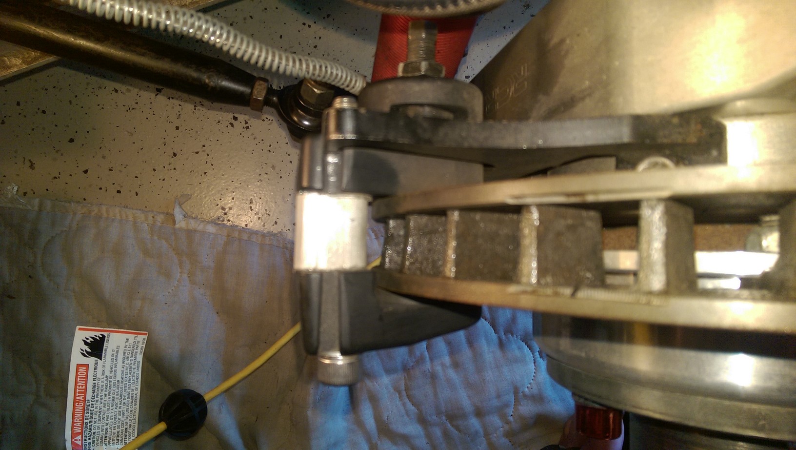

That was just before Irma swept through, so finally had a chance this weekend to start troubleshooting the drivetrain. Pulled the rear wheels and immediately discovered that the Willwood park brake calipers were both dragging on the inboard surface of the wheels. They appear to have been installed and adjusted correctly by the PO, but clearly do not maintain adequate wheel clearance with the standard RCR40 BRM style 15"x10" Vintage Wheels. Have any of you with this configuration seen this occur before? Forum search didn't turn anything up related to this problem.

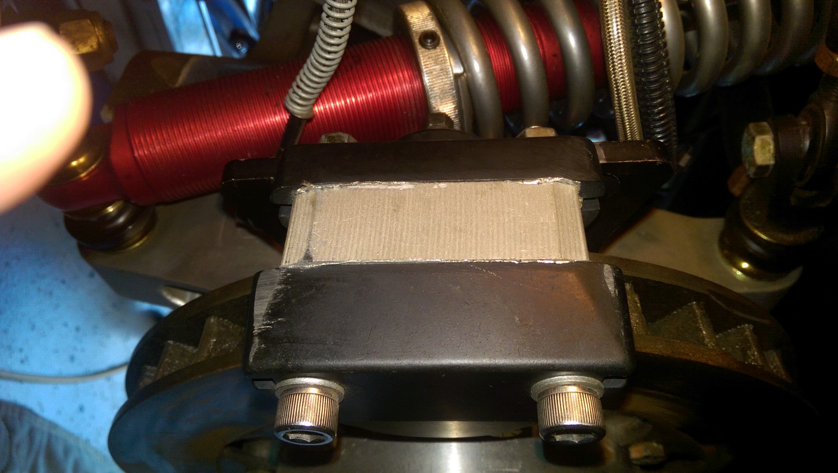

I've removed the calipers for now, planning to road test it again later this week to see how it drives without them. Not sure what I can do to alleviate the interference short of removing material from the calipers or moving to 17" wheels. The calipers have a fair amount of float in the brackets, so I may have to remove quite a bit of material to account for that.
Mike I believe Don had the same problems on his RCR MK-4, check his build thread. I think he had clearance problems as well and solved it with a small amount of material removal........................m
Thanks mahlon, found a reference to the same issue on page 5 (post #83) of Don's initial build thread. Thanks for pointing me to it, guess I'll be removing material from the calipers as Don has done.

I had the same issue on a RCR40 that I built for a customer a year or so ago. I contacted
Fran and he made me a set of replacement brackets which moved the caliper in 3/16" . Worked like a charm.
Ron
Ron,
Thought of doing that mod myself, perhaps I'll give it a try. If I screw it up, I'll reach out to Fran. Thanks for responding and providing a dimension I can shoot for.

Unfortunately, these cars can't be slapped together, you have to check for adequate clearances (hot or cold), and worst case scenarios. You now have a telltale mark on your parking calipers which you can clean up and file down to get the adequate clearance going forward. also, swap your rear wheels L to R and check your clearances again as they can vary.
While we're on the rear brake assembly area, check that your caliper is centered over the brake rotor. The mounting bracket may set the caliper alignment to be off-center slightly, which is OK unless you allow your pads to wear down far enough.... If so, add it to your list of inspection items or see if Fran has another bracket that's machined to fix this.

Chuck, thx for posting the link to your build log, definitely the same condition I've encountered. Curious to know why you ultimately removed the calipers, did they continue to contact the wheel after removing the material?

I removed it for a number of reasons. First it was not really that effective in stopping the car. Second, putting it in gear keeps the car in place when parked 99% of the time. If in doubt, I just put a wheel chock in place. Third, it cleaned up the interior by eliminating that lever on the center section.
It was needed to pass the registration inspection. After that . . . . . . .

I still have the calipers fitted but your are right Chuck the parking brake is not effective. One reason being that there is no balance bar at the lever cable end to evenly distribute the load on the pads.

If there's not enough clearance there are some other options for a working parking brake....everything from hydraulic lock to slimmer parking brake caliper (Wilwood makes several types). You'll get it sorted.
