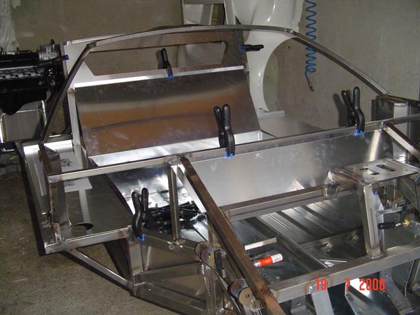

Here a Swedish GOX 40.
Mattias
Mark IV had hanging pedals as well, the space for spare tyre in originals dictated floor mount. Easy brake bias adjustment is reason for two cylinders.
