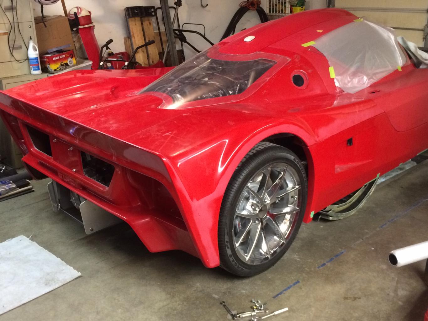

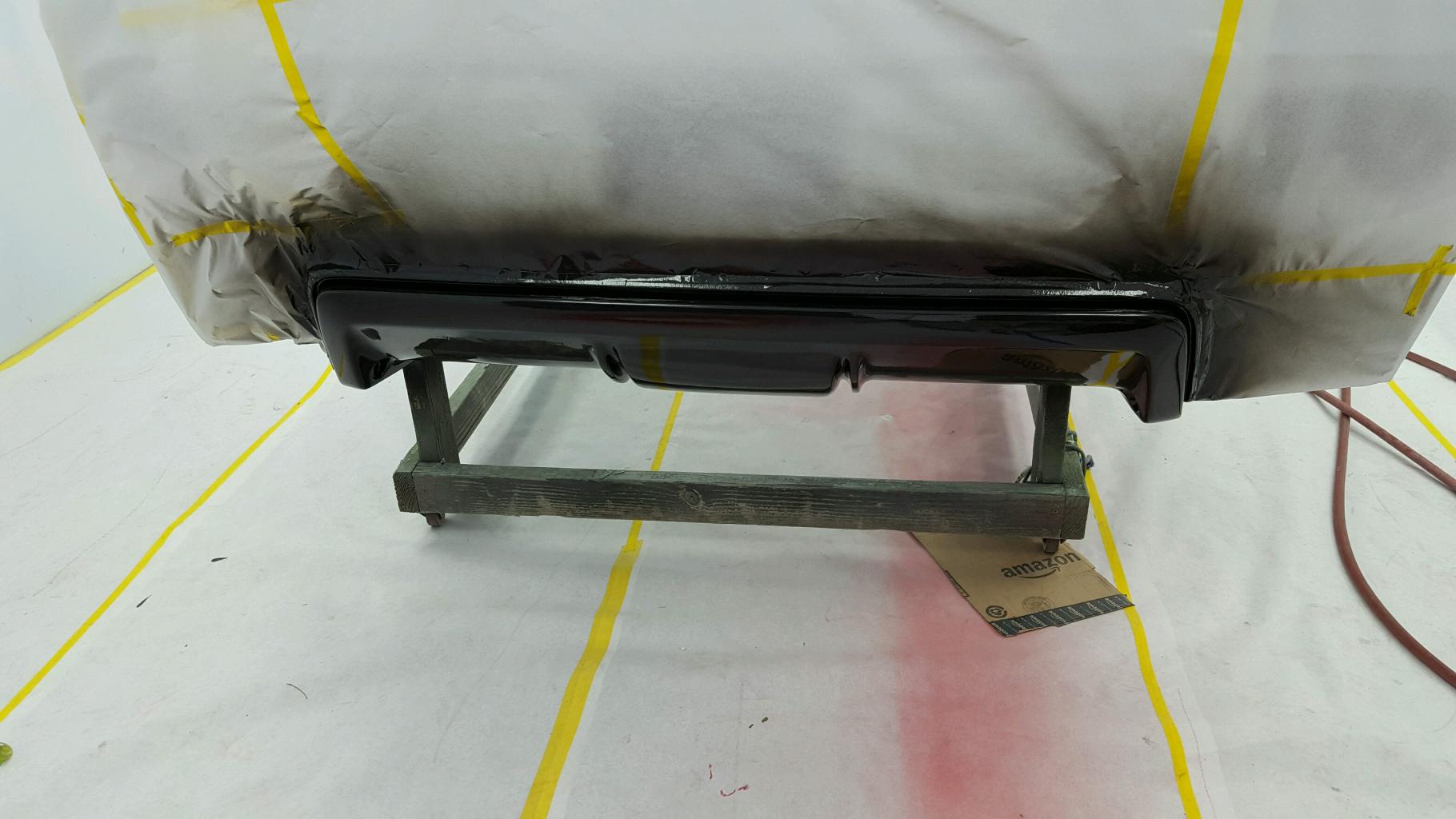

Back end of the Graz looks much better now:
Heat gun made removing the black crap much easier.
