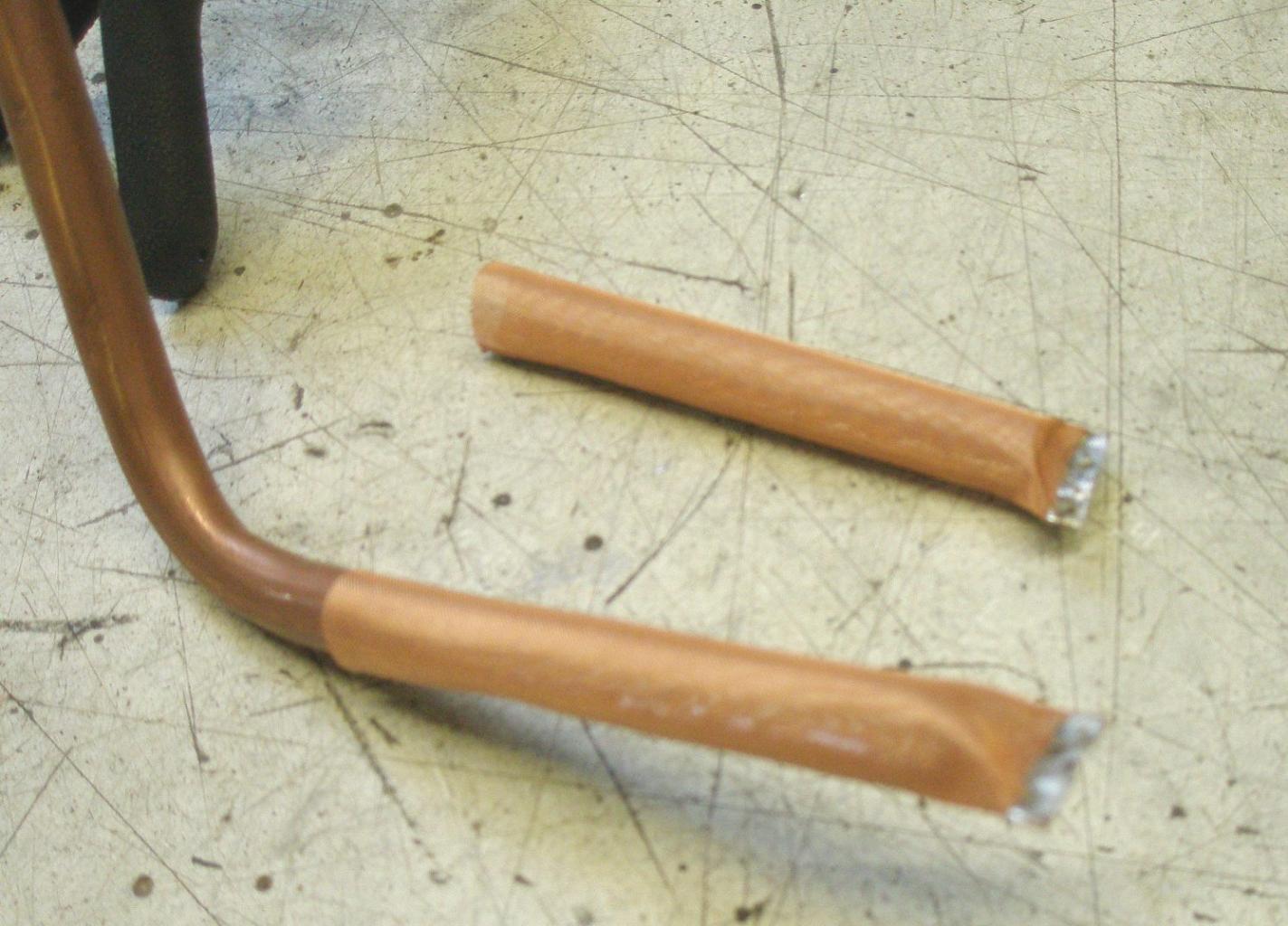

I’ve also based my fuel system on a Pollack valve to switch between the tanks, however I’m also concerned about the valve jamming, as you folks are now finding out. I suspect that failure mode is debris been drawn into the valve and jamming the shuttle valve. <?xml:namespace prefix = o ns = "urn:schemas-microsoft-com<img src=" /><o:p></o:p>
As I’ve got the Pollack valve between the tank and the LP pump, I’ve added pre-filters on the pick-up pipes made from a very fine copper woven mesh with only a .014” openings. These were soldered onto the pick-up pipes to give a ‘fit & forget’ solution and should stop any swarf or debris getting into the system and jamming the valve.<o:p></o:p>
<o:p></o:p>
Regards<o:p></o:p>
Andy<o:p></o:p>

Ian,
it sounds like the valve is jamming when under load. It may be worth trying switching the valve before the pump is running
Rgds,
Andy
