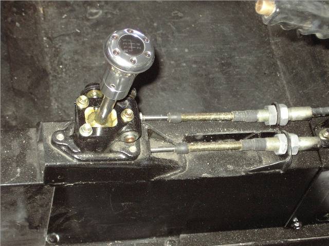

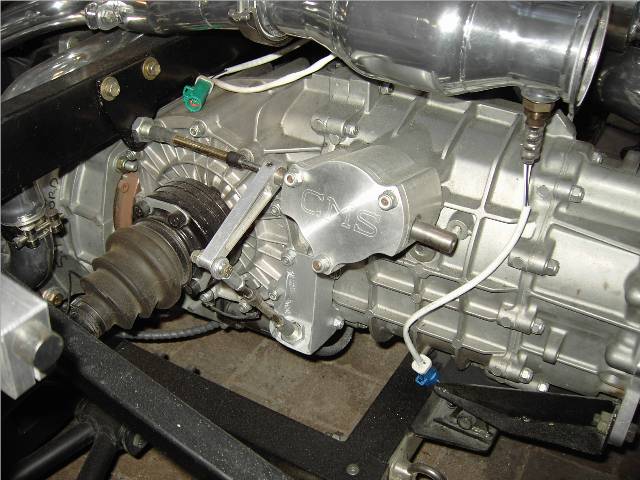

Hi Fred
You might want to consider the side shift conversion by California Motor Sports which reduces the length of the gearbox and uses 2 morse cables which makes the routing of the cables much easier and does away with the solid linkages.
The all cable shift is very precise as there is no issues with linkage slap developing via all the bearings and belcranks.
You can then run the cables in any direction around all obstacles and you dont' need to worry about the complicated rods and levers.
I have detailed photos of the cable setup in my build thread as this was the system I have in my car and it works extremely well.
Dimi
