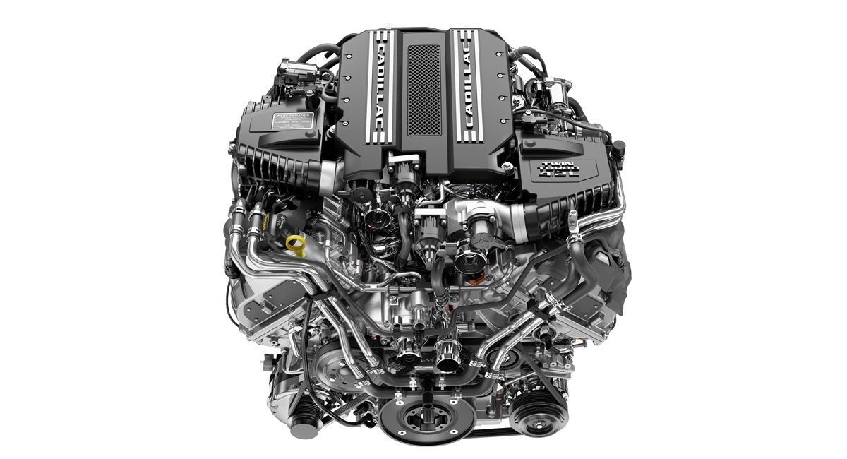

A New engine from Cadillac: the Blackwing.
Cadillac Blackwing Engine
"The Cadillac Blackwing engine is an internal combustion engine developed by General Motors for Cadillac luxury automobiles.
http://gmauthority.com/blog/gm/cadillac/cadillac-engines/cadillac-blackwing-engine/
"The current Blackwing engine is the 4.2 liter V8. Assigned GM RPO code LTA, the eight-cylinder, Dual-Overhead Cam (DOHC) gasoline engine is the result of a new clean-sheet design. It’s also Cadillac’s first-ever twin-turbo V-8 engine. The Blackwing first launched on the 2019 Cadillac CT6.
"The Cadillac Blackwing engine (LTA) is a clean-sheet design that was developed with the goal of delivering exceptional power density. It also introduces various unique design elements developed to balance performance and efficiency with compact, mass-efficient packaging."
