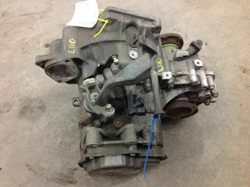

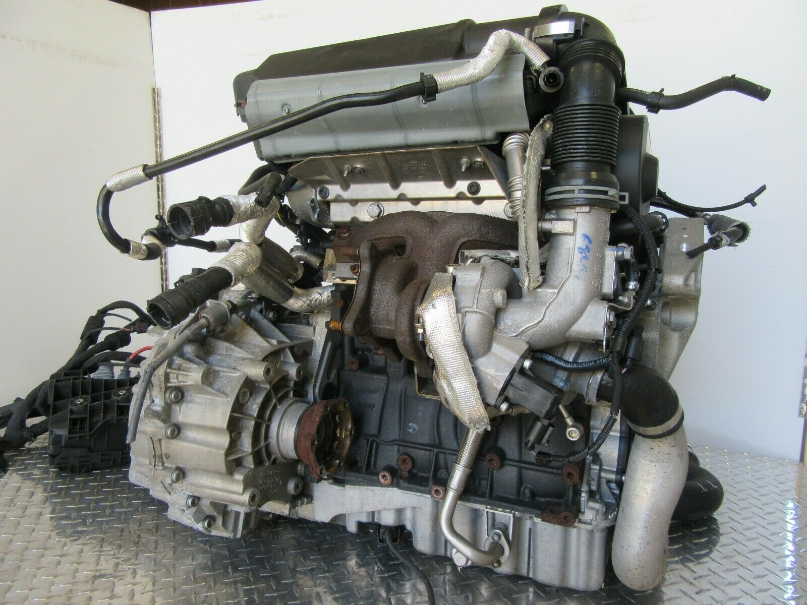

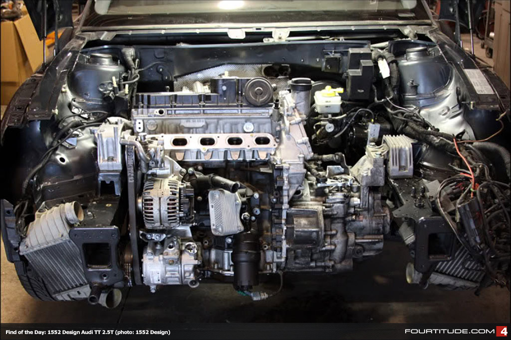

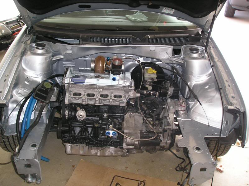

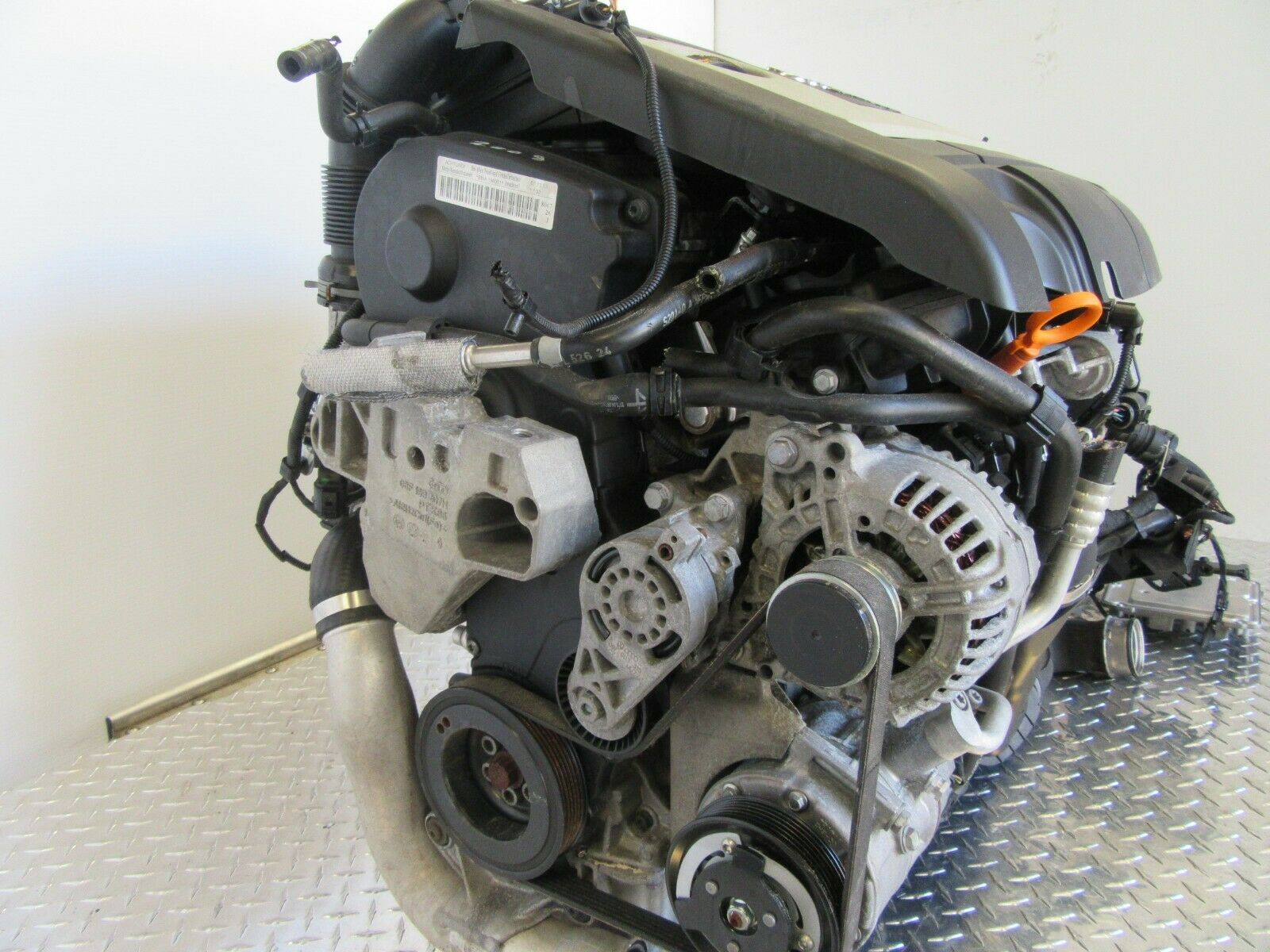

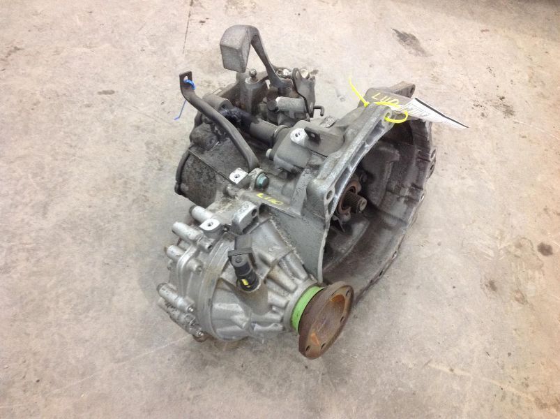

The original first "SLC" type of idea that Fran had was a transverse arrangement. Way back when I even talked to him about a complete Audi 1.8T TT package kind of setup. The weight distribution would have been near perfect with the engine in sideways and the gearbox located right behind it. I think the total package for a 2ish litter 4 banger transverse gearbox would be near 200 pounds lighter than a LS/ 6 speed transaxle. A foot or more less in length also. This would reduce the overall mass of the car as well and maybe we could get down to that magical 1 ton weight target.
Generally here is what the engine and gearbox would look like. The head is crossflow so in amid engine layout the hot parts, header, turbo and exhaust would be behind the engine and the intake track in front against the firewall.
But in the end you have to sell them and most people who want to build one of these kind of car wants a V8 or better.

Les, what I was referring to with the " in the end you have to be able to sell them" was that the original SLC concept that envisioned using a transverse front engine type engine /gearbox package mounted in the mid engine location. As far as I know Fran built one as a proof of concept but never really pursued the design. He and I had discussed it using a Audi A4 power train back then as well as a Acura system as well. That had to be more than 15 years ago I would think.
He changed focus and the current SLC is the result. I think you will agree that everyone benefited from that with what, a couple of hundred sold? If Fran has done one thing he has produced products that customers want to buy and at a price point that makes that possible. Good ol American capitalism is alive and well in Detroit.
A high output 4 banger and max attention to weight saving would be a very interesting track car design if it saved 200-300 or more pounds from a V8 (same power) version. But in the end of the mental exercise I had on the subject I concluded that a big torque V8 would be easier to drive on a track for most of us fat old men. I know I was right as far as my car went on this one. By the way I have a 450HP 5 speed SLC on ZO6 size Hoosiers that I believe will forever be faster that I can drive it for what it's worth.
