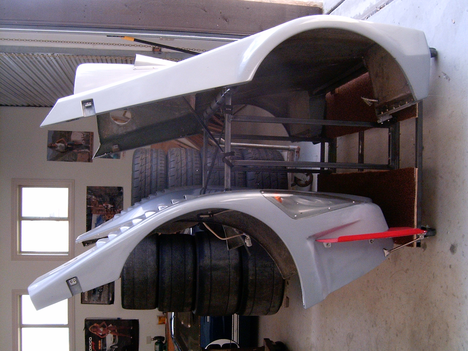

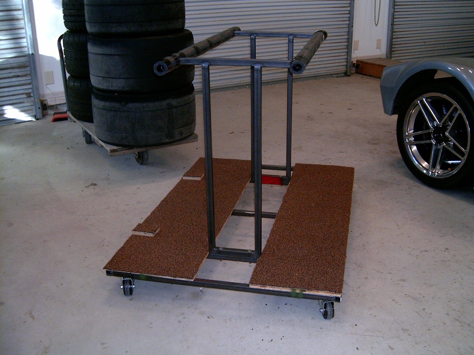

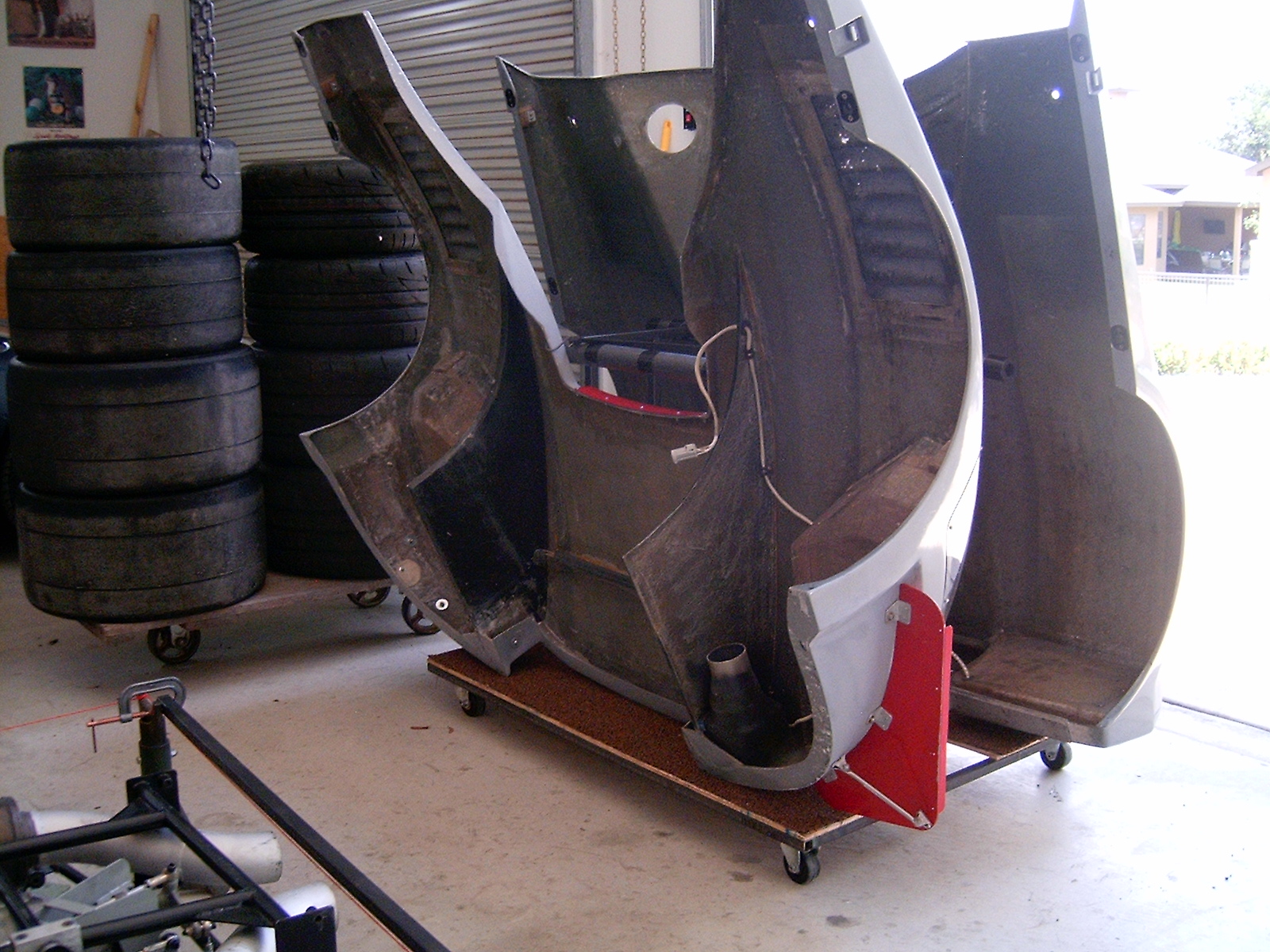

How about something like this. You could make it out of wood and really low-cost casters pretty cheaply.

That looks good, bow does it affect teh body shape during the remaining cure time? I know a few people here have said that the parts fit better resting on a buck in "correct" form.

Hum..........cure time...............That I can't really tell ya. My first thought is however that the piece you want to remain unaltered would be the center spider because of the windshield opening being so critical. But you won't know what shape everything needs to be until you fit the pieces to the chassis centered on the wheels and tires and locate the doors and windshield. So Really I would leave the fiberglass on the chassis for a few months and work around the on and off hassle if I was worried about the fiberglass getting misshapen.
I use my rack all the time when I intend to work on the car to any real extent, The rear, more often than the front I would guess. I have never removed the center section once it was painted. But then my car has been "completed" for a very long time. This would be a good question for the forum. How long does the fiberglass body take to finish hardening? And is it an issue how you store it until it does?
Note: Be sure you fit the windshield before you finalize the body part's location on the chassis. And be sure to set up the suspension before you do that. The windshield can not be formed to fit the spyder................ ANY!!!!
