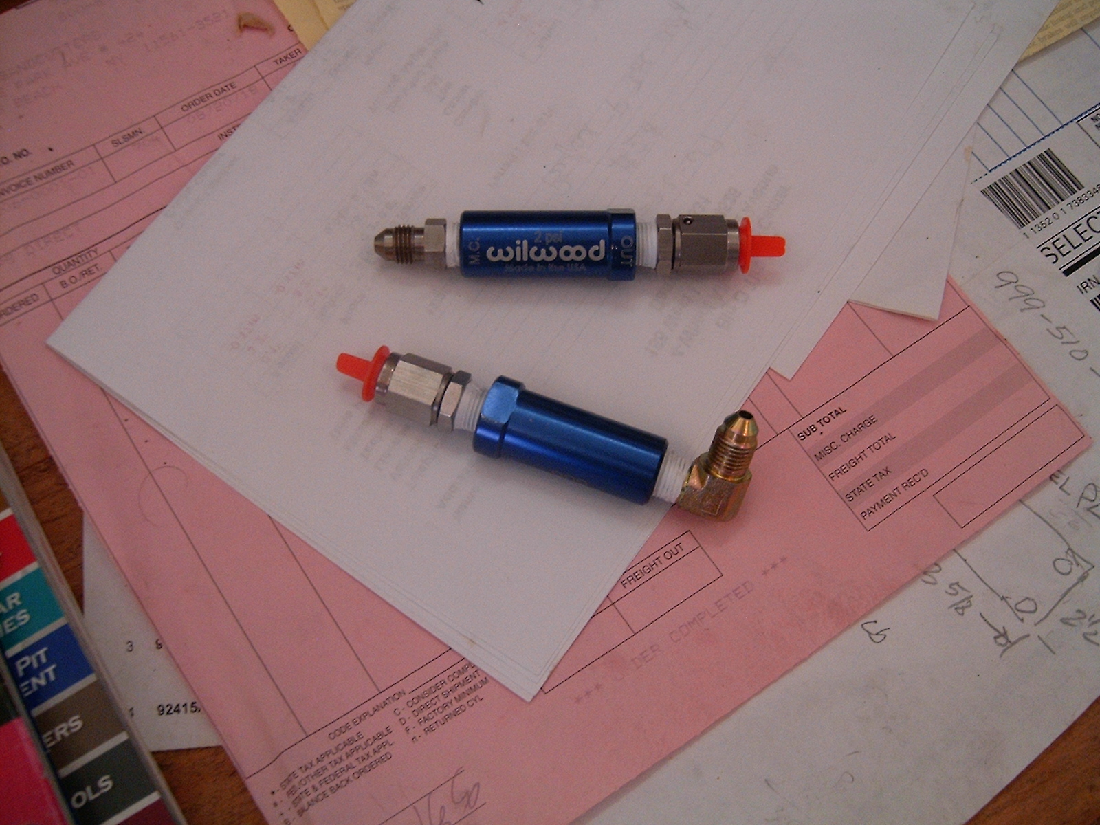

Is anybody aware of a way to incorporate a residual pressure valve between the MC and banjo fitting? My calipers are slightly higher than the MC, and are plumbed with soft lines and banjo fittings. Only way I can fit an in-line RPV is at the caliper, or, for the rear circuit, all the way at the back of the car next to the brake pressure sensor switch. If I could sandwich mount one between the MC and the banjo fitting, that would be the cleanest and most effective position I think.
had a further think on this - using remote reservoirs, mounted higher than the MC and calipers, should reduce or eliminate the issue, along with no fitting issues.
Howard Jones
Do it like this with two hoses and the RPV in between the MC and the bulkhead T that goes to the end of the car associated with the MC.
