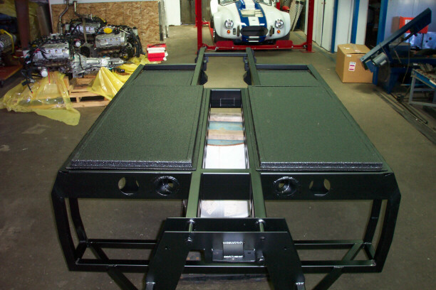

Progress of the giant - One Off Large GT40
Honnycomb panels. This will hold 4800 pounds where the driver sits

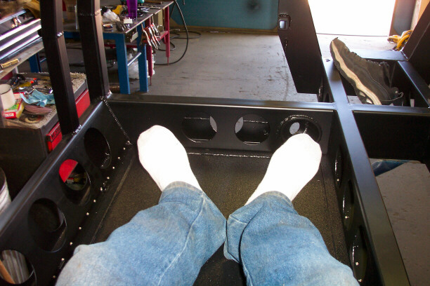

Re: Progres of the giant
foot room 11EEW

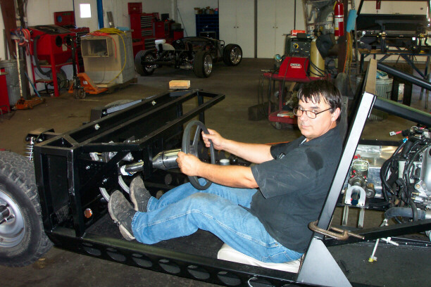

ajustbul peddels and colum

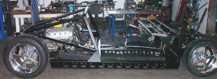

on wheels

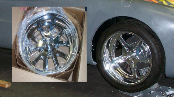

Right size wheels

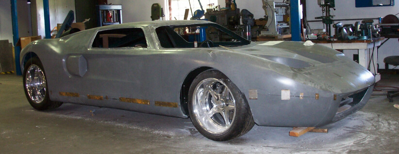

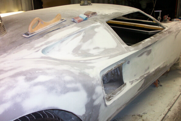

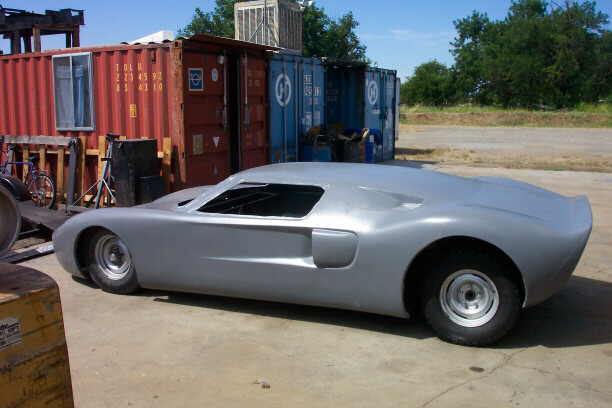

We keep cutting. Took a wedge starting at the rear wheel to the front wheel. And 1" out of the nose

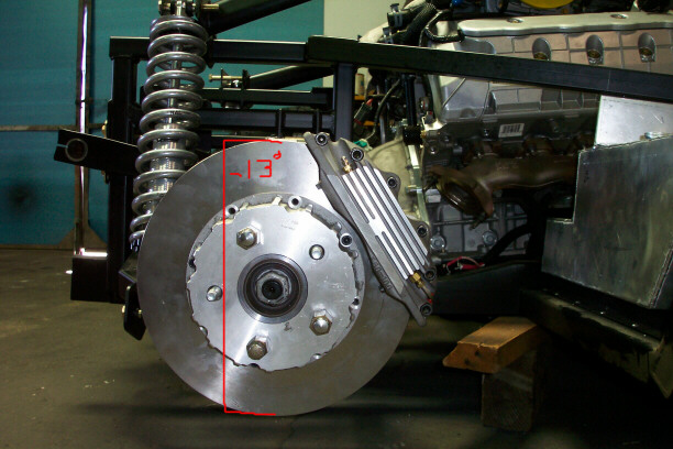

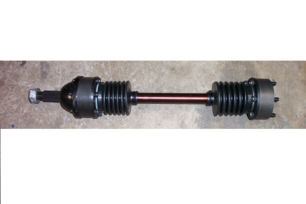

Dave Allen of McKenzies spent a few days with us and showed us how to properly set up an axle. This is a bigger setup than is in the Saleen that he also builds.

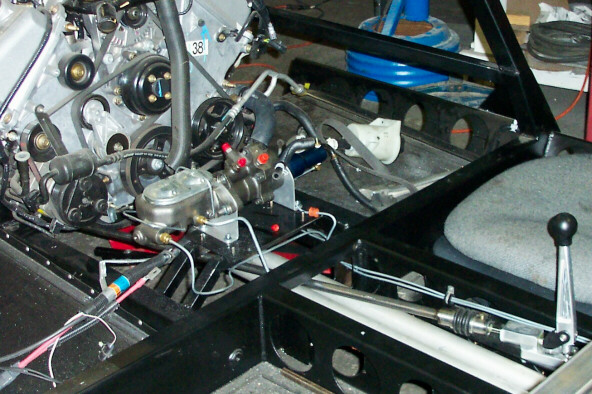

a hydra boost 25,000 psi

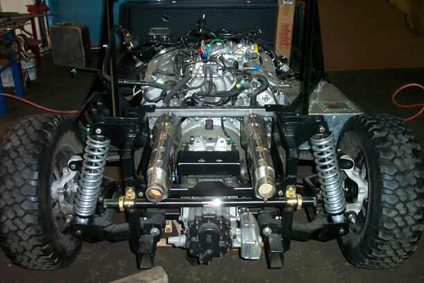

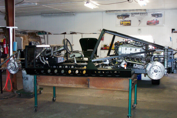

The motter shrunk

Drive train is complete and a custom set of wheels wiring and plumbing and it will be a runner

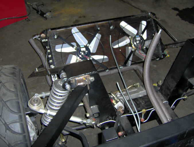

The fans above are 2950 CFM each and draw nine amps each they are 16". the radiator is 38"x 20" the condenser is 19"x 36"
