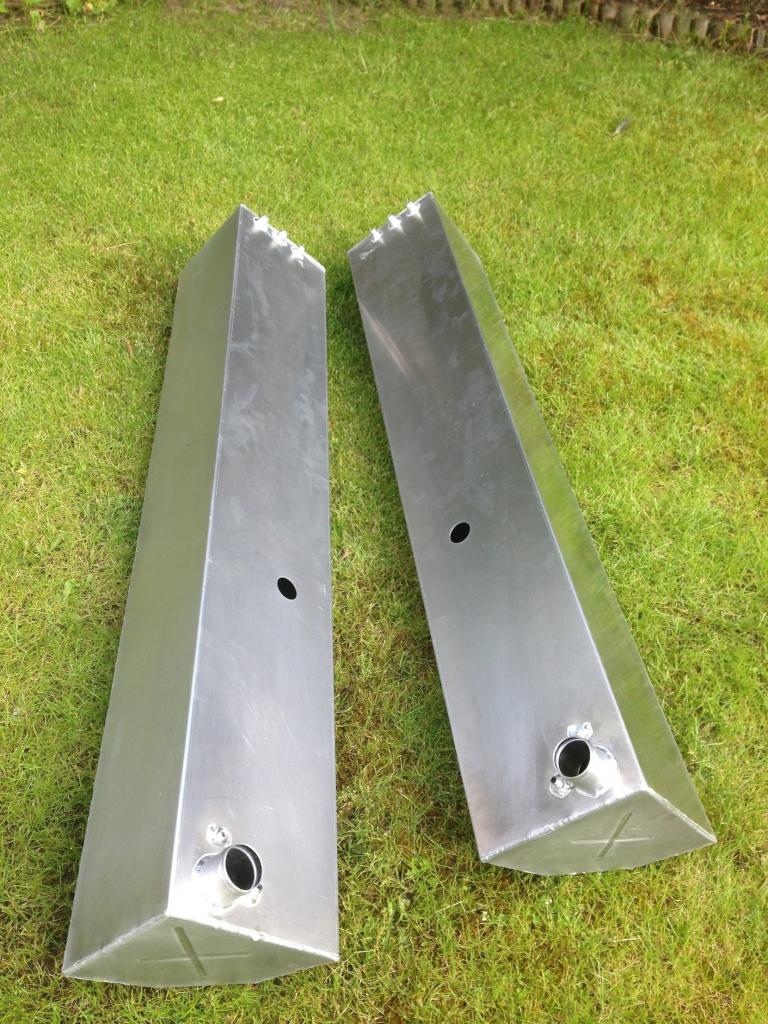

Just looking at this post from the outside as I am building a GT Forte along with a number of other enthusiasts in the UK. Tornado Tanks are currently listed before UK tax as £595 with baffles, £795 with Foam on their website. Looking at the threads, that £200 of foam looks expensive but I'm sure as most things are, there is more to it from all sides.
Looking at what can be achieved in the UK which seems a very expensive country to live in, I and 3 others drew up plans, some with injection, some without, and ordered our 8 Tanks from a UK fabricator. Mine were delivered Today with a total price less that the difference between with Foam / Baffles above.
In fact, two tanks with baffles and fittings to a design of our choice for less than my local country pub charges for 150 pints of Stella. (for those Stateside - insert Premium European Lager)
And that say England has no manufacturing Industry !
I have taken a good hard look at them Today - Fantastic Quality at a fair price.

I was considering foam for my tanks but after speaking to ATL tech support I decided to join the rest of the guys and not bother. Basically the guy at ATL said that with modern ethanol etc based fuels you should inspect frequently and change after a few years, ideally he said you should empty the tank as well, fine if you racing but no good if like me your cars primarily going to be used on the road. I did look into the Explosafe material but I phoned a really helpful guy who distributes the stuff and he said he didn't have enough at the time and he was struggling to get more stock as demand was high.
As Nick mentioned above, me, Dave, Nick and Andrew teamed up to get some made and a chap called Josh from JAF fabrication made us each a set from our design (Baffles and trap door). My set arrived today and I cant believe I got such a well made set of tanks for such good value, an engineer in the office walked past and commented on the good quality of the welds and fabrication. I'm well chuffed and I'm going to put them against the car tonight to see how they look :).
NickD

Graham, Ping me your personal email and I'll forward details. remember costs for us were extremely competitive as we had 4 sets made, also in the process of having our stainless Tank straps made also.
Thanks.
Nick.
