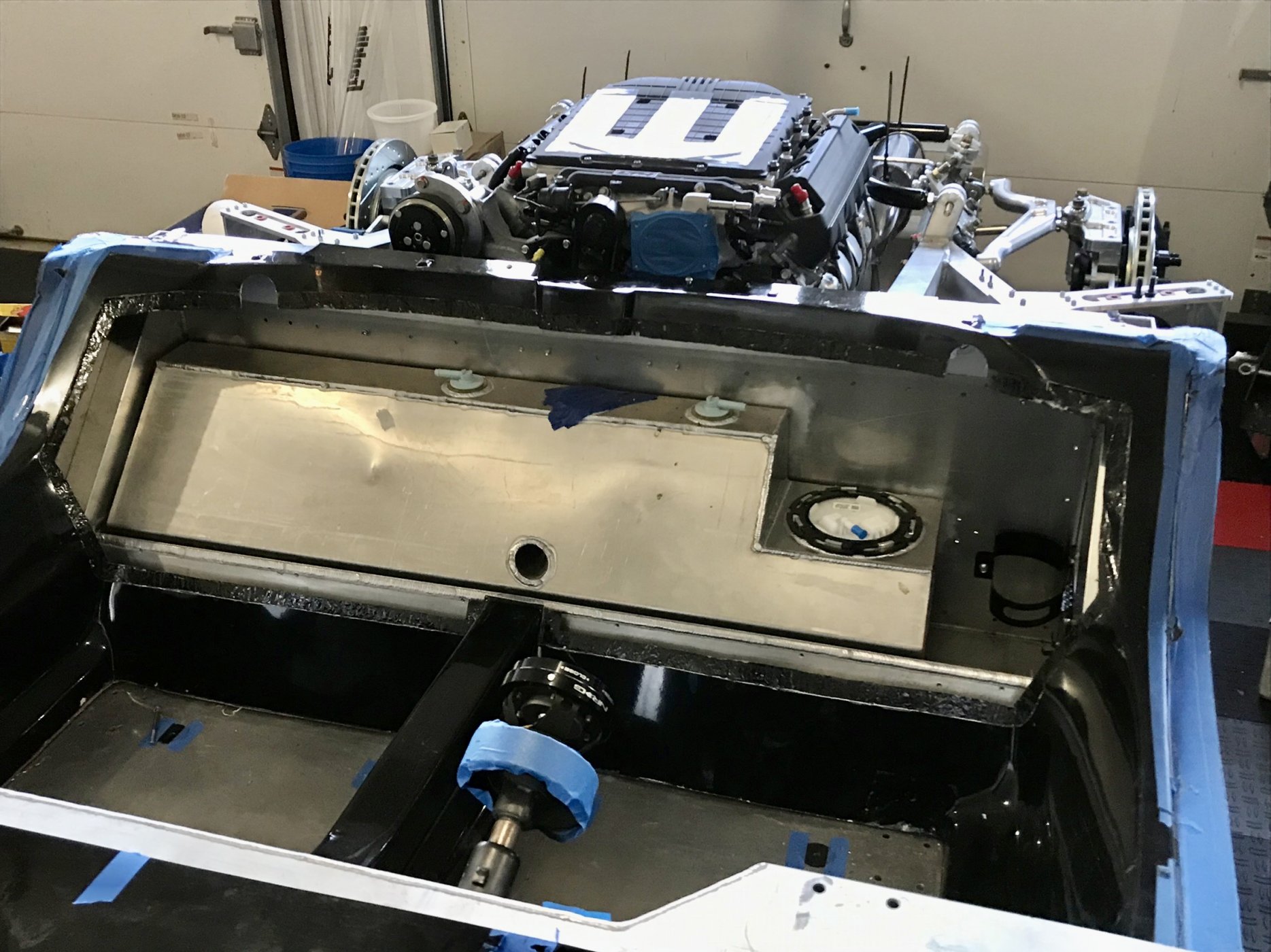

My most recent modification…
Scott
Joel, it's good that you can easily service the fuel sender. Note that your modification to the tank will change the custom calibration for the stock SL-C tank. I think you can send it to Centroid to have the calibration modified. Or you could remap the values elsewhere. In any event, you might want to sort that out before you install it.
Thanks Scott, I had Centroid re-program it for 0-5v so it works with the AIM PDM. They were really good about it and did it at no charge.
I am just curious about mounting it using the cork with no sealant and if that is really the best practice.
