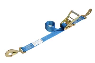

I agree with over tire tie downs. Further, I would get a set that has a bra of sorts over the tire to preclude it from jumping sideways or coming loose should the tire go down:
The one in the picture is made by Keeper; click image to see a listing for these. Although I am not necessarily recommending this particular brand, but these were the first pictures I found as examples.

I think all the ideas on this thread are good. If you do it a lot of towing and tying down though you won't wish to mess with the wheel straps as they take a good bit of time and while add safety, are not needed if you do a good job on your tie dows.
We use four straps, two in front and two in back, "Xed". Get some good quality straps, at a minimum the type pictured or better. You'll be paying at least $25 for two straps, if not more. If you aren't you are probably getting too "cheap" of a strap. Had lots of those, lots of broken straps as a result. Those blue ones from Summit are good, had mine two years and work great.
On the RCR I put axle straps over each lower control arm, then attached the tie down to that. Cinch up tight, drive a few miles as others mentioned, check, then drive to the moon if you like. (the pictures of my Lola are on my buddies trailer and he's got bad straps don't use ones like that. One broke on that trip although no damage was done since we caught it quickly. I'm ordering him some real tie downs). One you get it right it won't move and getting it right just take a bit of doing til you figure out what is what. Now that I know my cars, got good bits I place it once, strap it down, and it never moves.
