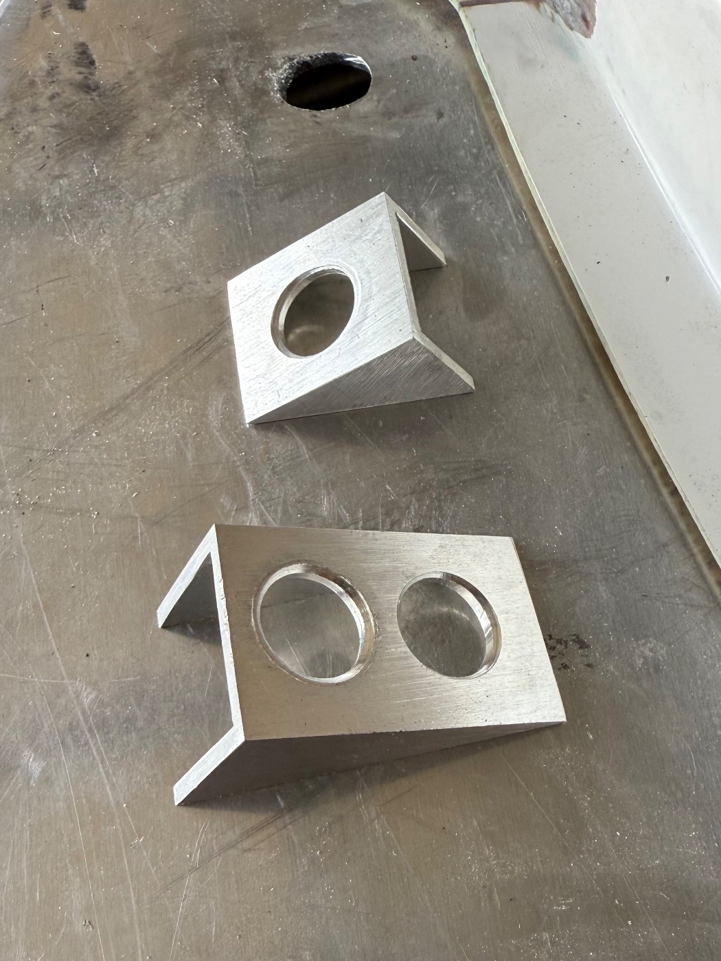

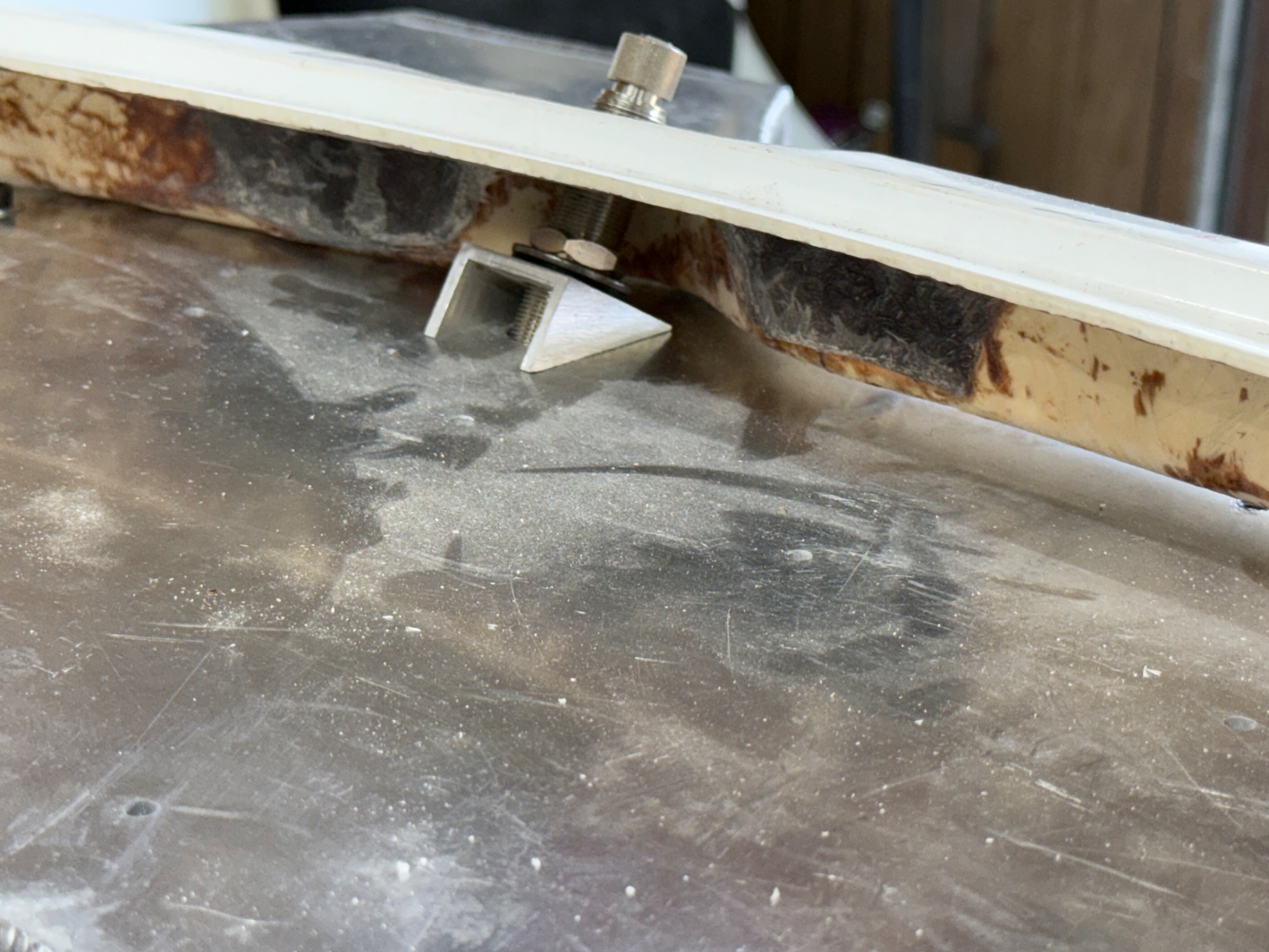

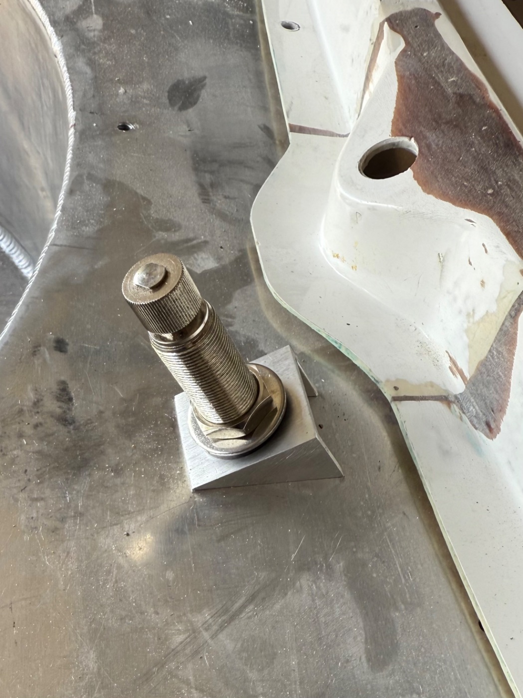

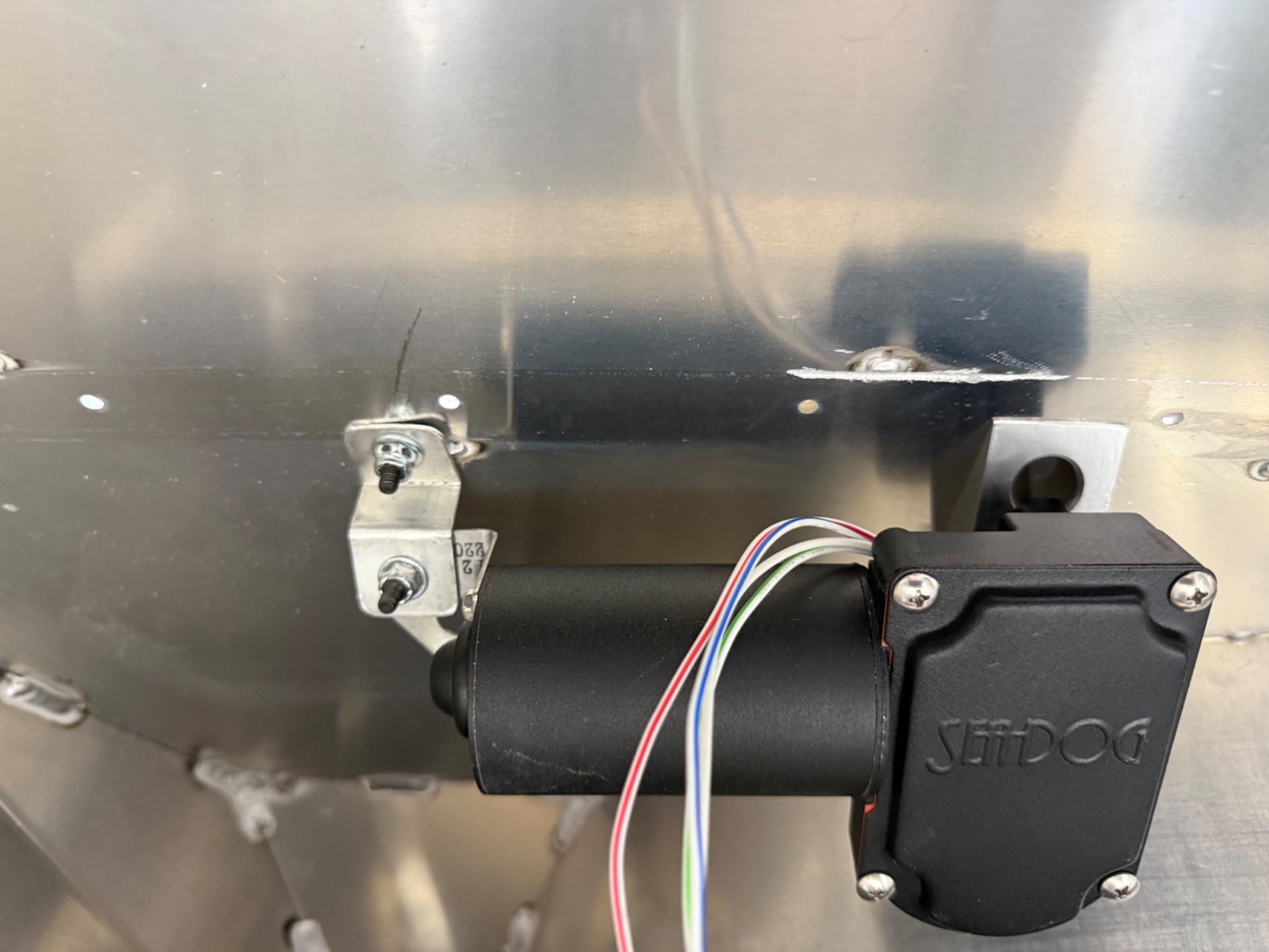

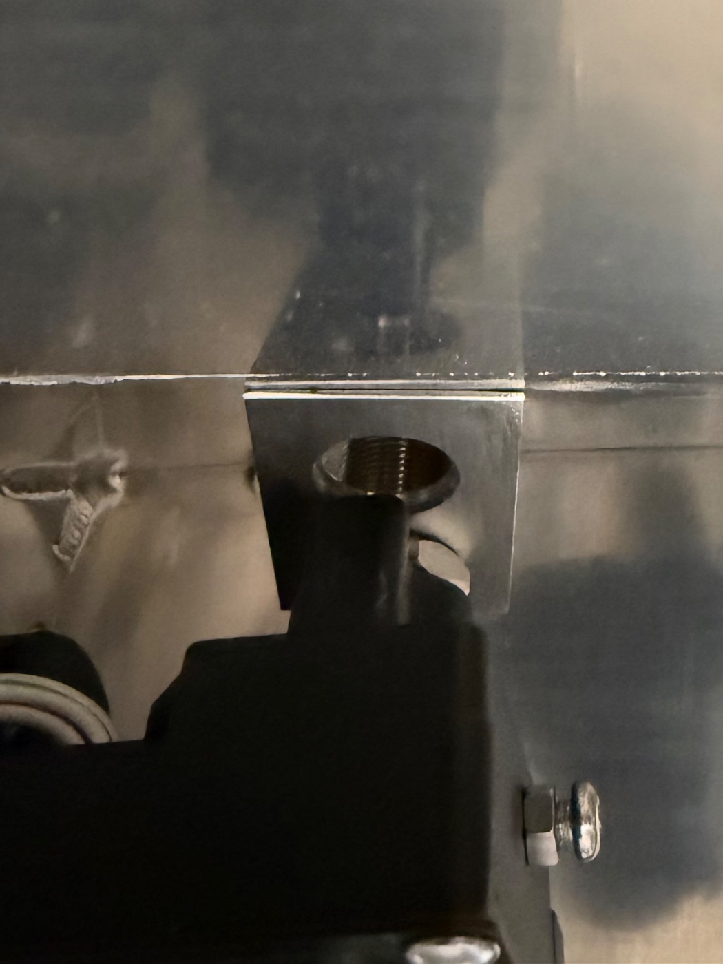

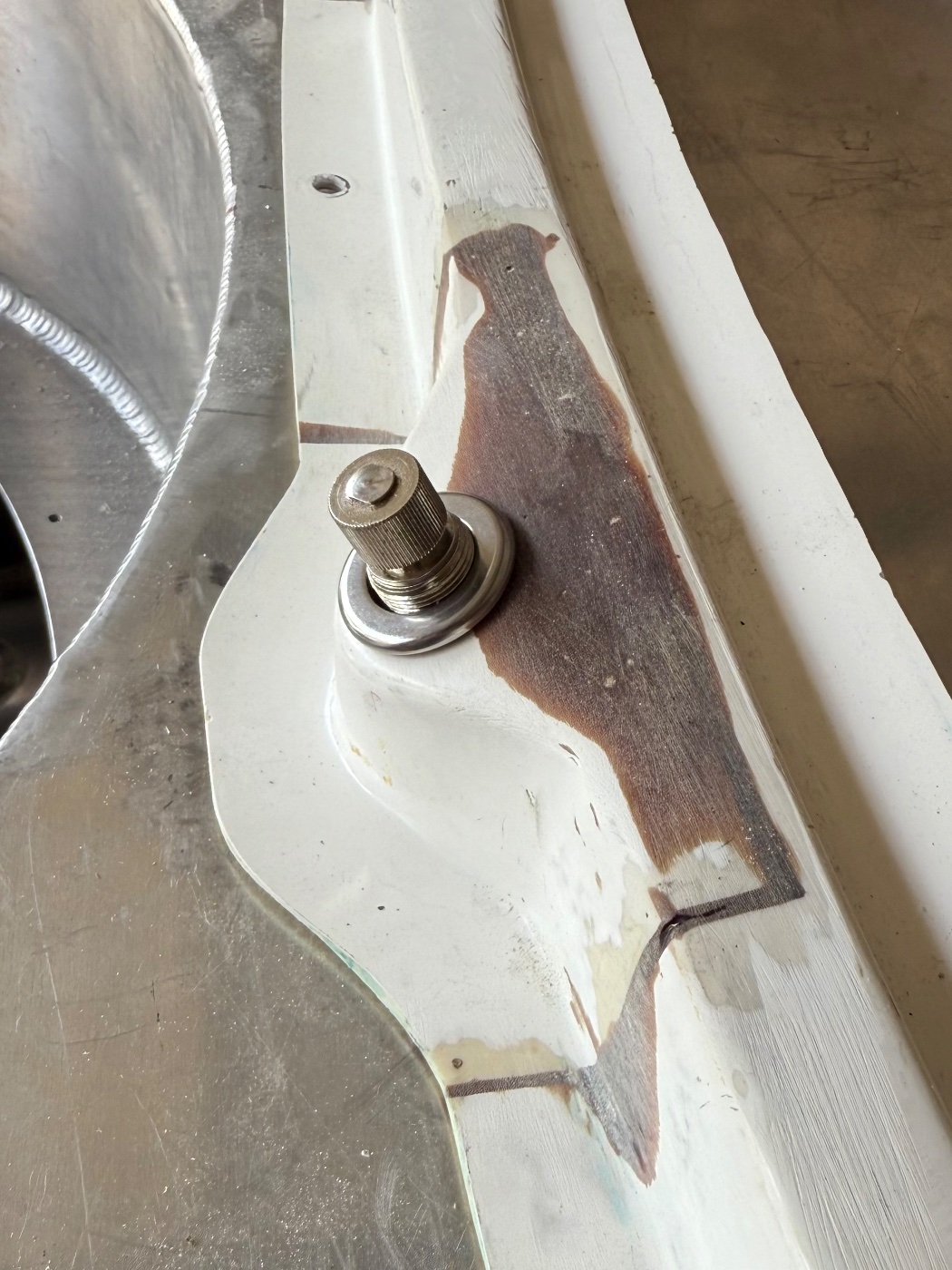

Jumping around in the build process. Decided i better install the wiper motor now before access is restricted by the dash.
First step was to verify that the shaft is 3-1/2”. I heard that some cars shipped with the shorter shaft version. Also, noted that the build manual is for a much different configuration so was of limited use.
I checked few cars in the parking lot to figure out the angle and height. I found that most have wiper shafts perpendicular to the windshield and the base of the wiper (bottom of the splines) is usually about 1/2” to 3/4” proud of the glass. My shaft angle measurement is 30 degrees.
I screwed down the spider and located a good spot on the spider’s bump for the hole. I used a 1/4” bit to drill down through the dash panel aluminum using an old 30/60/90 drafting triangle to eyeball the correct drill angle. I then used a step bit to enlarge the holes to 5/8”.
I made two 30 degree wedges with some scrap 1-1/4" x 1/8" aluminum 'C' channel. The lower one has two holes because I was planning on slotting it to allow for adjustment. Turned out the upper hole seems to be perfect.
Now I need to buy another nut. I am not going to rely on the fiberglass. Instead the shaft will be secured at the wedges. The nut and rubber washer that touches the fiberglass will be to prevent water leaks.
The last step was to fashion a bracket to hold the motor end of the unit. I bent some 1” x 1/16 aluminum strap in a Z. The tabs are about 1” and the center section is 1/2” long. Sorry, no pictures of the strap.

I too had to buy another nut for the wiper shaft as I wanted one on both sides of the fiberglass.

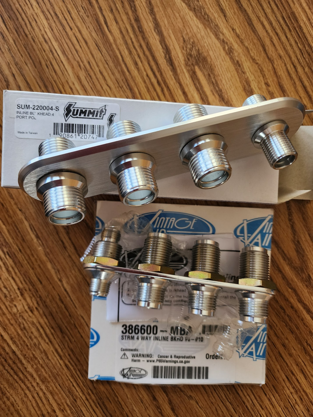

I am in Singapore until 11 Nov so I have plenty of time to contemplate next steps. I have most recently been thinking about the AC installation. Some ideas I hope to implement include.
  • Making it easy to remove the compressor from the engine so I can remove the engine without having to disconnect the AC lines. This should only require an extra foot of hose to provide some slack and a connector for the signal wire.
  • The compressor should be mounted with the ports to the high side, so going to use a March msnifold to redirect the ports to the side which should then allow me to use 90^ fittings to make it so the hoses can be run down between the compressor and timing chain cover.
  • I want to minimize stuff in the frunk so planning to mount the trinary switch to the drier and then mount the drier to the condenser. The horn will also be mounted in the area in front of the radiator.
  • Also in the frunk all the connections will be made with hard lines from the spine to the condenser and to the bulkhead.
  • I want the lines close to the floor so will raise the radiator a bit to run the lines underneath. The gap will be closed with 3/4” x 1/16” aluminum 90 degree attached to the front edge of the floor.
  • I want service ports on all three lines and to be readily accessible in the frunk.

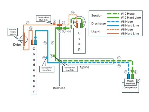

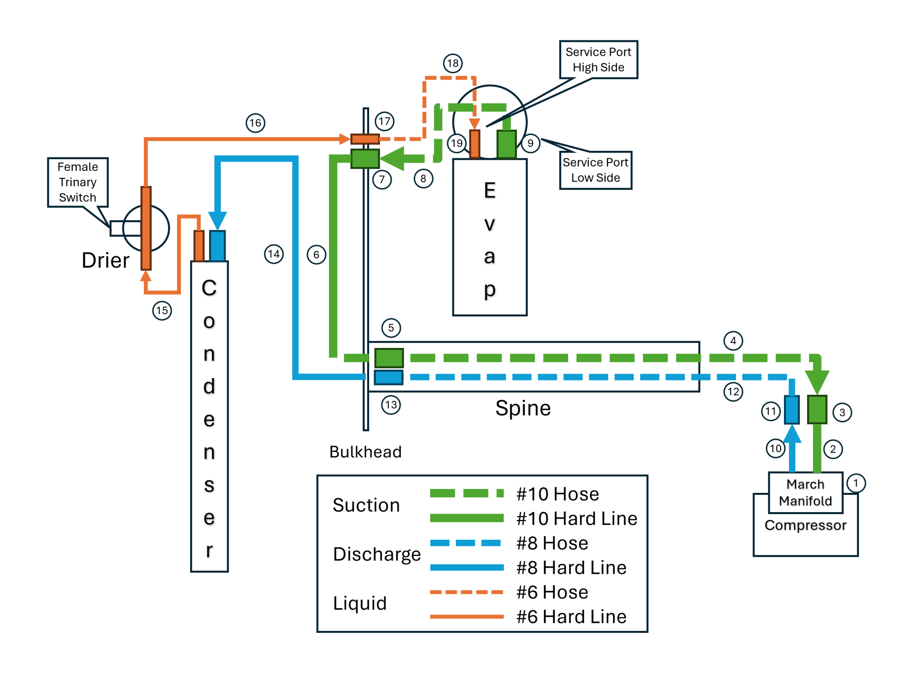

Randy Folsom

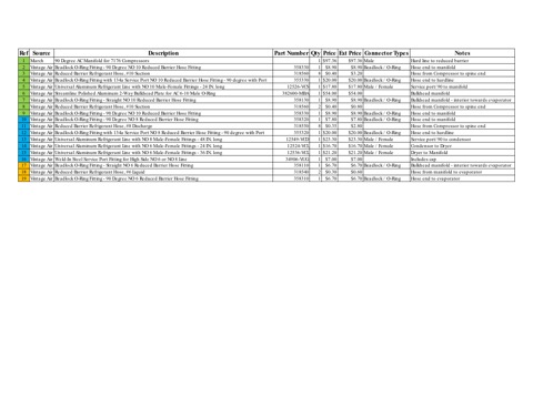

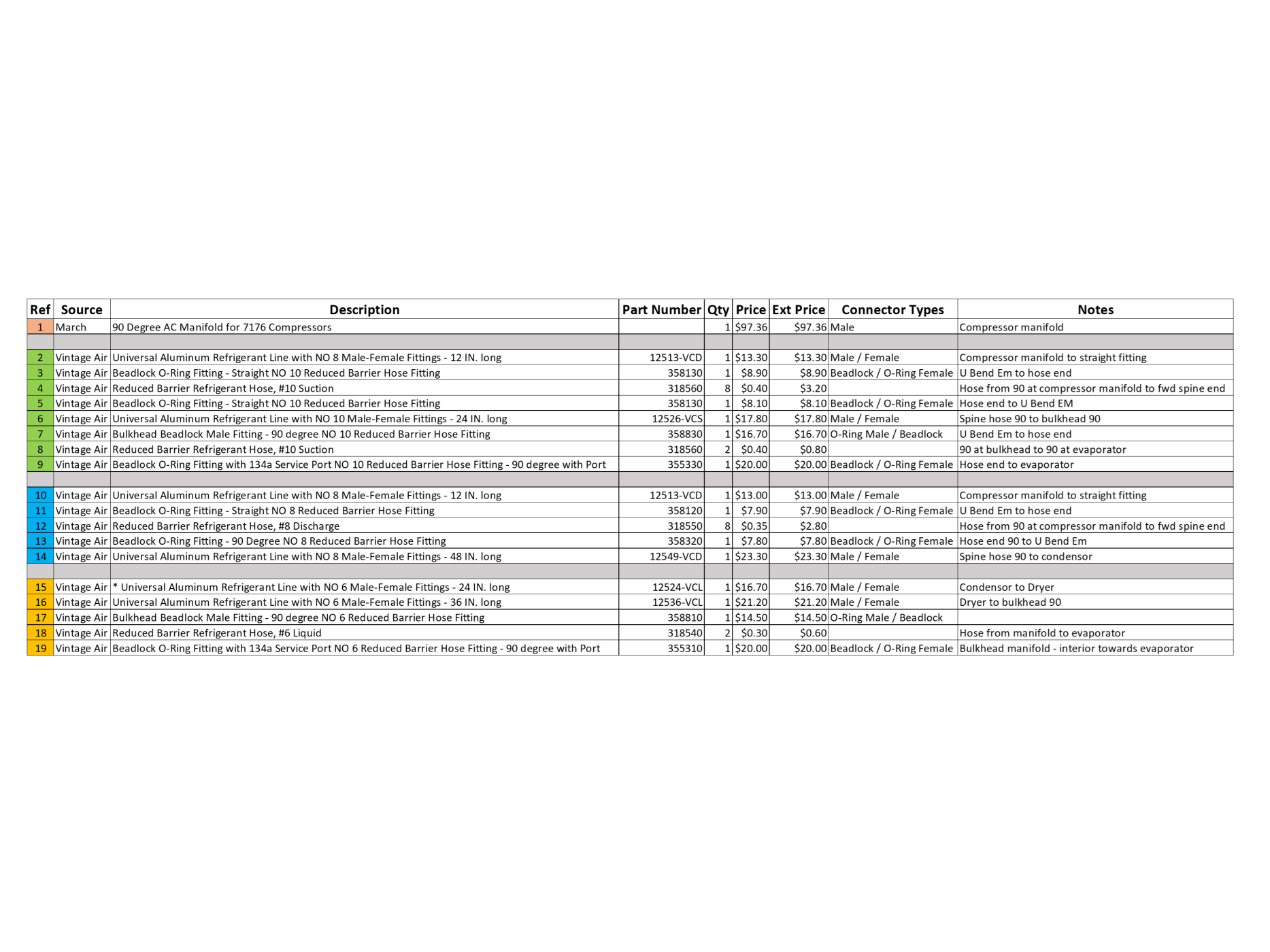

I think I have figured out the AC lines. Going for a minimalist look and trying to use as few connections as possible.
Only the hard lines will visible in the frunk. The fittings will be hidden in the spline, behind the bulkhead or in front of the radiator. The drier with the trinary switch will be mounted on the condenser out of view
The hard lines will be down on the floor on the far PS except where #8 and #10 exit the spine and where #6 and #10 enter the bulkhead. But even at these points the lines will be just a few inches from the floor.
The service ports will be at the evaporator. To make service easier there will be access holes in the back wall of the spare tire recess.
I have a solution for the engine bay as well. Formed hard lines from the March compressor manifold will loop down around the compressor body between the water pump and compressor. They will then bend towards the tub wall. The reduced barrier hose will go from the spine to the tub wall with enough slack to allow for removing the compressor without disconnecting any lines. Might add 45 or 90 degree hose spices to guide the exit from the spline.
The schematic and parts list have been updated.

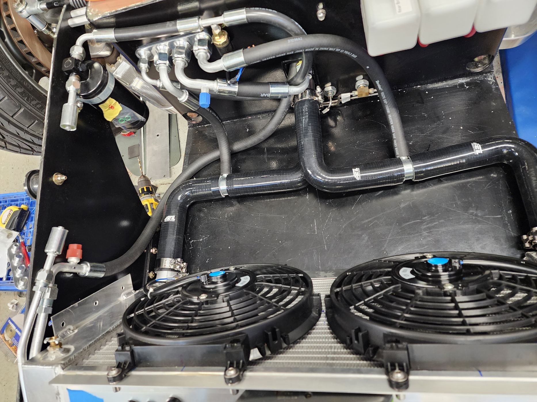

Randy Folsom
Thx for the manifold guidance. I see that both your radiator connections are on the bottom. Have you had any road experience with that setup yet?
Howard Jones
You might consider not using the heater at all. You'll never need it here in Texas. No really, you never use it in Texas. That will save a lot of room and complexity under the dash/ engine room. Also the heater core MAY make bleeding air out of the coolant system more difficult. Or you MAY need to add a bleed line from the heater core back to the header tank. I don't have a heater in my GT40 and have never needed one. California and Texas.
As far as hose types go I think I would just make or have made the usually rubber type with crimped on AC hose ends with the goal of as few fittings, feed throughs, bulkhead fittings as possible.. The leaks are always at the fittings/o-rings.
I would go thru the various panels with a hole and a rubber grommet. Simple and pretty much failure/leak proof. This way you can use one piece hoses as much as possible hoses.
Randy Folsom
Definitely not doing heat and I agree, less fitting is more reliable. But I do like the look of the hard lines in the frunk. I may end up doing all reduced barrier hose because it’s faster to install. I can always go back and install hard lines later.
David Garton

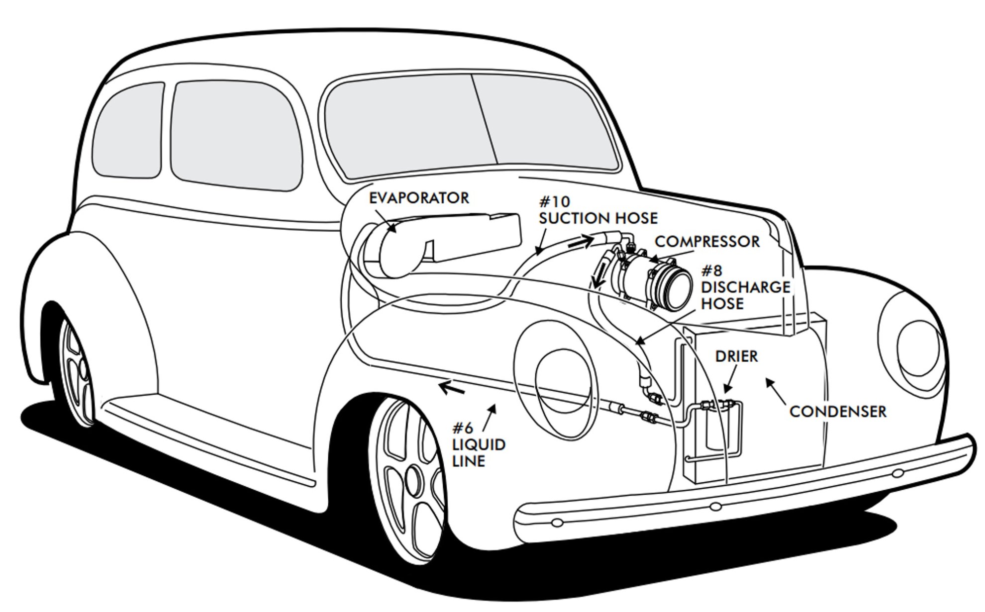

Randy, You will need an expansion valve added or an orffice tube to convert your liquid freon into gas. I didn't see it in your drawing. Nice plan though.
Randy Folsom
David, Thx much for the feedback. Not sure if you are referring to service ports. The Vintage Air kit doesn’t come with any other components. As far as I understand there are two options. With the Vintage Air kit as provided by RCR there are two 90 degree fittings with service ports intended for use at the compressor which are #8 and #10. But since I plan to run the lines between the compressor and water pump I am moving the service ports to the evaporator which are #6 and #10. 6 and 10 are supposed to be better. Cheers, Randy
Devin
Randy, I believe your expansion valve is probably located on the back of the evaporator unit where the hose connects are…at least mine is on this aftermarket one.
Randy Folsom
Wolfman, Thx much for the clarification. I didn’t see any mention of expansion valve in the instructions or diagrams provided by Vintage Air so it most likely is part of the evaporator package along with the motor, heater, etc. as you noted. Cheers, Randy

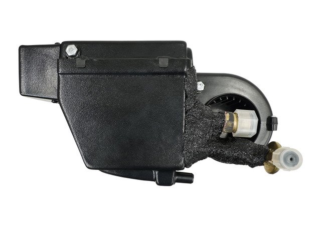

Howard Jones
Here is a cool only small size Vintage Air unit. The small lower right fitting is the high pressure (liquid AN-6 evaporator inlet) as labeled on the above drawing. You can see the gold disk attached to the back of it. That is the expansion valve. I kind of think that the expansion valves are factory installed by Vintage Air.
Randy Folsom
Thx. I am sure you are correct.
I wish the cool only units were available with top mounted outlets like the gen 2 mini. That would save a lot of space under the dash.
