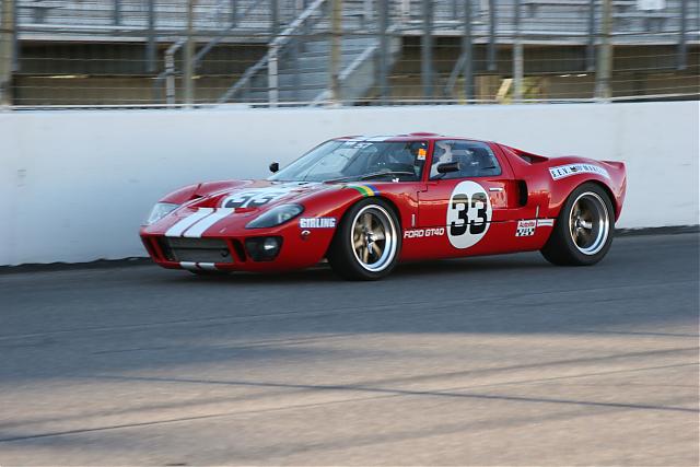

This is coming of the straight into turn 1. This is probably around 100mph turning very hard to the left. There were quite a few crashes in the this corner ranging from serious fiberglass damage to a hospitalized driver.

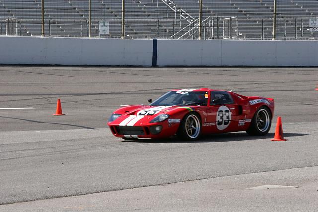

This is at WOT at 7000rpm's at 150+ mph

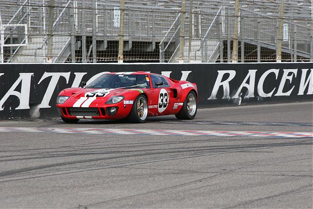

This is where you need to tap the brakes to set the nose for turn one. The car feels really stable and turns in very well, very mechanical.
The tire temps looked fantastic. Based on the temps I will say that the chassis set up is on the money. The tire pressure was around 37psi hot.
