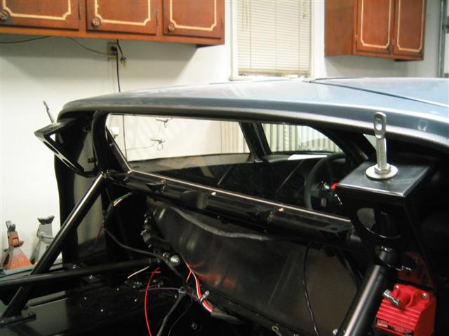

Rear window.

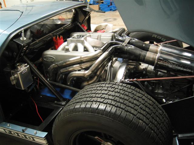

Here's a few pictures of my headers.I spent most of the weekend making them!I started Saturday morning with a big pile of pipes. I am leaving for SEMA in about 8 hours and wanted to get all of the tubes mocked up before I left. They still need to be fully welded.They are only tacked together now.
Keep in mind that this is the first set of headers I have made and will probably only be temporary.The Yates heads as well as the taller deck height made it quite a task!!!
I plan to have a set of 180deg pipes made up by a professional fabricator in the next few years. Until then,these will do great! One of the reasons I decided not to cross over the center tubes is that my Pantera has a kick ass set of 180s on it and I didn't want the two cars to sound the same.( not that they would anyway with the GT40 making an extra 250hp!!!!! ;) )

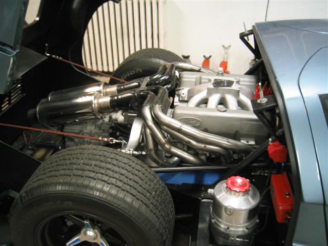

Here's another one.
The brackets welded to them are only temporary .Until I get then fully welded. Then they will be ceramic coated.

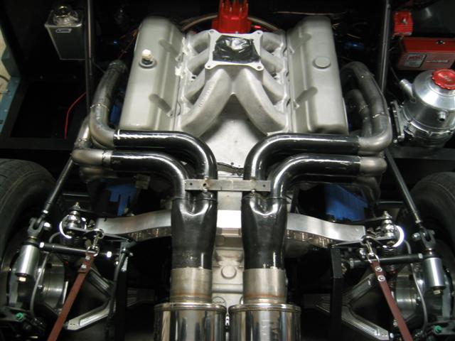

Last for now. I have a bunch of progress pictures I need to post but haven't had time lately. I was just pretty excited about these. This was one of the most dreaded parts of the build for me.
