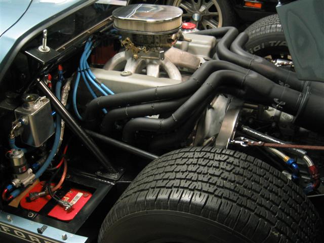

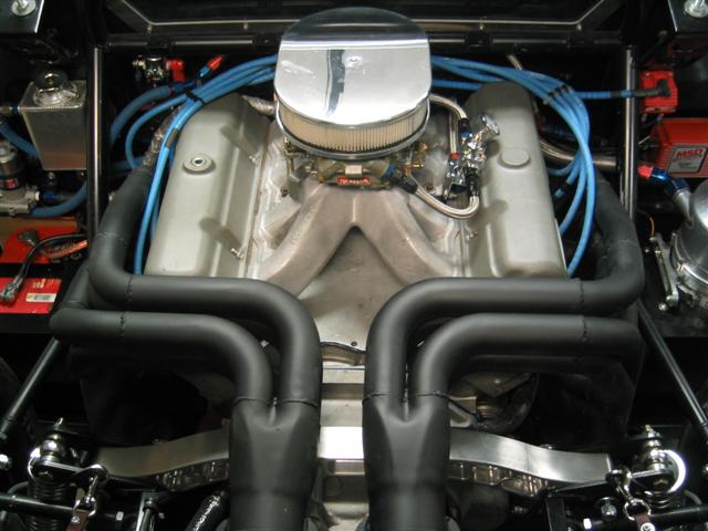

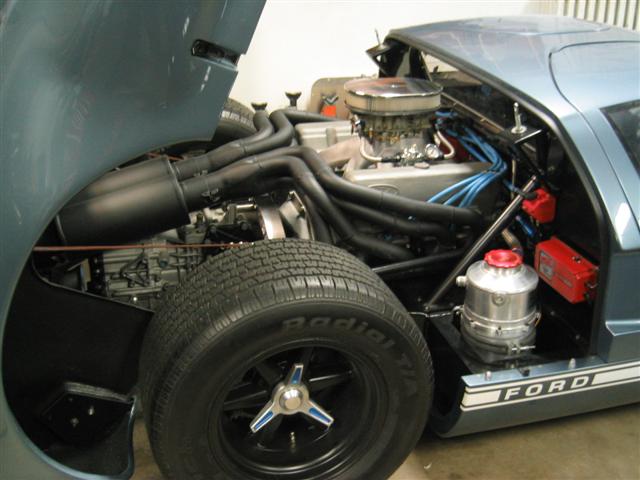

I finally fired the GT40 ! It has taken nearly a year but it is finally running .
I would like to thank everyone who has helped me along the way.I would also
like to thank my wife for putting up with my addiction.
