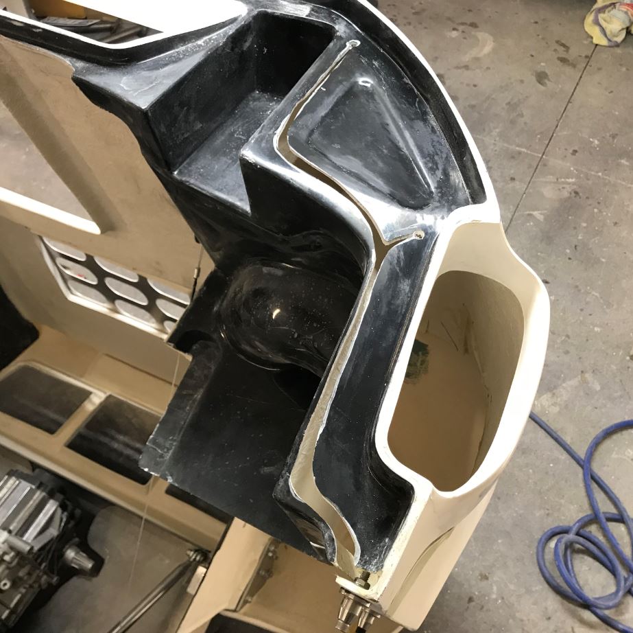

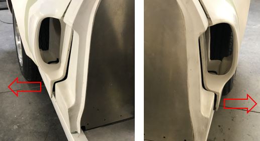

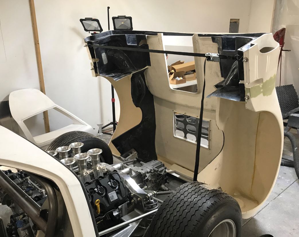

Has anyone had issues with the rear clip width of a RCR40? Mine is about 1 ½” wider than the rockers where they meet. I have the alignment pins in place, but the body is too stiff to force it back into position. I started relieving the inner structure to allow more compliance but so far haven’t cut out enough to make a difference.

If the rocker panels are set properly to the width of the front clip then your rear clamshell probably widened when the fender extensions were installed. There is also the possibility the part wasn’t constructed properly from the Canadian supplier rcr uses.
Adam
Additionally, the rocker placement both width and longitudinal position are very important. It’s possible match to the rocker width to the “toes” of the front clip but have one were they are sucked in. So narrow in front and wide in the rear.

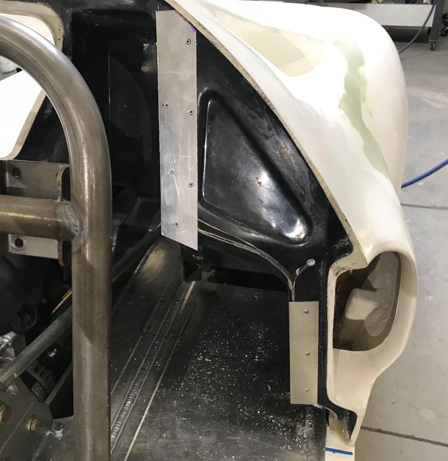

I have had this problem on at least three cars and they were not all rcr. If the inner clam assembly is not installed correctly [bonded/glassed in ] it will be off. The clam is very flexible with out it in place. I think you know the answer. brake the bond of the inner piece flex the outer clam for best possible fit and then we re-glass the inner back in place. I like to use 2'' strips of aluminum cleco's to hold it in place for alignment and then bond it good luck................m

This. Exactly this. I don't have the rear bulkhead glued in on mine yet and it is easy enough to get the rear clip to lozenge from side to side. As soon as you glue the rear bulkhead in the clip, it sets that lozenge shape/rear clip width in place and then it makes it hard to adjust anything. I am waiting until i have my body all mounted up before i glue the rear bulkhead in the rear clip. Note that this is a construction process issue, and has nothing to do with the accuracy of the molds. You could clamp the bulkhead in one body and get it lined up spot on and then in the very next body clamp it in on an angle and have it all off and need to do lots of adjustment. Even though both bodies came out of the same molds.
Have a look at the thickness of the leading edge of the rear clip. its quite thick. Most of that could be an glue of some sort between the inner bulkhead panel and the outer part of the rear clip. That gives you some indication as to how much free space there is between the inner and outer panels.

Spot on. The rear bulkhead and the Windscreen must be in place and at least temporarily anchored into position before mounting the rear and front clips. on my RCR 40 (#45), I spent weeks on this. Basically, you have to determine where your compromises are going to be and how you can mitigate them in terms of esthetics.
