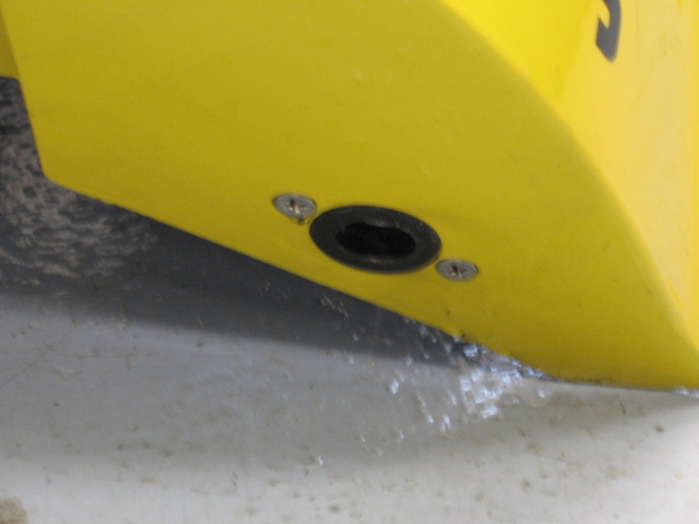

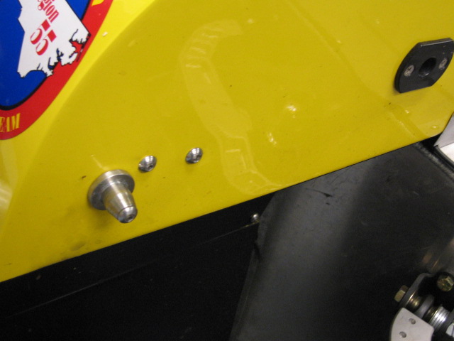

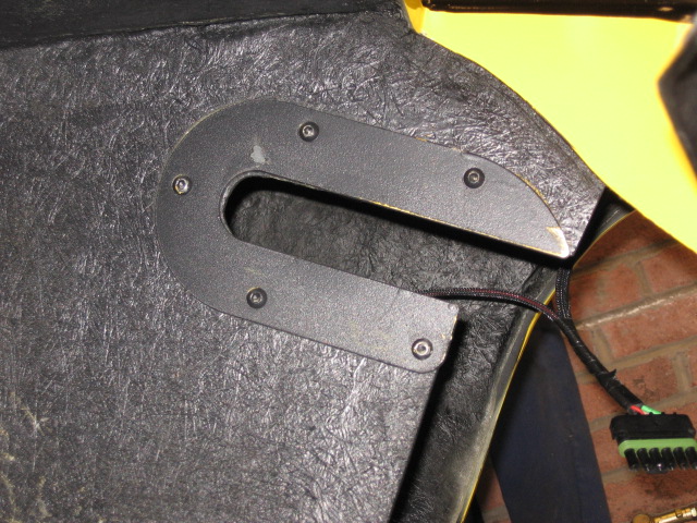

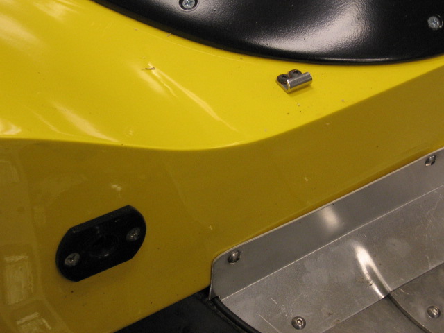

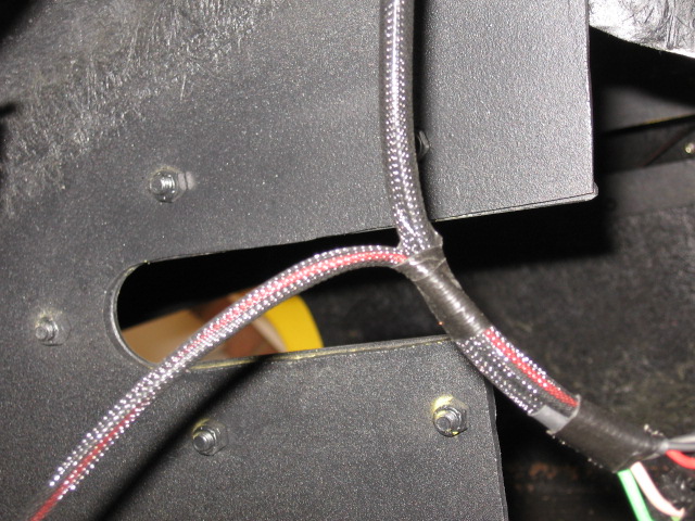

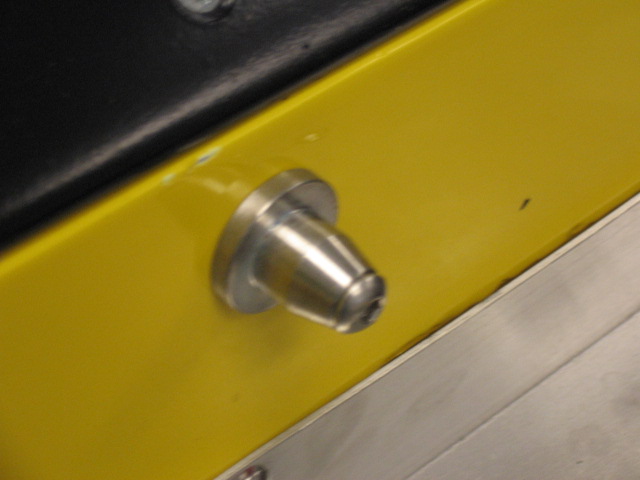

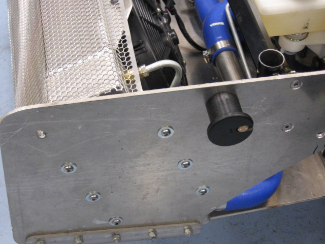

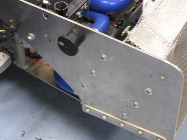

Hey Chris,
Here is how the front clip is attached and it works extremely well.
The major alignment and weight of the clip is borne by the plastic biscuits mounted there on the ally pieces forming the front scuttle. The biscuits mate with cutouts in the clip that are beefed up with 1/4" derlin (or some sort of polymer).
The clip also plugs into the rest of the car using a male/female pin system. I've shot some pictures of that too. Then two clips snug the clip up but with the three pins and the two biscuits it is located very well and the clips do nothing but provide a bit of force to keep them from coming apart.
Hope these help.
