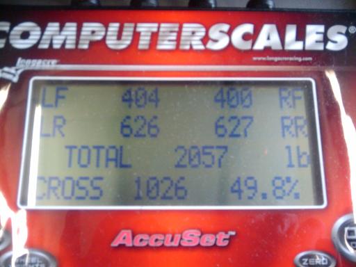

The team finally broke down and bought some scales for the 2010 racing season. First thing I did was weight the T70 Spyder and it is pretty light. Now, before I put out the weight rememeber this thing has a full SCCA legal roll cage that is overbuilt, two 10 lbs fire extingushers plus one hand held extingusher (I am scairt of fire), iron block, 11 gallons of gas, 930 transaxle, STEEL wheels at 22 lbs each, full road lighting, eleven gauges, two MSD boxes, and some other redundant stuff.
Weight - 2094 lbs as it sits.
I was expecting around 2300 lbs as the bodywork is not the light weight option and we have a lot of stuff in there.
We have not adjusted cross weights yet but things look pretty good for a base:
459 481
577 579
Easily done. F/R is 45% 55%, not too bad out of the box.
I think this thing is going to put some serious hurt on a track.

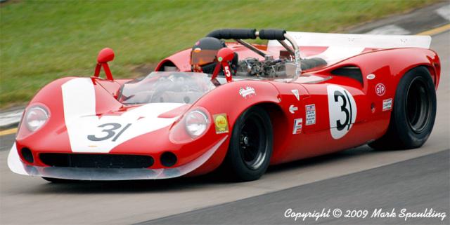

The original Lola T70 weighed (dry)1625 with Chevy and 1580 with Ford....
We added 175 lbs for driver and filled the tank 1/2 full (100 lbs).
The car has a dry sump oil system that adds another 30 lbs and a 20 lb fire system.
The alternator and coolant add another 50 lbs.
We also added door bars that weigh 15 lbs each and headlights that weigh 8 lbs.
This adds to 2038 so I have 19 lbs unaccounted for ! It is probably paint because the cars were delivered in gelcoat.

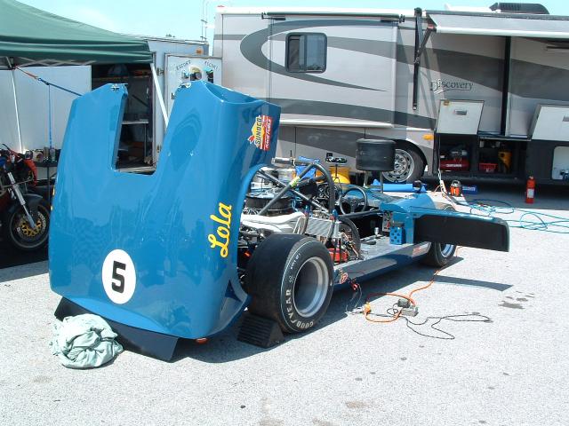

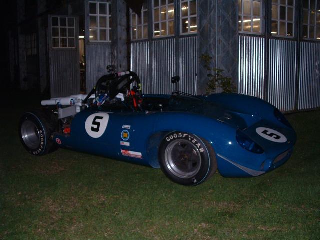

Hey Johan,
I like those mirrors, great picture! Are those fabbed up by the Lola crew for the T70s?
Now you know dry weights are like someone telling you cup size in a Wonderbra. I looks like we're not doing too badly then it would seem. We've probably got heavier wheels than you guys, our chassis is surely heavier, and we've definitely got lot more cage. We're still wet sump though, so a bit lighter in that respect.
1/2 tank is 100lbs for your car, what size cell does it have? With gas coming in at 6.6 lbs per gallon seem you'd have a 30 gallon cell - that is nice. We can only do 25 gallon max and even then I don't think I'd call that all usable, probably only 22-23 usable. Sort of like flying, I know my fuel load out is 24.5 gallons but I'll be damned if I'll try and fly all of that. 19 lbs unaccounted for huh? Lucas smoke or English ghosts?

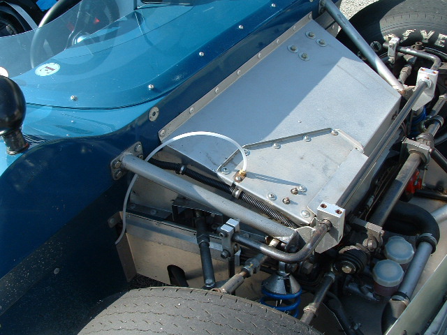

Ron it holds close to 30 gallons per side but only the left side has a bladder. For a short race like 1/2 hour we run 15 gallons and burn almost 10. It gets around 4.5mpg at 100 mph average speed.
The mirrors are the original mirrors and are a bit crusty with the lenses siliconed in place so they are no longer adjustable but the good news is that they do not slip out of place while driving.

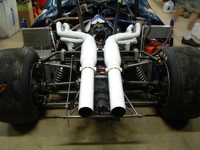

I feel that we got the rear of the car very close. We have the caster adjusted well, toe was good, about 1/16th in if I recall, and camber was a little much at -1.6 degrees. Tire temps showed we need less camber in the rear. Toe change just about non-existent in the rear over a few inches of travel so I don't think that will be a problem.
Again, I'll get the specs but our rear felt very planted and hooked up. I did spin it giving in the boot in a tight low speed corner as I got cocky with the feeling. Still, it was good overall and in the high speed corners the rear was solid, and gave confidence.
Now the front, well, that is a different story and we know we have a lot of setup tuning to do there.

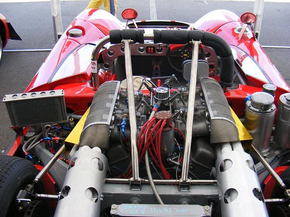

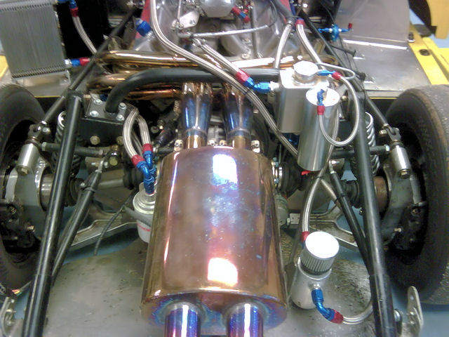

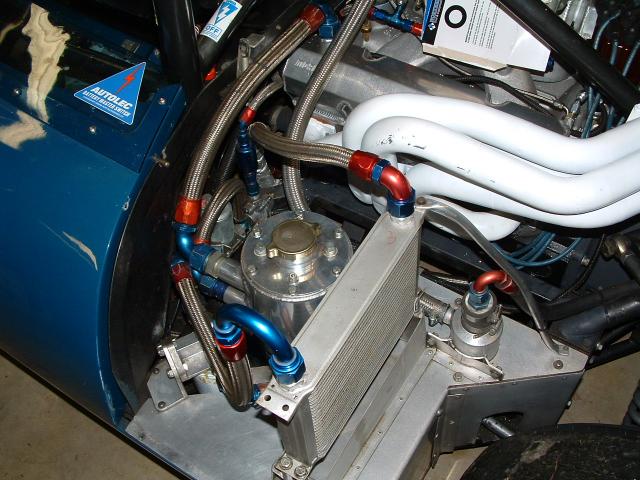

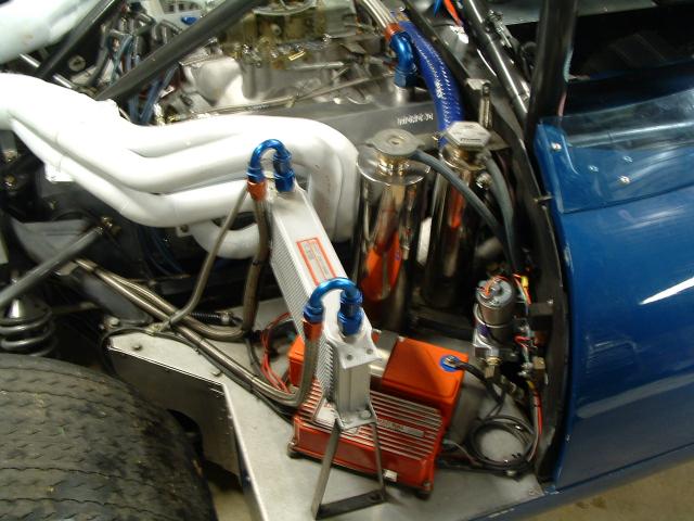

There are similarities and differences in the rear end pictures of the RCR T70 in comparison with the Lola you have. I do notice one thing right away that I have to do - get that engine oil cooler elevated so it can take advantage of the air flow. Does your rear clip have any ducting around the intake to further help air hit the cooler? Does your engine run a magneto ignition?
Ron - Where is the sending unit for the oil temp? If in the pan is it close to the top of the oil level?
