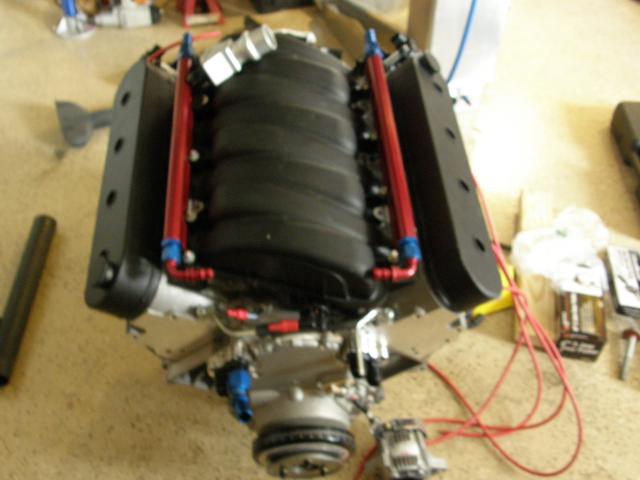

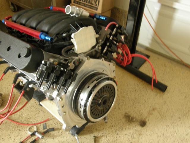

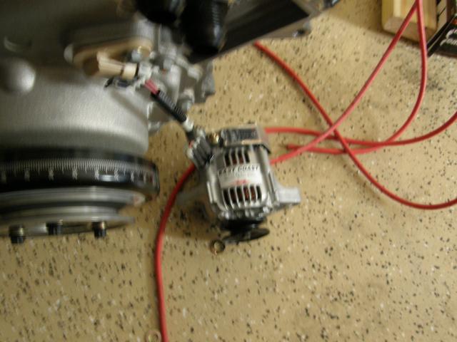

The heat is finally let up enough to hit the garage again. Ordered some more cool stuff. ATI super damper for the motor and a East Coast mini alternator. that will whittle down the need to cut up the chassis to fit the alt down in the basement. Clutch is on with a little anxiety. I also got some switch panels for the dash. I think I will finish clear coating it before I think about cutting more holes. May just mount center and below dash. Decided to make the whole dash removable so need to trim the corners up and do aluminum panels.
I know I know Pictures Pictures. I ordered an number of xD cards for my camera since some genius can't find the one he pulled the last time he took pics. I promise more pics as soon as they come in.
1. Smaller size high amp alternator 125 amp prefer, hoping half the size of standard unit. I have chrome new one with the 7 rib I can trade+ or just let me know what you have used. I am putting a 31t DeepCycle battery up front. weight balance.
Deep cycle batteries are what you use on your yacht or RV for the radio,tv etc not so good at starting engines.
marc
I cooled down so I ventured back into the garage.
Here is some of the stuff I found.

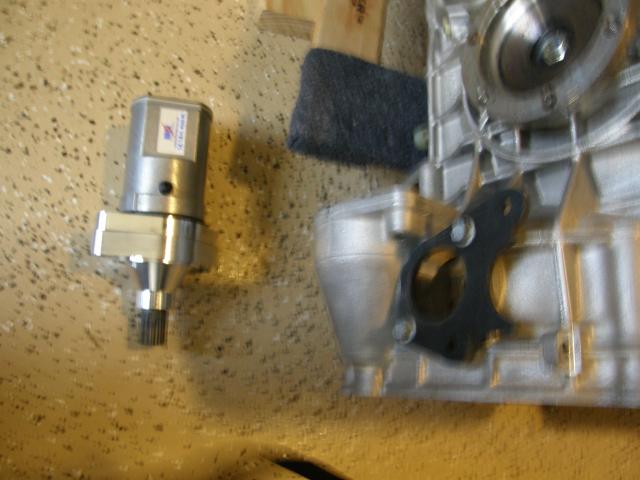

Tom set me up with a hi torq starter with some nice machining work. looks like that will be a winner.

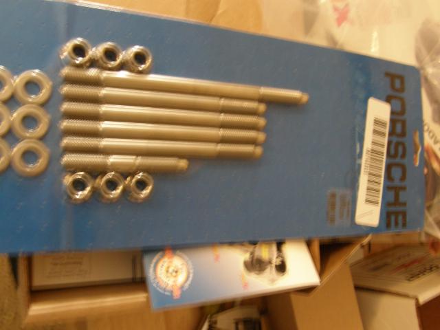

I found ARP makes a porsche bolt kit for the G50 motor preliminary measurements look good.
The LS 7 liked the new ATI Super Damper and pulley to spin the micro alternator.
I also mounted a coil relocation kit to give it a more period correct look.
I like it.

I'm using the same coil brackets and ATI Damper on my LS7 as well. Not for the period look, more to better see my CF valve covers though.

The damper is race required and I don't need the multi rib belt for just a alt. with the P4 this allows me to not cut up the chassis to fit the motor in as with a larger alt. I had planned on the large battery to make up the power needs for all of the required fans, pumps, efi and the like.
love your SLC nice motor setup.
